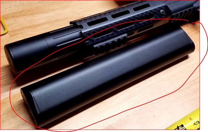

Jack makes a nice shroud; purchased 2 from him but he wasn’t able to assist me with the 600mm shroud so I adapted one of my FX shrouds and it fits perfectly. I use the FX shroud with the carbon fiber hand guard and the Huma Mod50; sound is backyard friendly.
I can’t wait to see how the Behemoth does in comparison to my adaptation. I really liked that the behemoth came with multiple length shrouds. So for someone that has multiple barrel lengths you can purchase one behemoth and multiple shrouds and be set.
