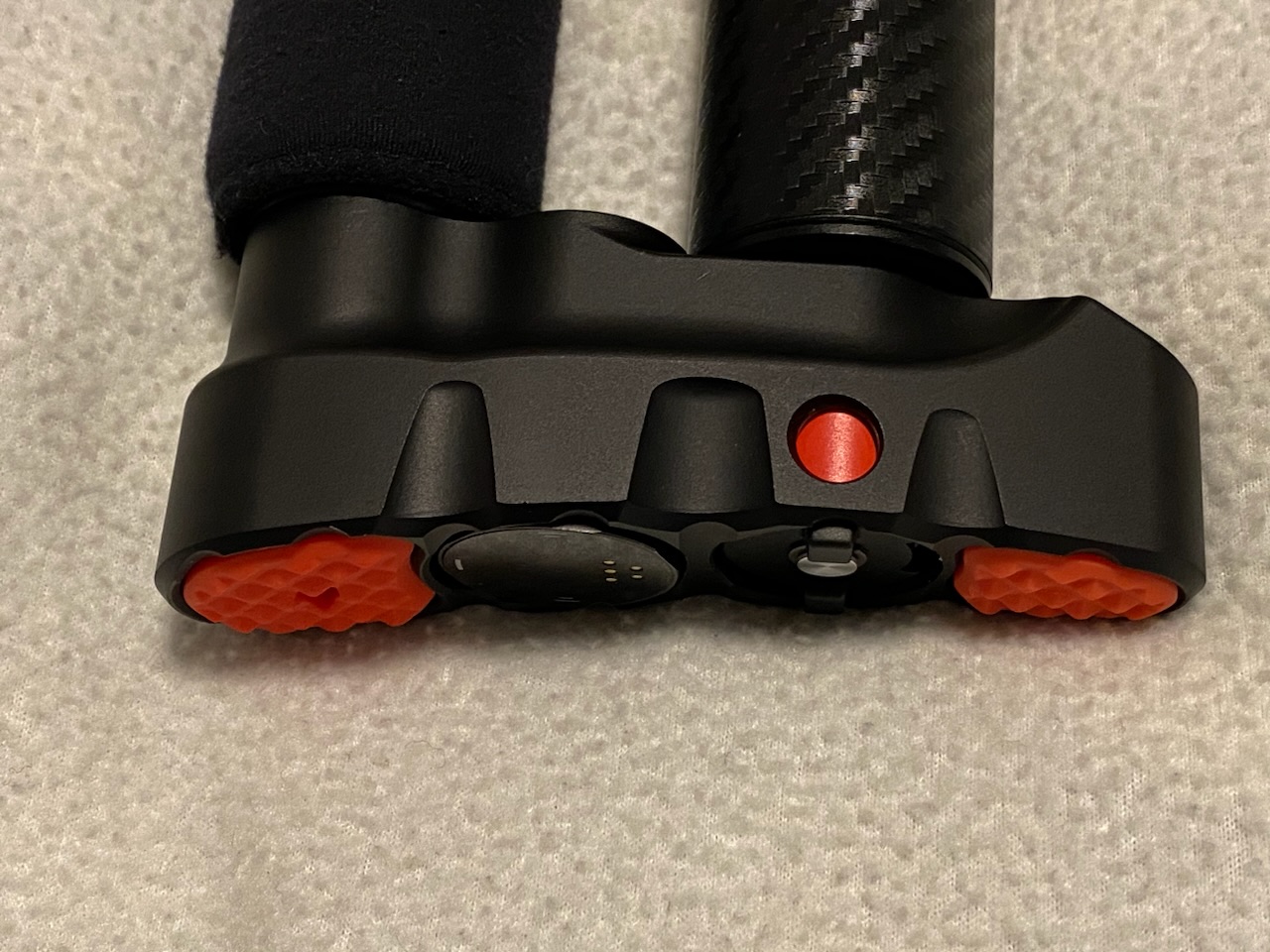

IMO, the Sekhmet or Edgun EDMU is a better option because some the digital gauge have the battery installed from the side of the gauge body. I have both on my L2. The Sekhmet as the main and EDMU for the regulator. When considering a digital gauge for the L2, do you want to have to take the gauge out of the L2 each time you are replacing the battery? Remember the L2 has the main gauge installed inside the back stock, can’t get to the side of the gauge without removing the gauge out completely. The Sekhmet can be recharged on the face of the gauge. The Edgun EDMU (Gen 2) can have the gauge cover removed to replace the battery without removing the gauge out of the L2. I’m a big fan of digital gauges and I have many of them. Lol. I have them on just about every PCP I own. The Sekhmet does not that far out of the L2. See attached photo.

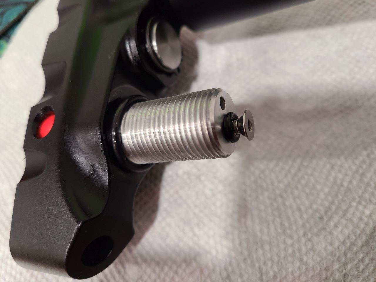

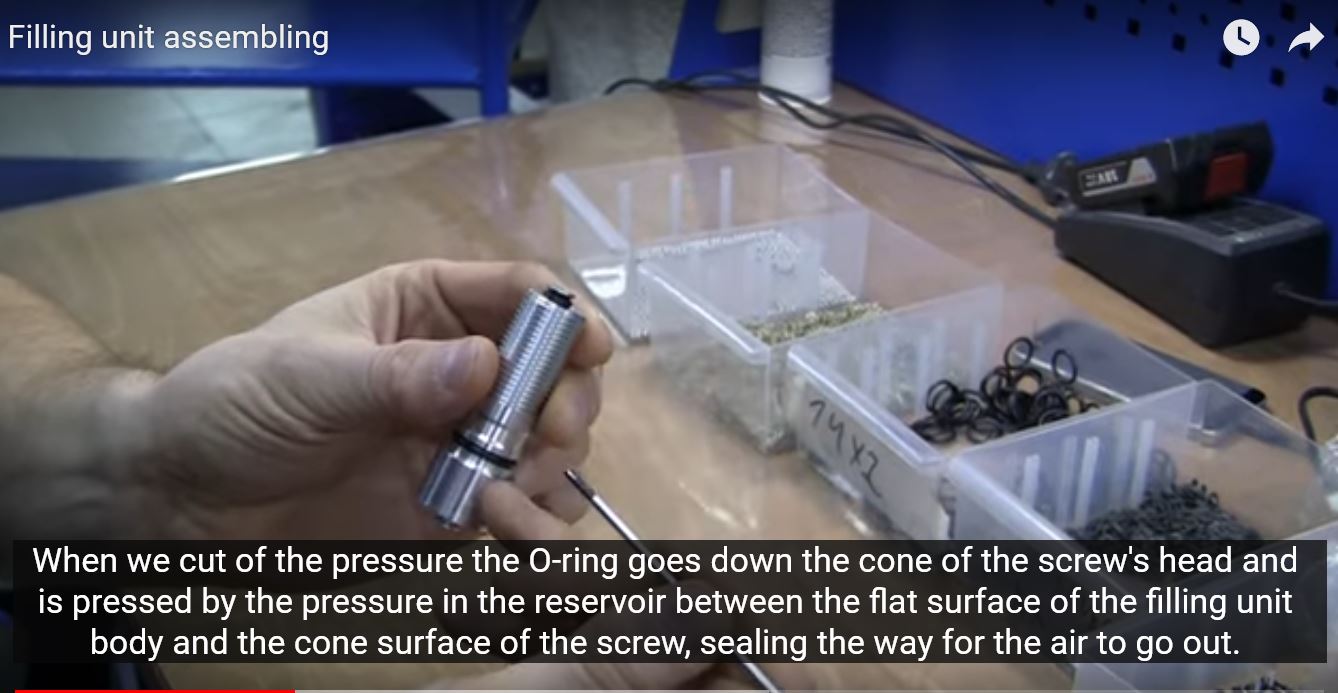

Is this screw a "check valve" for the bottle fill port?
With a cold weather I received also some issues=leaks when topping up the bottle with an EazyFill - outside in the field.
Today I had some time to tinker and removed all the orings in the power side, washed the parts with IPA and put back new and lubed orings. I was looking into that screw could not figure the funktion for it so I didn't put it back. Bad decision, I could not remove the presurized fill probe, so again take it down and put back that screw = and now I know. But when I am looking now into that picture, that screw - works but looks so .... weak point?
I think it's made to slow the flow when filling the tank. But may also be a check valve.
it’s both a check valve and fill speed valve.
Reactions: Glem.Chally

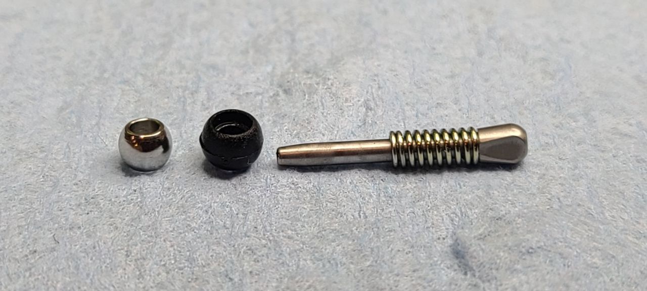

I received mine in a kit (refurbishing indexing mechanisam kit). The pocket (counterbore for spring seat) in a plastic ball is 1mm and that makes the spring 1mm longer with a metal perl, and keeps the Valve open all the way the pressure in the plenum overrides that spring tension. So I believe even the lube thickness on the white Valve body/oring plays a rule in cold.

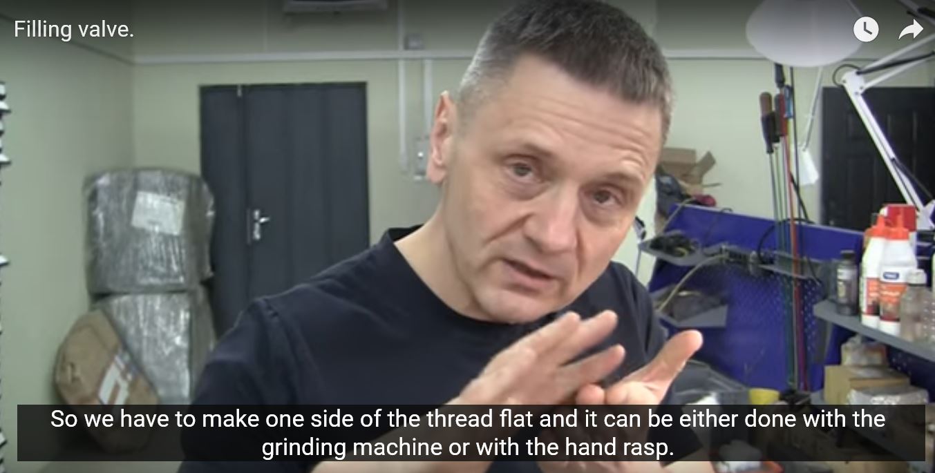

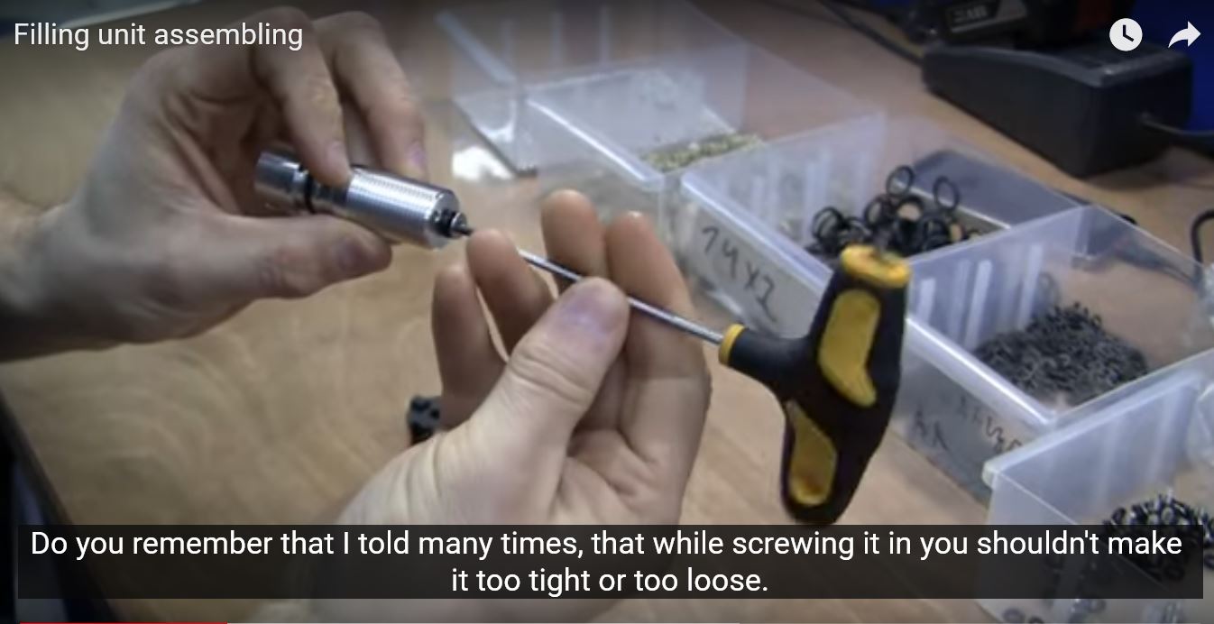

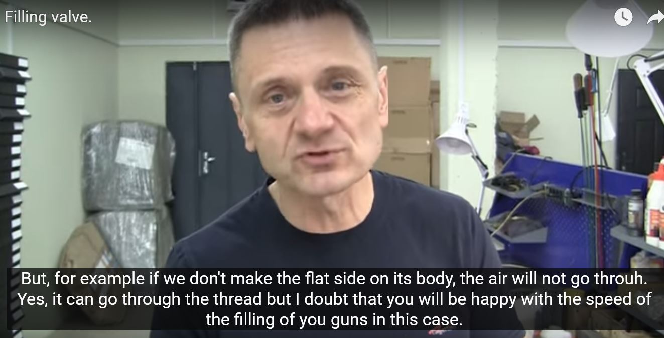

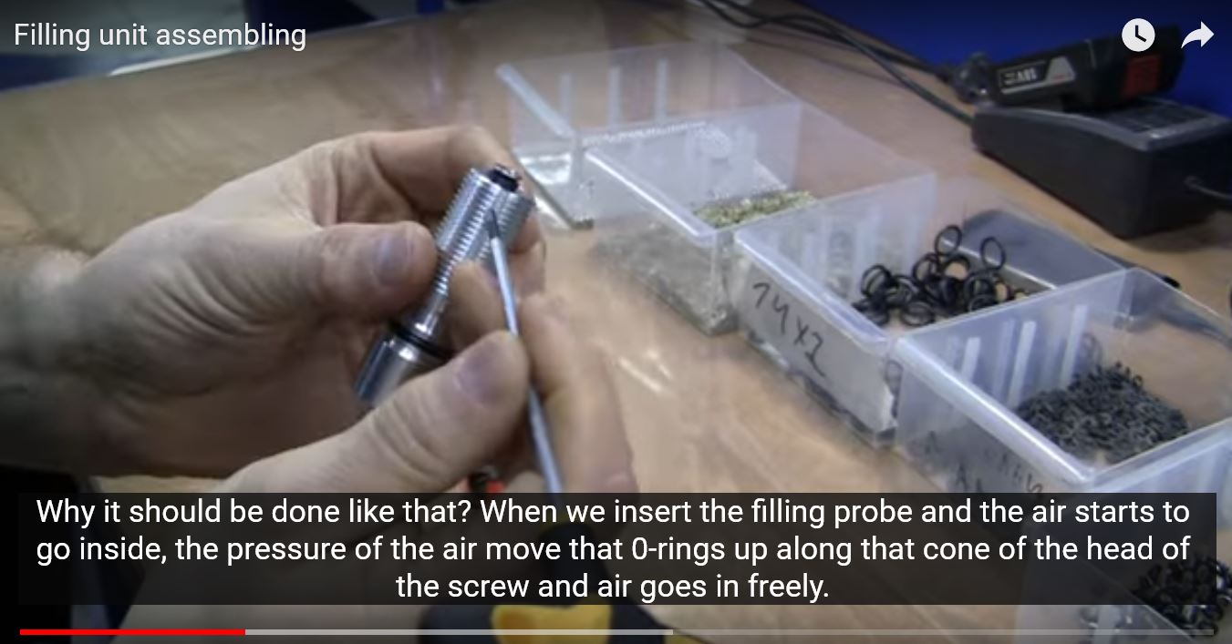

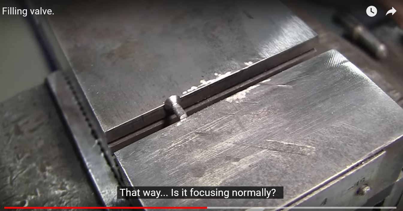

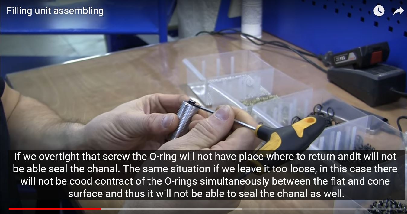

Yes, and nobody explains it better than ED, here's some screenshots

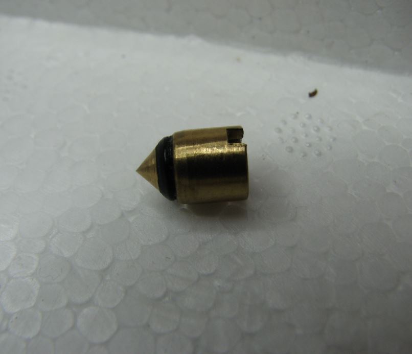

Simple and brilliant way to make a check valve IMHO, compare with FX's over engineered version (as in my cyclone, cutlas, monsoon, revolution) - all leaking because the o-ring goes flat over time - while filling the Fx's I can hear a buss from the o-ring vibrating, this will produce a lot of heat that will degrade the o-ring over time
