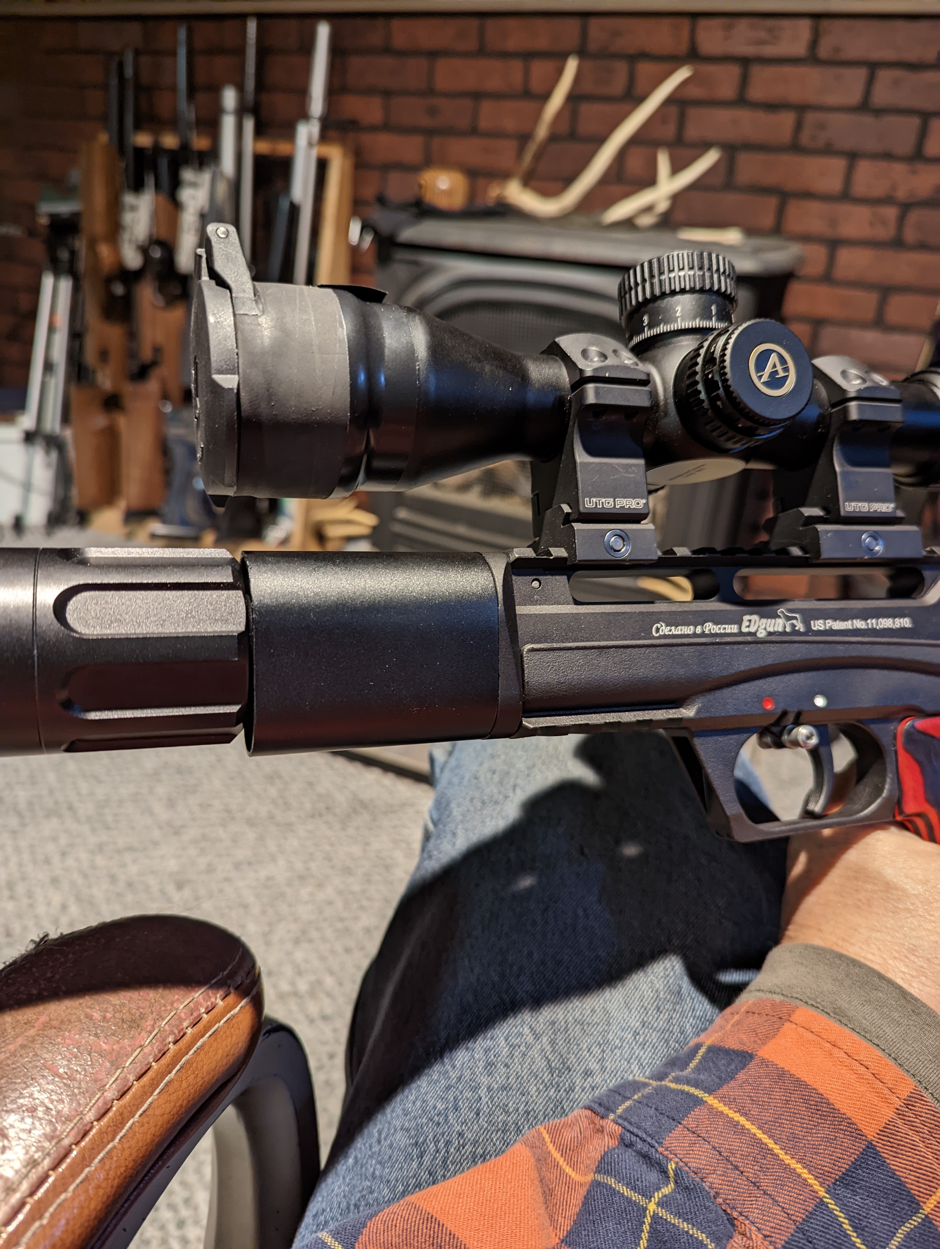

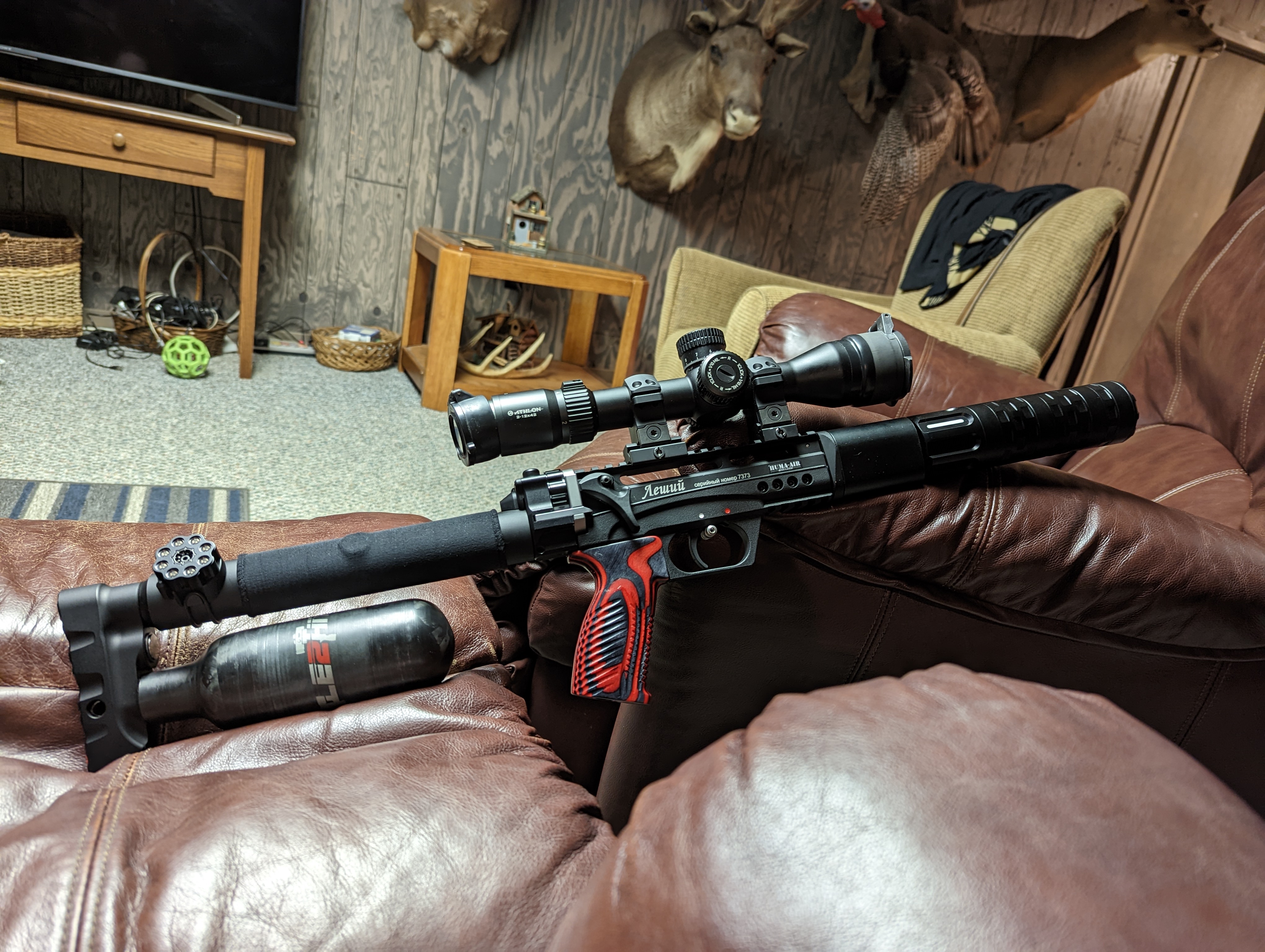

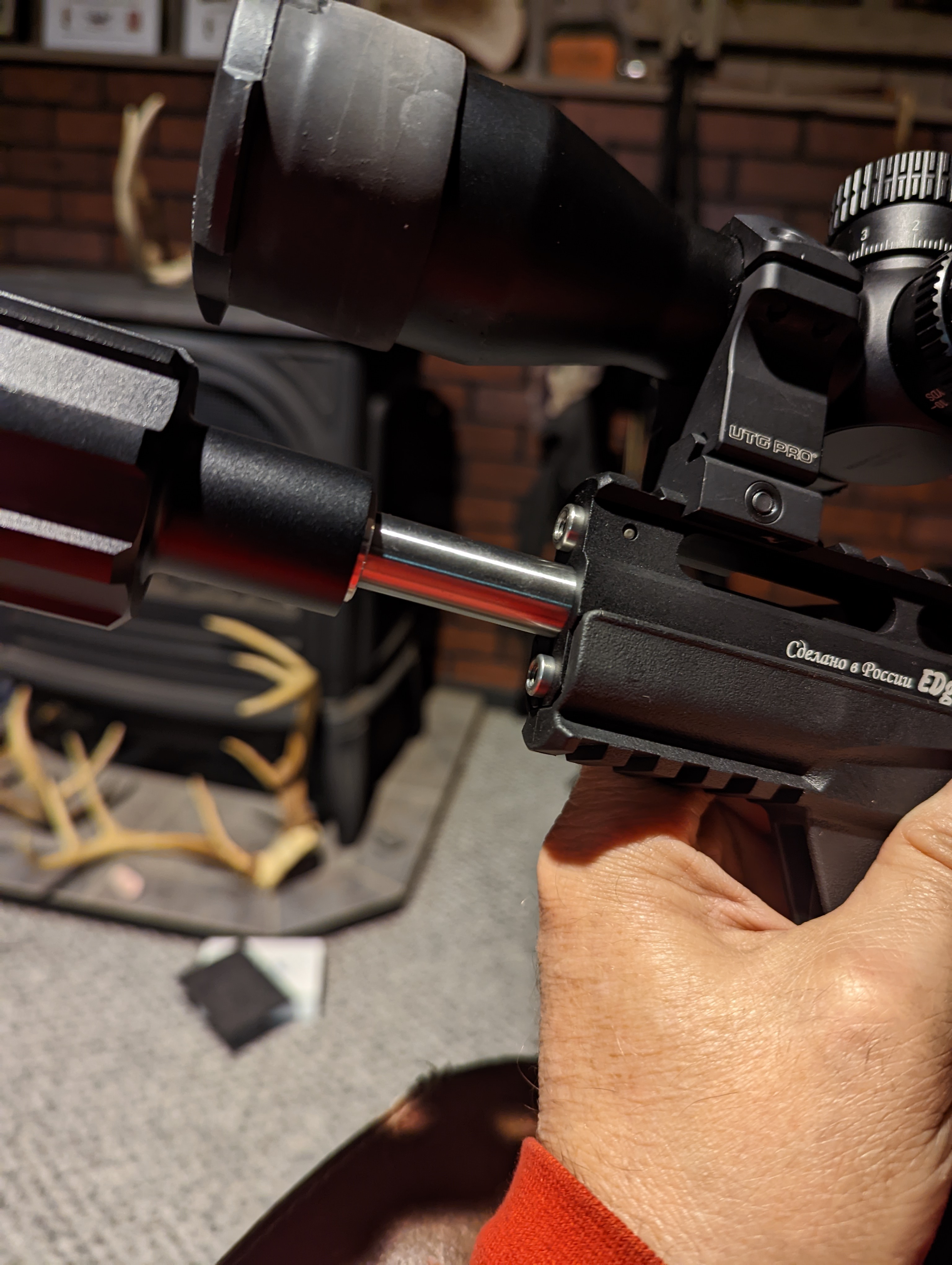

Not wanting to spend the extra $$ for a pic rail I simply cut the OEM moderator...hacksaw and file and it was done. This is with the Behemoth moderator. Overall length with the 250mm barrel and Behemoth moderator is 29.5".
Yeah, that’s Keith - always being creative.
Since getting this I've replaced the air cylinder...bought another barrel....replaced the regulator....bought another moderator....basically was fed up with replacing things and just made this work. Almost $200 for a 3" picitinny rail just to fill the void seemed excessive.

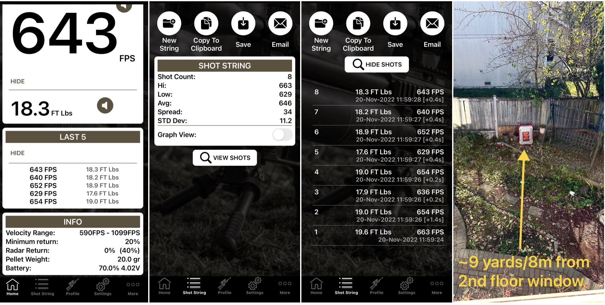

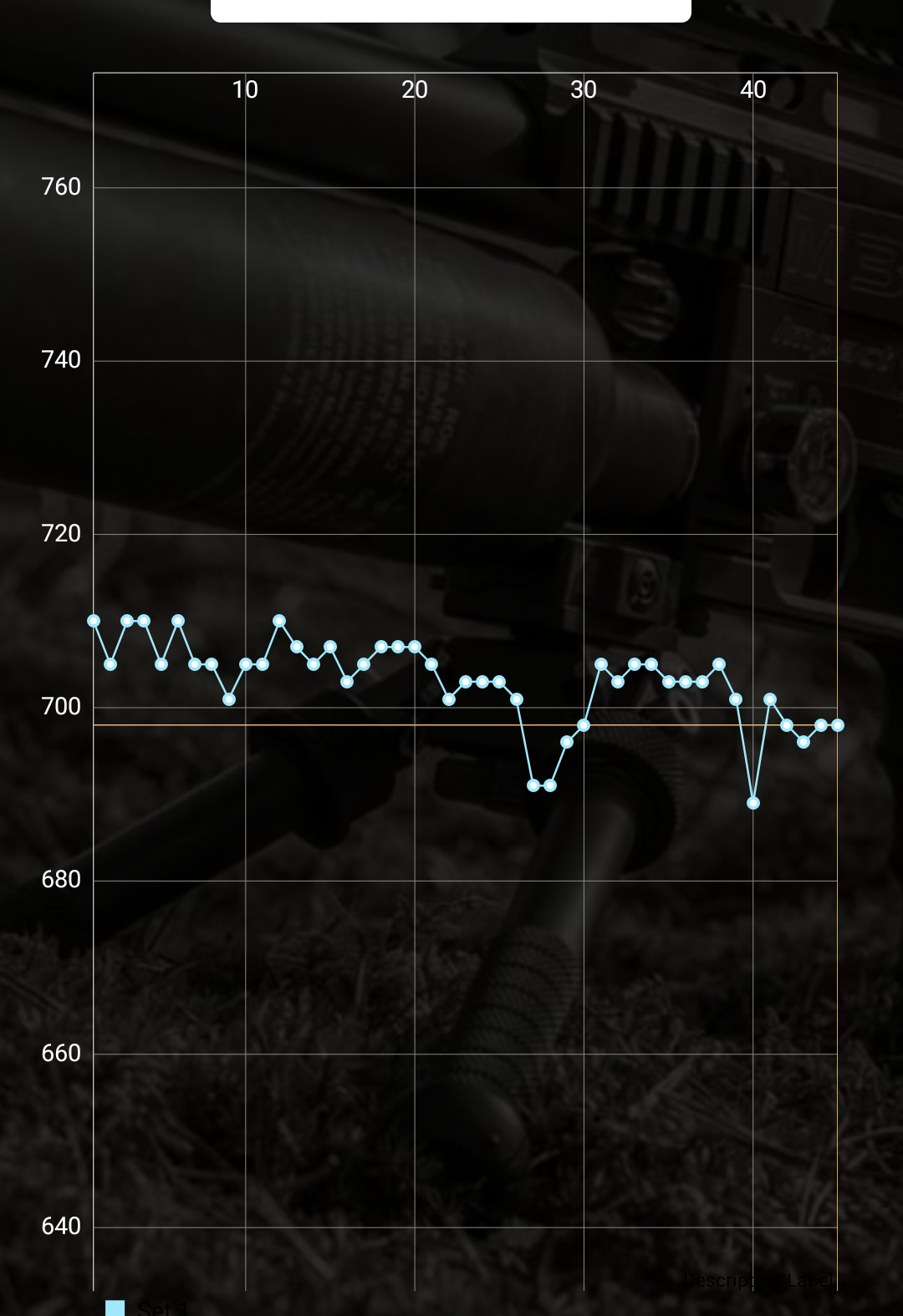

Here’s a little refresh rate demo, of the Huma-Air Raptor Tuning Regulator, on my Leshiy 2 Hornet 250mm, with 20 gr ZAN Projectiles Slugs.
Here's some more great info on the new Huma Raptor reg. My 250mm .30 with the REPR reg was set up from the factory at 700fps for about 32shots before it fell off the reg at 100 bar. That's at a 250bar fill.
I just did a Chrono string with the Huma Raptor reg same fill 250 bar. I got 48 shots and it's still on the reg. Avg 703fps with a standard deviance of 5fps. So I'm getting 20 more shots with the new Raptor reg at the same fill pressure and speed.
