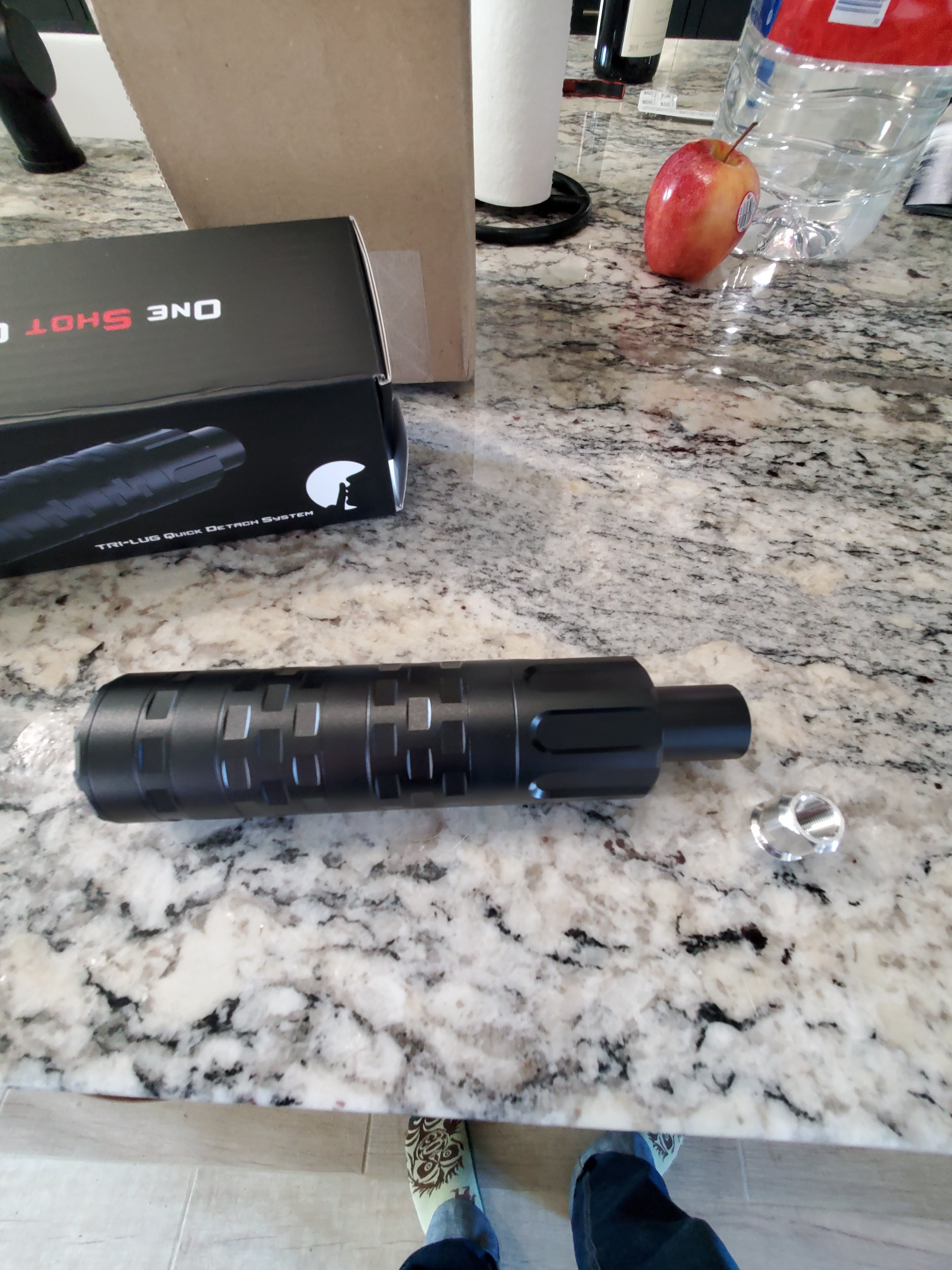

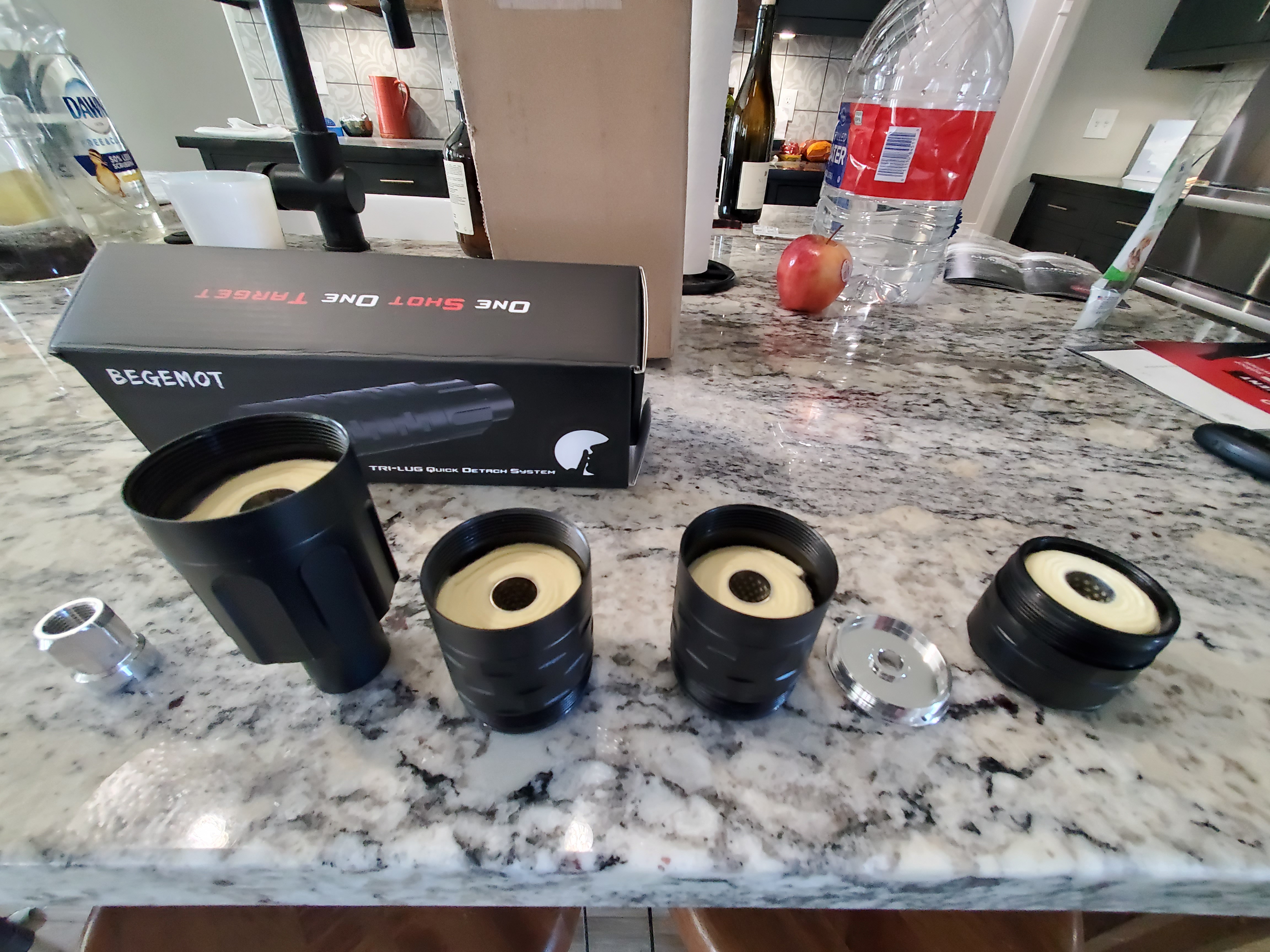

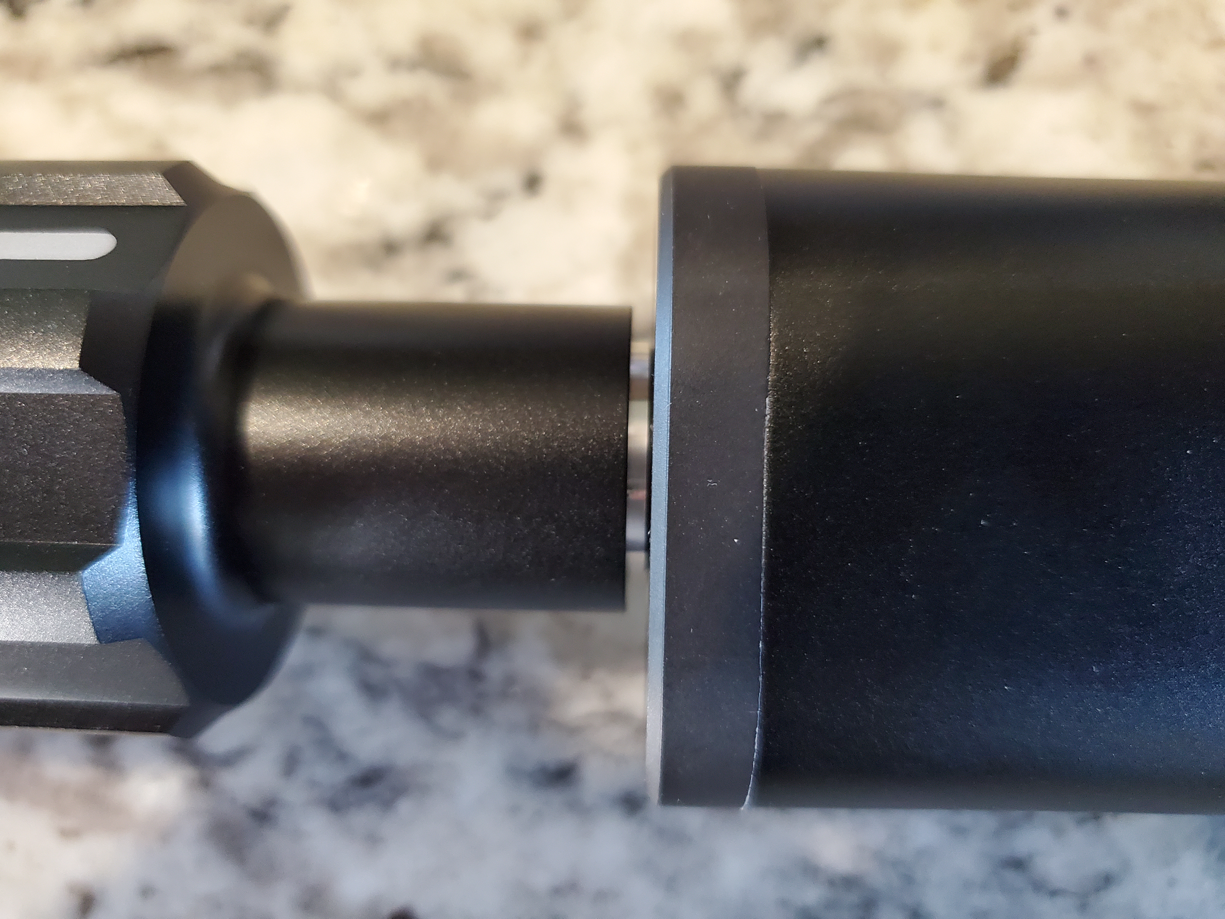

Yeah --- edited the post to have pictures.
Pretty sure it doesn't clip --- shot into a box of rubber mulch a couple times and no visual evidence of clipping anywhere in/on the mod.
Definetly quieter than just the shroud/STO insert. Still definetly not a proverbial mousefart. Highly suspect I'm at the "this is all action noise" point.

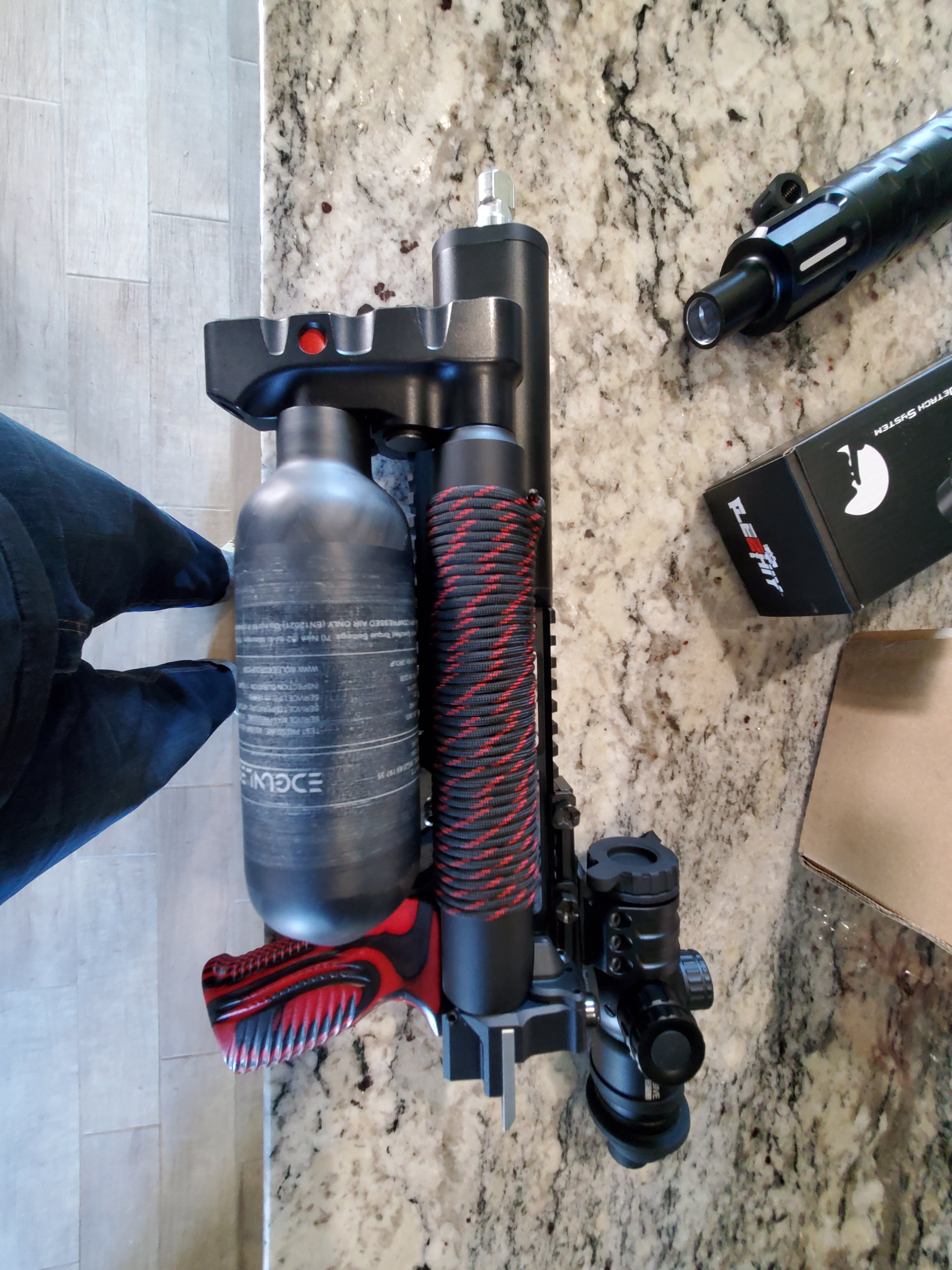

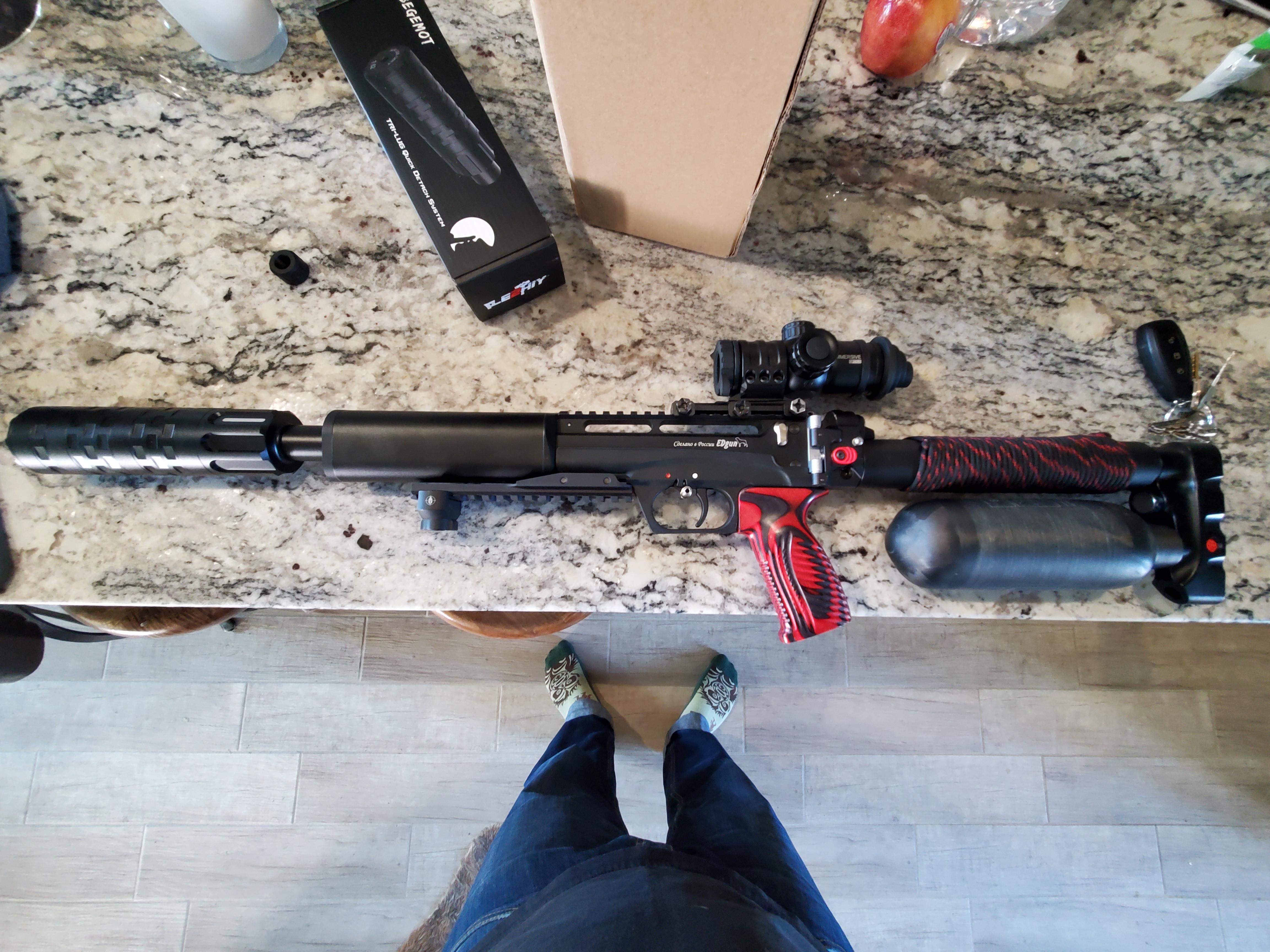

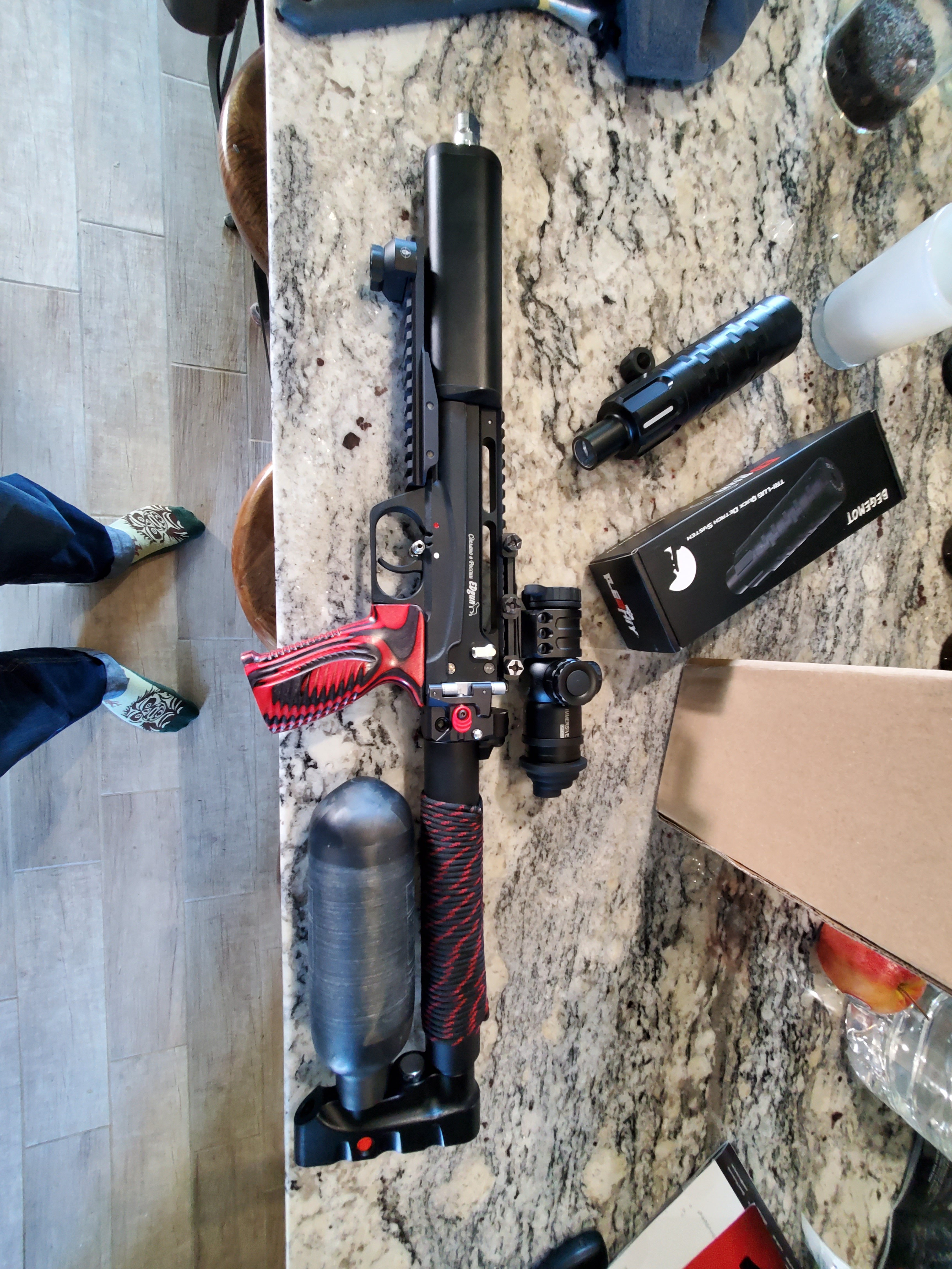

Any pictures of entire rifle or at least the front end? Curious to see what the trio of Striplin + Tri Lug + Behemoth looks like.

I was running a ronin + DonnyFL 350 shroud combo before the behemoth. With the four section behemoth + air stripper, they were about the same. Maybe the donny was quieter. However with two extra baffles, 6 sections all together, the behemoth is noticeably quieter. Enough that I feel comfortable now shooting in my backyard without disturbing anyone. Yes it’s longer but the quick detach makes up for it. Btw, my Leshiy is a .25 cal 350mm barrel model pushing 25 gr jsbs at 900 fps.
Larcat, is that a 470 cc bottle on your gun?
I’m awaiting a 470cc bottle from Spain.

350cc with the shortest top tube -- both from Spain.
