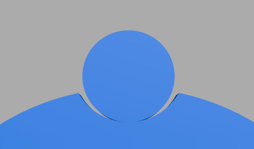

When the index wheel is undersized the indexing accuracy may suffer by any rotating drag, be it friction in the rotating part or small particles located on either side of the index wheel - I know I posted this before but why not take that possibility out of the equation..
