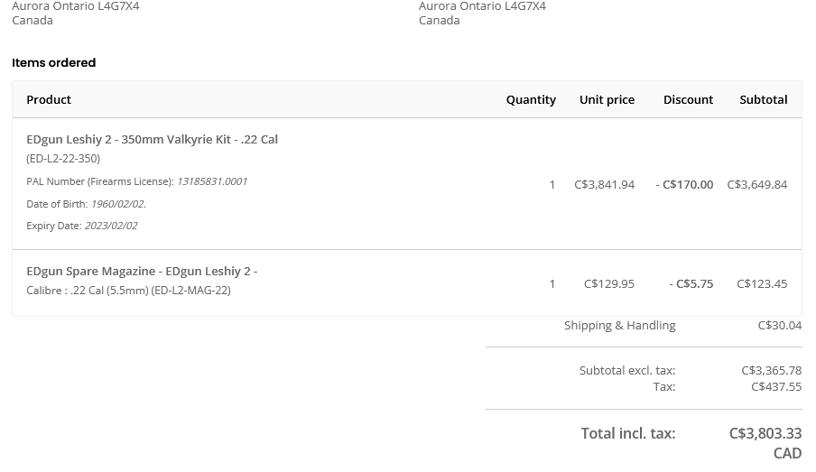

From AGS my Leshiy 2 was $3469.14, including taxes and shipping.
Before taxes and shipping it was $3229.95.
That’s pretty much spot on the US price. At today’s exchange rate C$3229.95 is US$2381.22. A brand new L2 short is US$2,295 while the Long is $2,470.
On a happy note, I was in Toronto for 10 days from Oct 6-16 and was getting an exchange rate close to US$1.00 = C$1.38. At that rate your L2 would have been cheaper then mine (until they add the PST and GST).
Ordered Aug.03.2021. No options to chose, that was a non REPR single kit item available. I got a Edgun muzzle break and the IO was a separate order from EU.
