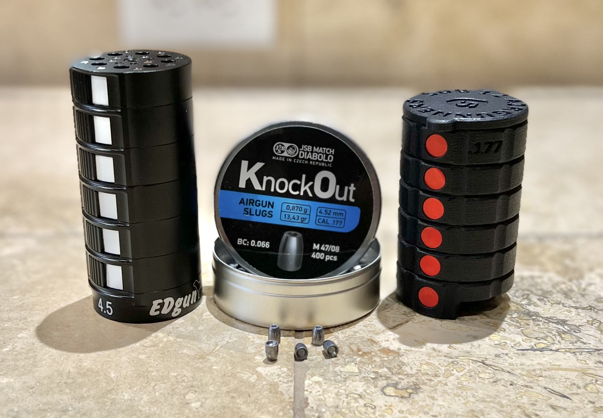

These are very nicely done. Stupid expensive though. 40 rounds at the ready. I guess you could do 48 if you kept a magazine retention plate on the top but not sure why as you need to recharge your tank before you would need 8 more rounds (not to mention these magnets are better served to accomodate removing the retention plate when loading the mag). As nice as these are, I found myself a little concerned that its not easy to assure yourself you loaded it right. If you are not careful you can load a pellet upside down or miss loading a cylinder. I would think a perfect design would be exactly the same only made out of polished acrylic so you can easily see from the outside to verify all is correct.
Actually, it’s a lot easier than you think! You see the trick is not to load like you see in all the vids when ppl are loading one single pellet at the time dropping it in all by itself one by one like you would on a large FX magazine with a removeable plate. What you really want to do with a multi layer speedloader is to have the toplayer open ONLY (by turning the second layer so the pellets will not fall through to the bottom.)
Now cup the top layer with your thumb and index finger to form a little round cavity and sprinkle a small batch of pellets on top of the loader. Shake a bit so they will fall in.
Most of them (like 80 or 90%) will fall heads down, as they should. A few will fall in heads up. This can be easily seen as all the pellets are in the top layer only.
Now use your fingers of both hands to close the holes where the pellets are aligned correctly. (Heads down) Turn the loader over so the incorrectly aligned pellets will fall out back into the pellet tin, then insert those few empty holes with a pellet One by one (which normally only happens to a few that were not filled correctly).
Next make sure the pellets cannot fall out through the bottom, and then rotate the second layer so the pellets will fall from the top layer into the bottom layer. Now close off the bottom layer by rotating the layer above the bottom layer.
Next close off the second layer again, cup your thumb and index finger around again and sprinkle som more pellets in. Repeat the steps and you will have now filled the layer above the bottom layer. Close the layer above that one and close the second layer again and repeat the sprinkle process Until all layers are filled.
It’s a terrible long read, but doing it takes very little time to fill a whole 40 pellet speedloader, less than the time to read the whole instruction above! I produce the 40 pellet capacity speedloaders myself, so I have spent quite some time to perfect the loading process too.
The thumb/index finger cupping and pellet sprinkling method also works perfectly for any round magazine that is or can be open from the top, (like the new Daystate/Brocock magazines, or the FX Wildcat MK1 magazines)
Lastly the greatest tip I got from a post here in this forum (sorry I don’t remember who posted it, but you know who you are!) is when you have a Leshiy2 in .22 and use a speedloader: Put a black pellet retaining plate for .25 on the mag. Since you have the speedloader you’ll keep the mag in the L2 at all times, and when it’s time to reload, simply open the gun, and put the speedloader ONTO THE MAG WITH THE BLACK RETAINER STILL IN PLACE! Now release 8 pellets to reload and behold…the .22 pellets will fall right THROUGH the retainer plate and INTO the magazine!
Now close the gun and the pellets are retained in the magazine! (Not by the retaining plate (as we just saw that them pellets fall through) but by the closed gun itself. (Yes the only ”drawback” is that the pellets are not retained when the stock is folded, so if you need to have it folded when you have the mag loaded you either need to keep the gun pointed down, or use a .22 retainer)
The beauty of using a retainer a size bigger than the pellets is of course that you can skip the ever annoying magnet to retainer to pull it off and after loading don’t forget to put the retainer back in place part)
Voila, enjoy!

Here it is.... a video showing the TOWLE speedloader in action..... I have changed it a bit.
Well done, But I think you should give Towle a percentage of your earnings, as it's essentially his design that you are using (you just modified the amount of stacking)
As for the vid: nicely shown, the only improvement as I wrote in my previous post: Cup your indexfinget and thumb around the top and drop some pellets in, shake a bit and most will fall correctly oriented into the holes. This way it goes much faster than doing it one by one. (read above for full instruction on how to get the wrongly orented ones out and replaced)
Yes.... I have to give TOWLE a GREAT thanks for his effort and time spent on this design.
Yes, I have "only" changed the total capacipty, outer diameter and magnet placement.
If I sum, printer, printer case, fillament, magnets, screws and time spent cleanning prints and filling online forms "Under the STOP act" to be able to ship elsewere. I am still way under the total amount of the money spent.
But if you think I am filling my pockets, you are wrong. Ebay fees and posting worldwide, I am keeping 30€ on each...
Some Airgun users bougth directtly from me.... THANK you.... no Ebay fees.

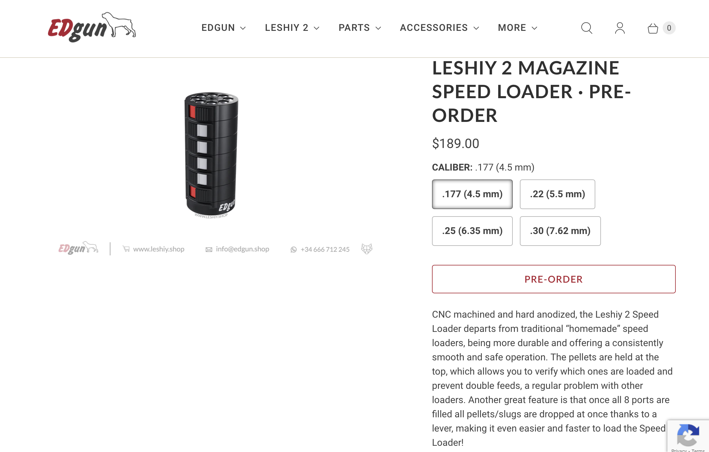

Am I crazy or did the price just go up on the Leshiy 2? I thought it was ~ $2049.
EDGUN LESHIY 2 SHORT (REPR)
$2,295.00
These things are not exclusive. Perhaps both the price went up, and you are insane. Prices are going up for almost everything, so it seems believable. I'm not the best judge of insanity.
Got mine today. Not only expensive but pretty bulky and heavy too. Does feel nice in the hands tho. I had the same concern about upside down loading and thought it was 6 mag (as indicated edgunwest description) so looked to YouTube to see what I was doing wrong and found this video which clears up the concerns for me.

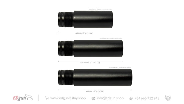

I love my hornet 250, but I wish I could make it a hair shorter where the stock area is. I supposedly have the shorter tank already, is there an aftermarket option?
I think there is both a short plenum and short tank. Together that can make the stock 2cm shorter than a normal Leshiy 2. With the short plenum, if you're firing at high (i.e. "normal for north american") reg pressures, it will cut into how rapidly you can fire, i.e. the regulator won't be able to keep up with your firing pace, since the plenum does not have enough air in reserve.
I recently acquired the long plenum and long tank. It's a little long for me, but it's usable. With the 350mm barrel it seems a little more natural, as well.
Short plenum is 110mm, normal is 130mm, long is 150mm.
For the tank extension,
Short is 116mm, normal is 136mm and long is 156mm.
Now that I read this, I see if you get long for both, your stock will be 4cm longer, and short with both it will be 4cm shorter.
If you load the webpage they show how you can measure to determine which you own.
