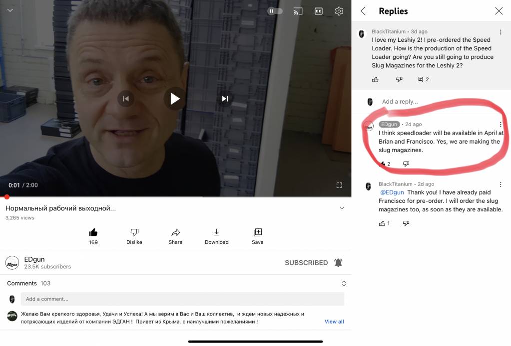

They are not available yet. Ed says that they are making the slug magazines. He did not provide a time of availability.

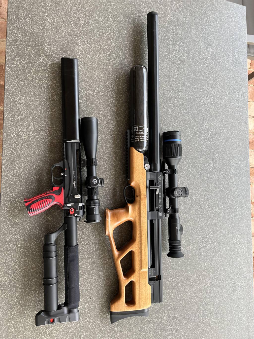

Hi Everyone,
new to the fold got mine yesterday .30 350mm barrel Valkyrie silencer and carbon guard on order and thinking of which bipod to use on both guns? I have never seen so much protective gunk on a new rifle i know its there for a reason and it cleaned up well, Cleaned the barrel and set it up over the chrony today 875FPS & 77FTlbs that will do me, I kinda bought it as a mooch around gun to hunt on the move as i have the Vulcan 3 for static long range shots in .22 they are both IMO in a league of there own, i,m thinking about sights for the L2 anyone use red dots ? I’m thinking these are more for big game where i,m only onto rabbits and rats around here as i,m in spain i haave lots of my own land to wonder over and its full or rabbits or though i,m knocking the population down sumwhat,
