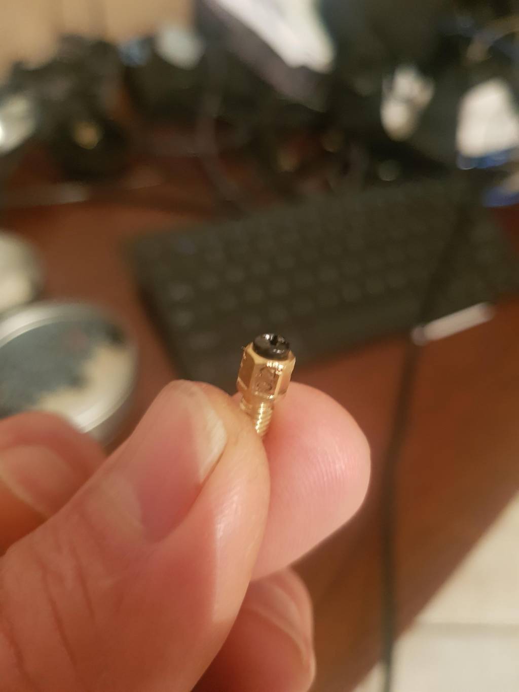

wanted to share my experience with jet tuning:
.30 450mm
switching from .3/.3 to .2/.2 provided about 5pe max boost, even bringing the reg up pretty high (190 bar) IMO for .30 cal, you're better off buying a screw that can be used as a plug if you want to get more power out of the 450mm barrel. a 600mm barrel will probably help a LOT more
.177 350mm
my butt for .177 had .3/.3 labeled jets, but not sure if thats what they actually were. i was having difficulty getting it below 950 FPS with 7.9 grain. i swapped in 1.3/1.3, and now shoot around 850 @ 75 bar

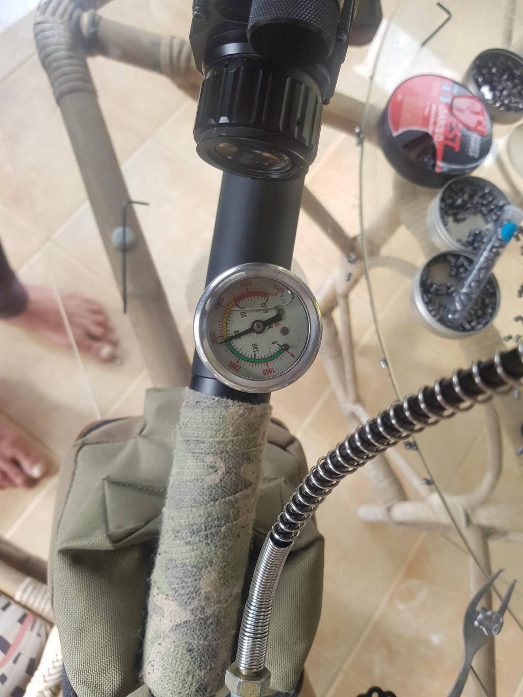

And now for what may seem like a silly question to those with more experience.. I also have a digital gauge for my plenum, and I seen a few photos here of people with the gauge installed.
The question is, do you leave the gauge installed all the time? or just install it when adjusting the pressure? I have just installed mine to see what the original pressure was, and to add a bit. I than removed the gauge again and went back to the plug.

i do the same as you. when i need to tune/adjust, i throw the gauge on. after i get it where i want, i remove the gauge.
i also use a 350cc bottle, but throw the original tube on when tuning to conserve air

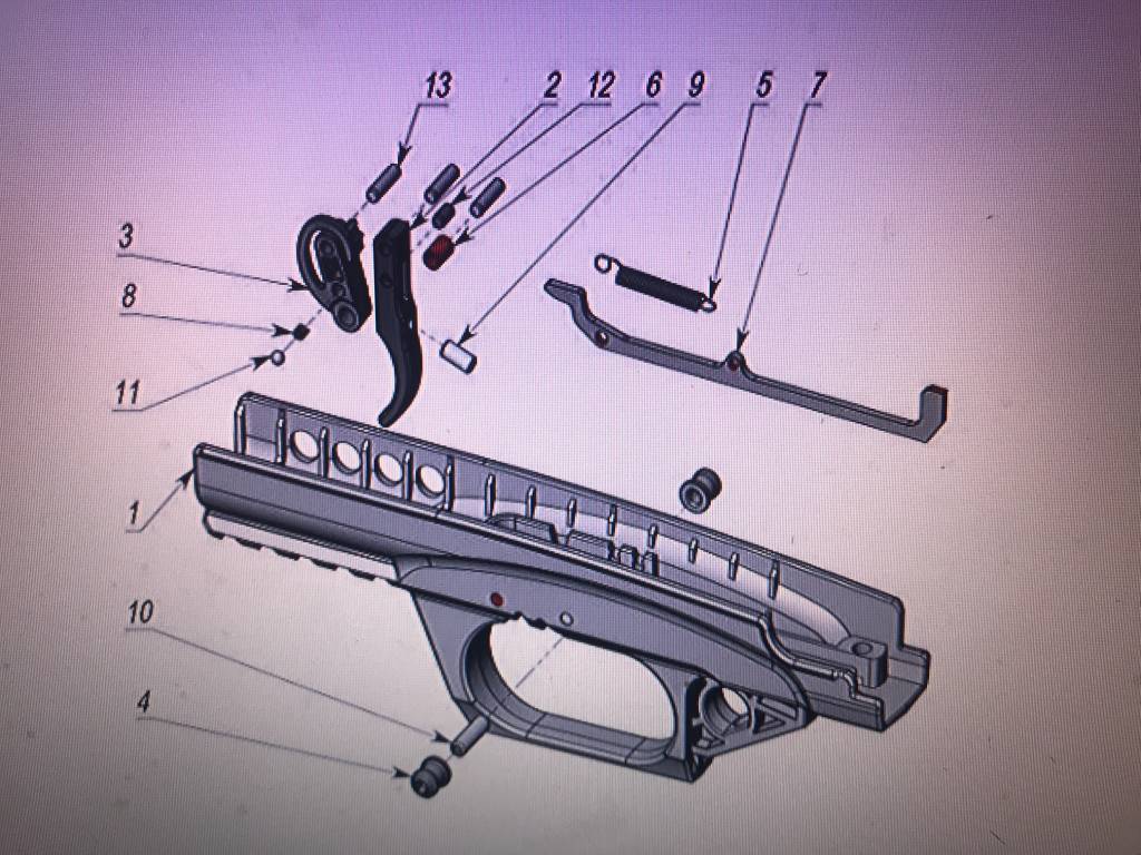

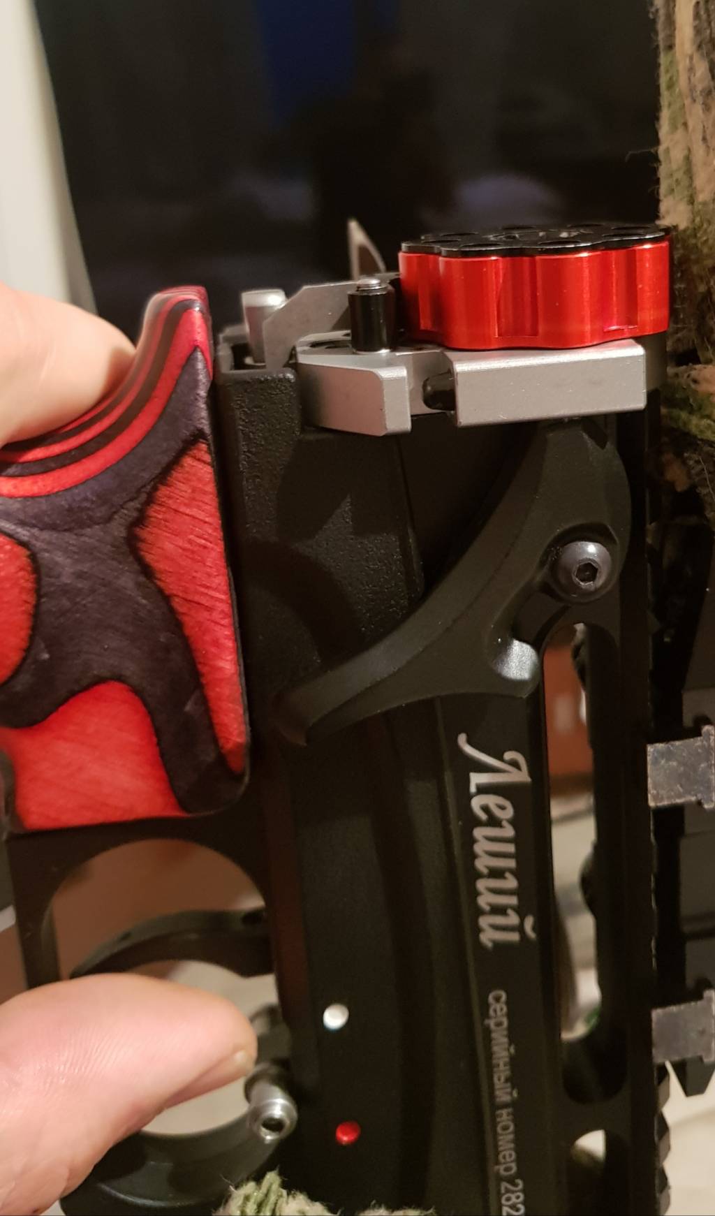

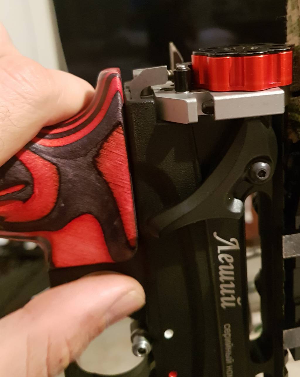

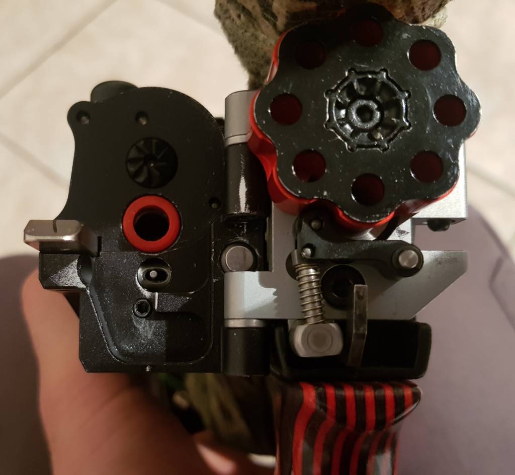

I put a new safety spring #5 in the drawing because the gun was firing in both the safe and fire positions after installing the new spring it still does the same so I adjust the screw behind the trigger and it will not work correctly either it won’t fire or it fires in both safe and fire positions is there something else I can look at
//www.w3.org/2000/svg%22%20viewBox=%220%200%20210%20140%22%3E%3C/svg%3E
Is the valve pin length normal? If it extrude to far out the 14 Euro BB bal and or its guide has collapsed.

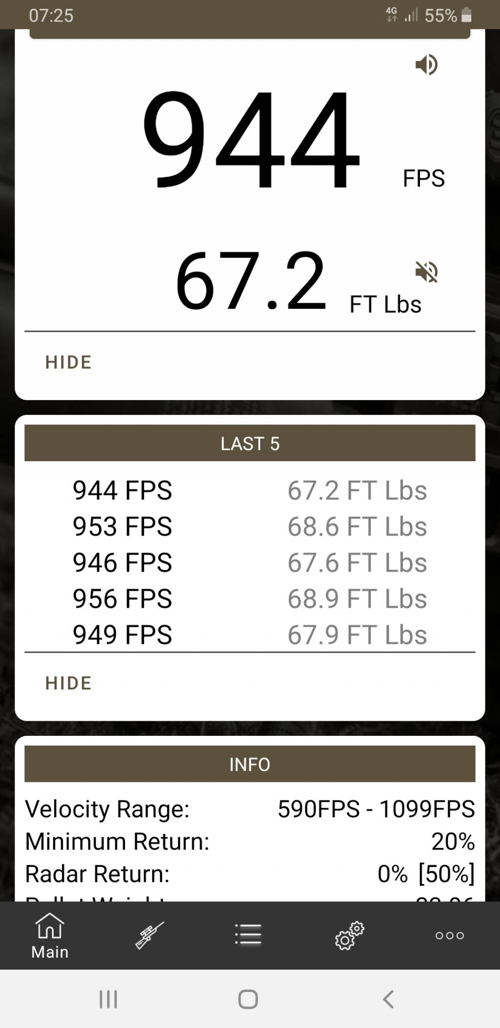

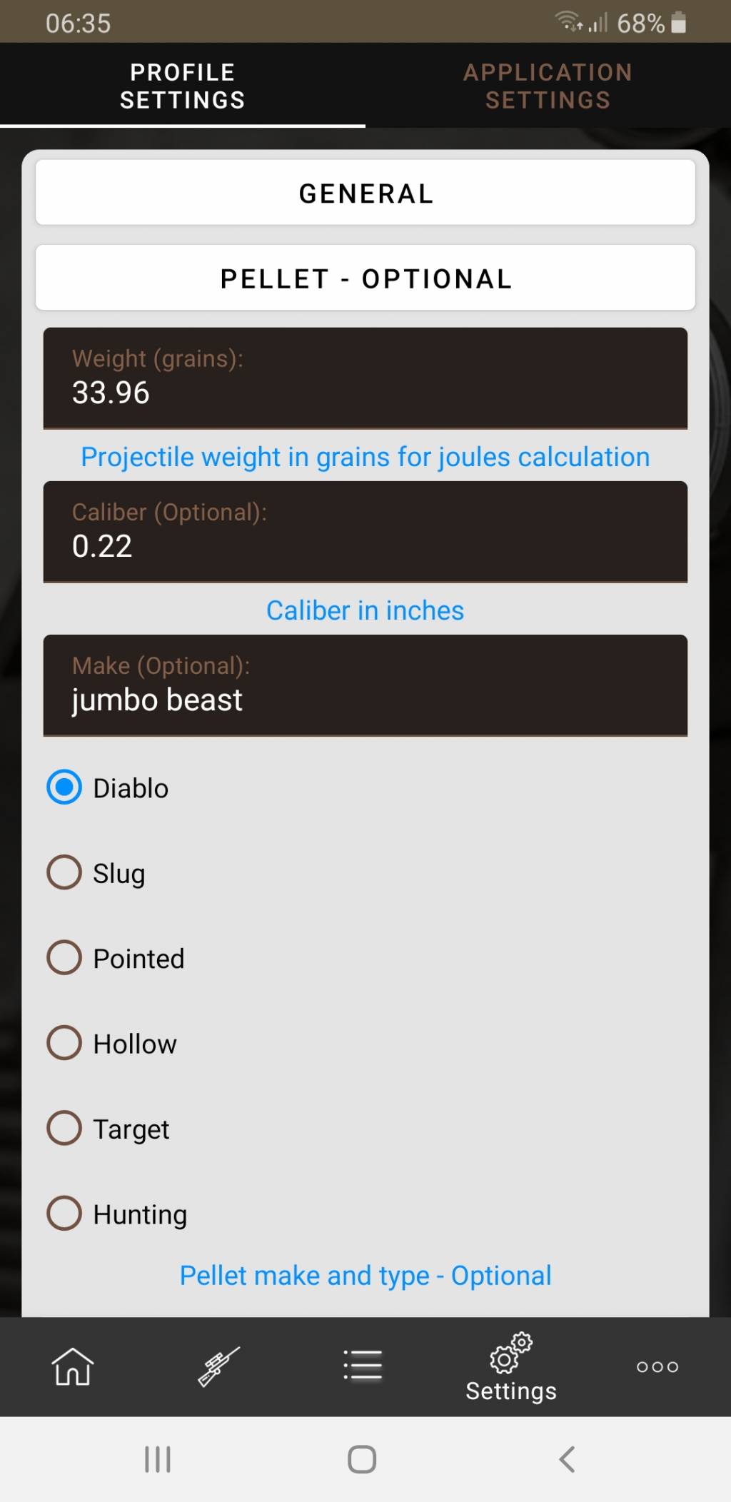

Thought I'd share here too... 70ft/lb in .22 and there's still room to increase.
0.1mm and 0.2mm jets on old forward plug.
350mm barrel in 22 cal. Reg set to 190bar.
No monster RD 25.39gr left so this is with Beast 33.956gr. I get better velocity at lower reg pressure from the custom spa p10 410mm barrel though.
That's crazy, I thought I was maxing out the 350mm barrel by pushing 25 grain slugs at 950 for +- 50 FPE....

When I have the fire controls off the gun the safety bar drops like it should when the rifle is reassembled it drops a little and shifts to the side a bit but I’m pretty sure it’s not dropping far enough I wonder if I can degass it and remove the mag and close the stock if I can see if it’s dropping far enough to miss the valve pin
Something is up there. If you can upload some pictures. Otherwise, safety issues should be dealt with by the local rep.

I prefer to leave my Sekhmet gauge installed, as it is very unobtrusive, I like having the ability to spot check the pressure at any time.
Having the gauge installed allows me to monitor for leaks, pressure drifts and if the first shot might be unexpectedly hot.
