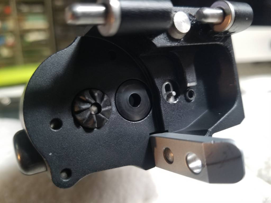

4 mm hole in the Delrin donut makes the L2 speed more consistent and quieter, and works better than a Teflon (PTFE) donut

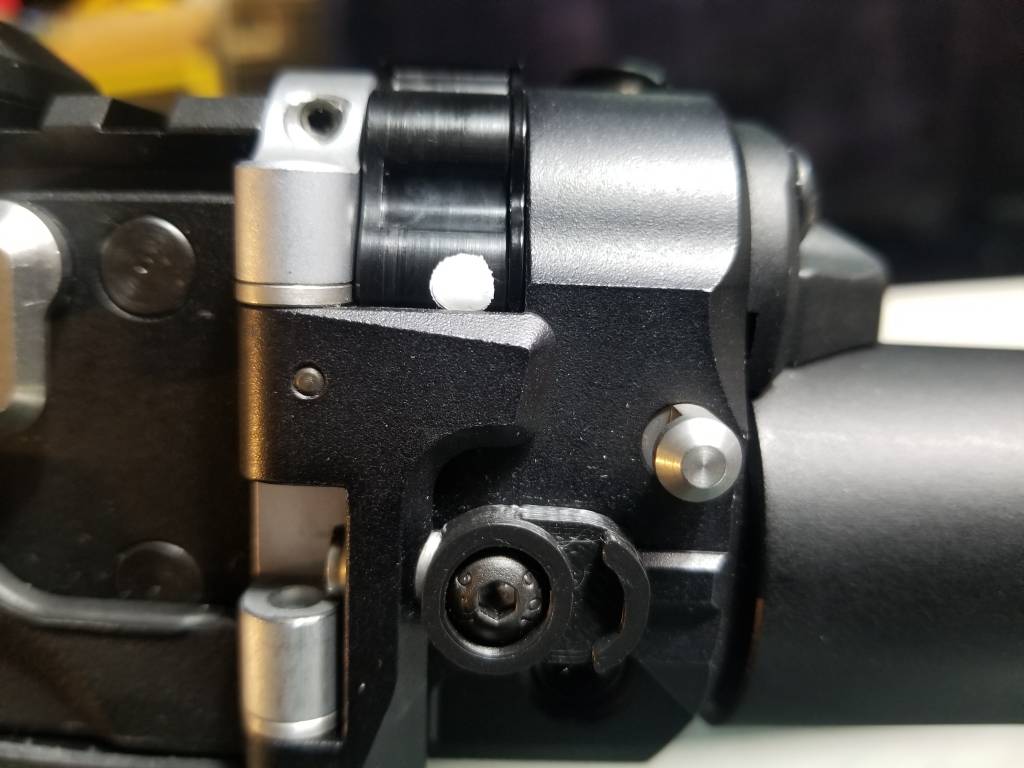

L2 mag with a paint circle prevents from blank shots:
Depending on caliber and power I would guess, but if anyone want to test this steel plates for the .177 comes with 4 mm holes
Found it even better with a 5mm hole puck on .22 cal and PTFE is a better material. Pretty sure the original red pucks are not PTFE. Geoff @ Sub 12 Airgunners youtube chanel believes the PTFE pucks are better too. He sells them on eBay UK.

First nylon is not acetal. Delrin is one of the forms of acetal. Delrin is hard enough not to scratch easily but soft enough to seal at high pressure. Wjcake423 made the pucks from teflon and they scrached easily. The delrin worked well and he made some experiments with different hole sizes. It seems the smaller size hole sealed better and didn't let the firing air expand as much in the puck raising velocity. Which he posted earlier. He did polish the breech face to make the puck seal better and it quieted the gun.
