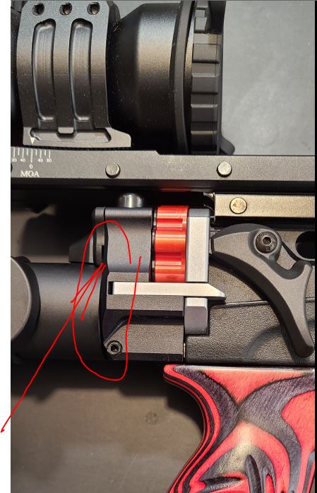

Finally I got to Leshiy2 tuning and trying to make it to my liking, my sub-post below:
https://www.airgunnation.com/topic/post-your-leshiy-2-tunes/?referrer=1
What I am confused, the air blows in these two locations circled roughly but noticing some ports where pointing arrows.
I am not educated enough (yet) is this phenomena normal or I shall have a closer look? Currently I have about 72 shots on a fill with these ports wasting air.
This is waisr air from imag. Indexer and also waist air from Valve>mag> barrel
Ps 350cc tank, 2x 0.8 jets 104bar should give 897 fps 16grain jsb/aa field target and 100× shots before the speed drops
Thanks for the education. Anything could be done to these exhaust ports to use air more modestly?
With the number of shots I am on track then, 300cc vs 350cc, my numbers are about there.
