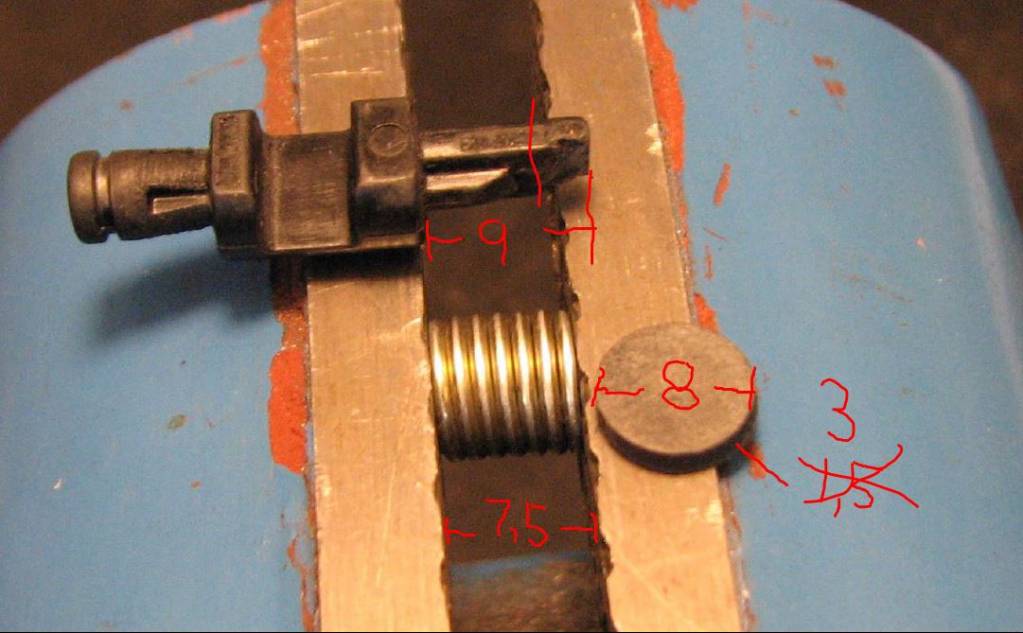

Kiteboardkid, I had the same problem with indexing after only 300 shots. Received my L2 .22cal, in February.
I dissected the problem to be the #3 spring. It was not returning the vertical piston, (part #17), strong enough to completely cycle the magazine. I simply put a 1/16th thick washer behind spring #3. That gave the existing spring more thrust when returning the piston to it's rested position, allowing the mag to completely rotate as it should. I made sure that the ID of my washer was large enough to allow the piston to still travel to it's full height.
I haven't had any more cycling issues in over 2500 rounds. Now I'm just hoping that the plastic piston wont break, like some others have posted. But I hope that if, and when it does, they are readily available as spare parts, as I believe this is a potential failure point in the original L2, and sounds like it still could be in the newest version.
I'm not bashing this gun, as I love it!! Just thought I should share my experience.
Hope this helps others keep this fantastic semiauto up and running.
Don't panic if the top of the plastic piston fails, I had that happen, fixed it by adding a shim of rubber, so now the fully compressed spring against the rubber shim takes the blow at the end stroke instead of top of piston - gone through 15 tins of monster red. since without any indexing problem whatsoever
The shim is made of semi-soft rubber OD 8 mm x 3 mm
Just made a 1.5mm thick washer 8mm diameter from brass and seems ok, a few miss indexes but only at lower reg pressures, I also note the puck size makes a difference as well when using reg at lower settings 60-80bar, using the smaller puck 3mm hole works much better. At 135bar it works faultlessly. What reg pressure and puck sizes do you use Scott and Towle? I like the idea of using a rubber washer though, I might experiment with that too.
