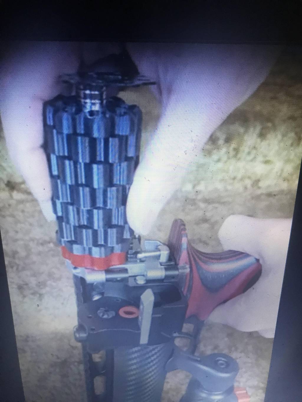

The magazine has to handle firing pressure and pellet to barrel alignment is critical. Exit bore diameter is also critical. I think the rapid reloaders that people are printing is solving the issue really well. Both for quickly reliading magazines and reloading the gun like a revolver with a speed loader.

I honestly believe the best option is to keep a mag in the gun and use the 3D printed loaders.

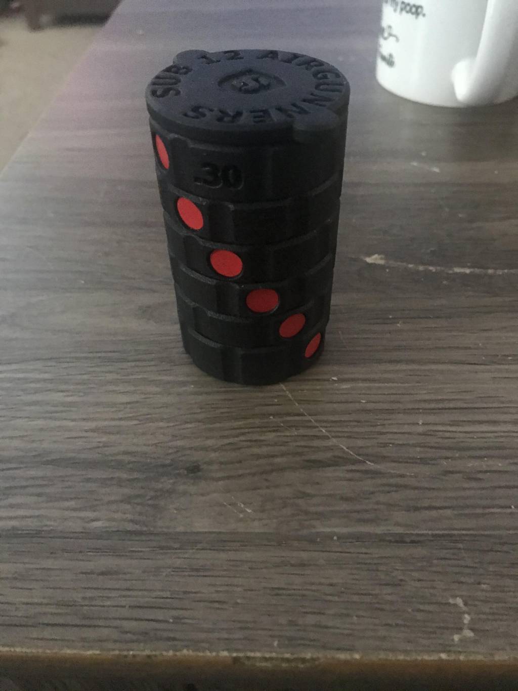

Was just curious if anyone’s come up with one I already have the speed loader from The Sub 12 guy on YouTube and I just ordered the one from a gentleman on here

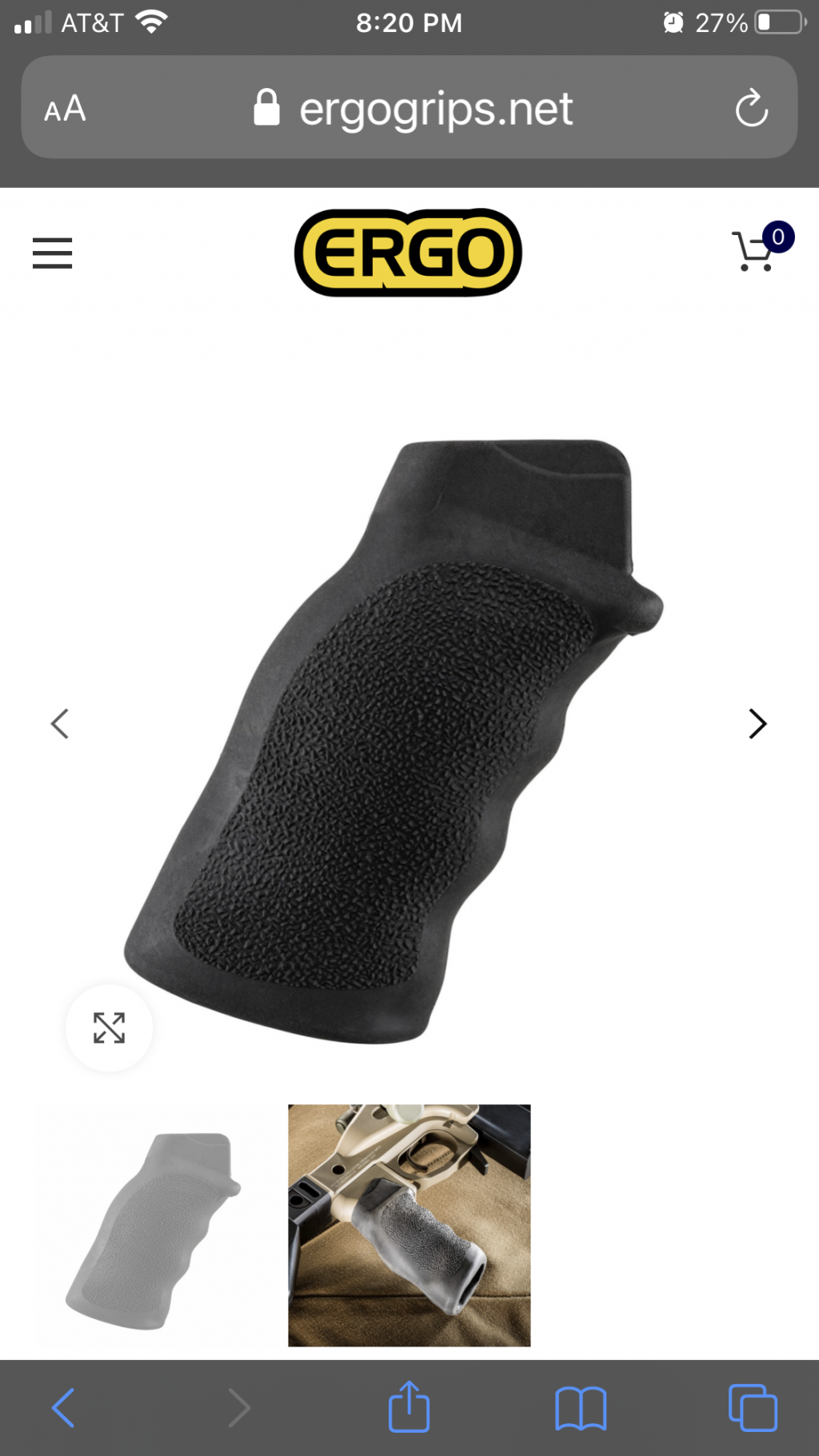

Anyone replaced their grip? I had a Magpul MOE without the beavertail and it didn't work - looking for other options.
Are you saying that it didn't work because it doesn't fit your grip or did you have an installation problem?
it will fit, but the screw was too long i think - i was short on time, maybe need to get a shorter one?

You can't use the grip screw that comes supplied with an aftermarket AR15 grip. You have to use the factory L2 grip screw and add washers or a spacer so the screw doesn't interfere with the safety. You could also use a shorter grip screw but in metric threads. This video from Brian explains it well.
