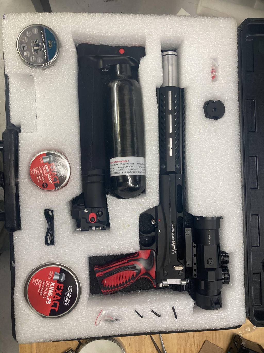

Got a case figured out but I’m still waiting on the Ergo grip and carbon tubing for he fabrication of a shroud. I’ve presently got it mocked up with a piece of 1.25” aluminum tubing.
The case was actually from a QB57 takedown rifle I had in my possession a long while ago when I was just getting into airguns. Fits perfectly with lots of room to spare for pellets , magazines , tools etc.

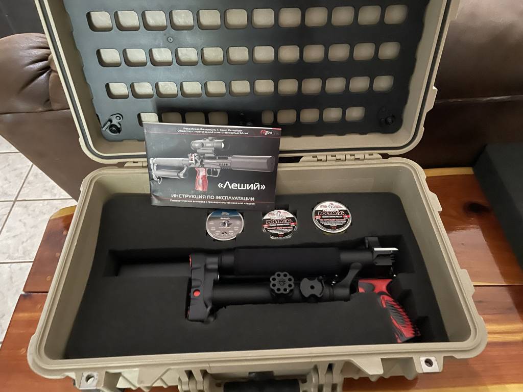

Well, got mine back. Spent some time working on getting the foam just right in the pelican case. That was yesterday.

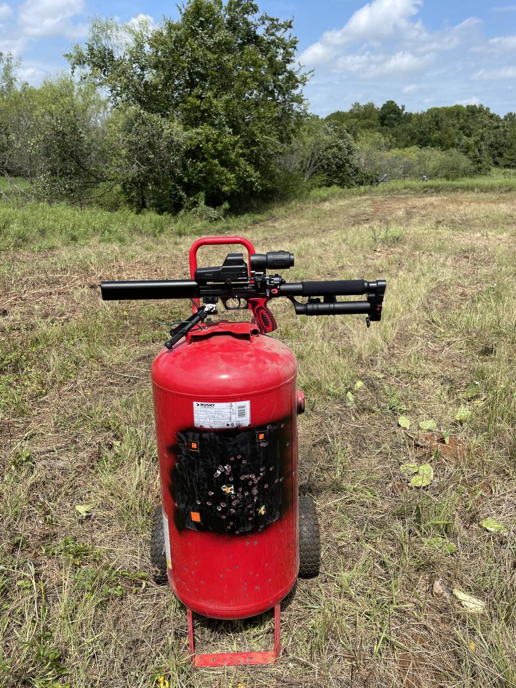

This morning I went to Los Ranchito to fling some lead. Zeroed in at 60yards for a good MPB range with Barracudas/Kodiak Match at 31grains. 930fps for 60fpe at the muzzle.
Had to do a little file work on the EOTech 3x magnifier mount to get it to fit all the way back. Also had to shave a tiny bit off the release on the rifle/pistol.
Put some fresh paint on the target with some orange stickers for aim points. Then drug it out to 100 yards. My eyes are not as good as they used to be. The mildots completely covered the aim points on the target. Started with the 2nd mil dot holdover and impact was low, at the 3rd mil dot I was close.
I ran through Polymags 26, Kodiak Match 31, Barracudas 31 and New Boy Seniors 31. Of course I left the slugs at home, Hopefully I will try those out in a few days.
This thing eats pellets and air like nobody's business. I'll be looking into the bottle option and some extra mags. I am also going to put a better optic on because I am curious to see how well she will group when I can actually see the target.

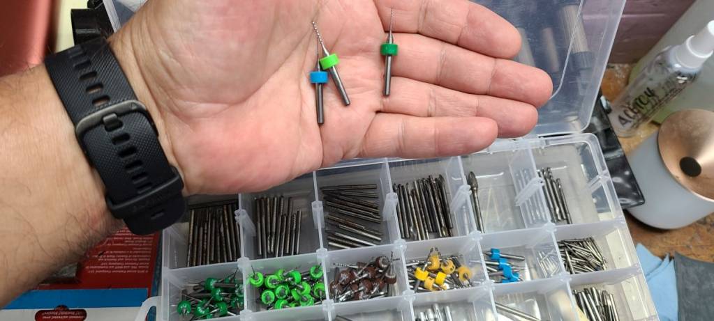

I got myself a new set of numbered drill bits and was was thinking of drilling out the jets one step at a time. Unfortunately after just checking , my bits start at .042” . The jets are indeed metric and the two .2 I have convert to .0078” . Oh well back to the shopping cart at EdgunWest .

OK I didn't wanted to be ugly with the idea, but just visit your dentist, they have these small drill bits and having an ultrasonic cleaner is always a bonus... ;)
