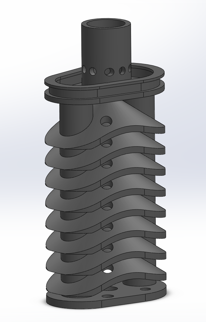

its basically finished now and I don't see any possibility for further improvement.
as this is 3d printed and 3d printers quality vary a lot between each other I will release a full tutorial by the end of this week on how to print it (orientation, infill, support.. etc)
and how to install it safely incase your printer is not accurate because to increase sound reduction the hole tolerance is very tight (for example for 5.5mm the hole is 6mm).
for reference I'm using a prusa mk3s 3d printer.
my .22 350mm L2 was 36 fpe on standard baffle and now its 34/35 fpe so expect a little power loss for noise reduction.
after 600ish shots the thin top of the baffle cracked so I beefed it up and its all good now.
also I noticed that the backside of the moderator is venting a good amount air on each shot.
I'm able to test it and shoot it in my 5x4 m room without damaging my ears. my metal trap though is very loud :D

of course i will release for .22 .25 and .30 (i only tested .22 though).
yeah the printer is amazing but for this specific print.. some post processing is required to ensure the tight tolerances are met because it has to be printed horizontally. which is why I will post a basic tutorial on things to double check... etc
anyways here is the final design.
preferably it should be printed in PETG. PLA suffers from deformation under load based on my experience.
will post everything within two days in the weekend.

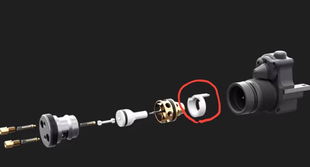

looks like it covers some of the holes, maybe for efficiency because those would never need that much air in practical applications.
Makes sense. Thanks.
actually, since it is related to the jet sizes, it is probably more related to timing or dwell. the bone looking piece also looks like a flow restrictor.
