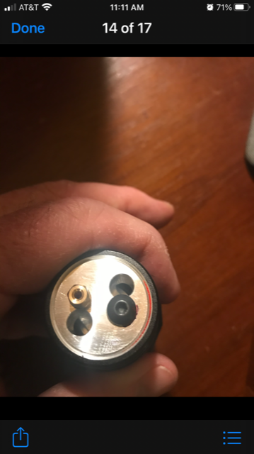

Is it just me or do the nozzles look a whole lot like Mikuni carburetor jets? I’ll more than likely take mine apart shortly and compare to the hundreds of different carburetor jets I have here from my motorcycle tuning days. Thanks if I find out what actually fits I’ll let you’s know. Last time I had the jets out it was for making an adjustable Cobra valve for an Evanix K550.
The Mikuni main jets have 6mm threads. The Leshiy jets are 4mm so they won't fit. I already tried🙃 They can be 3d printed though if you have a printer.

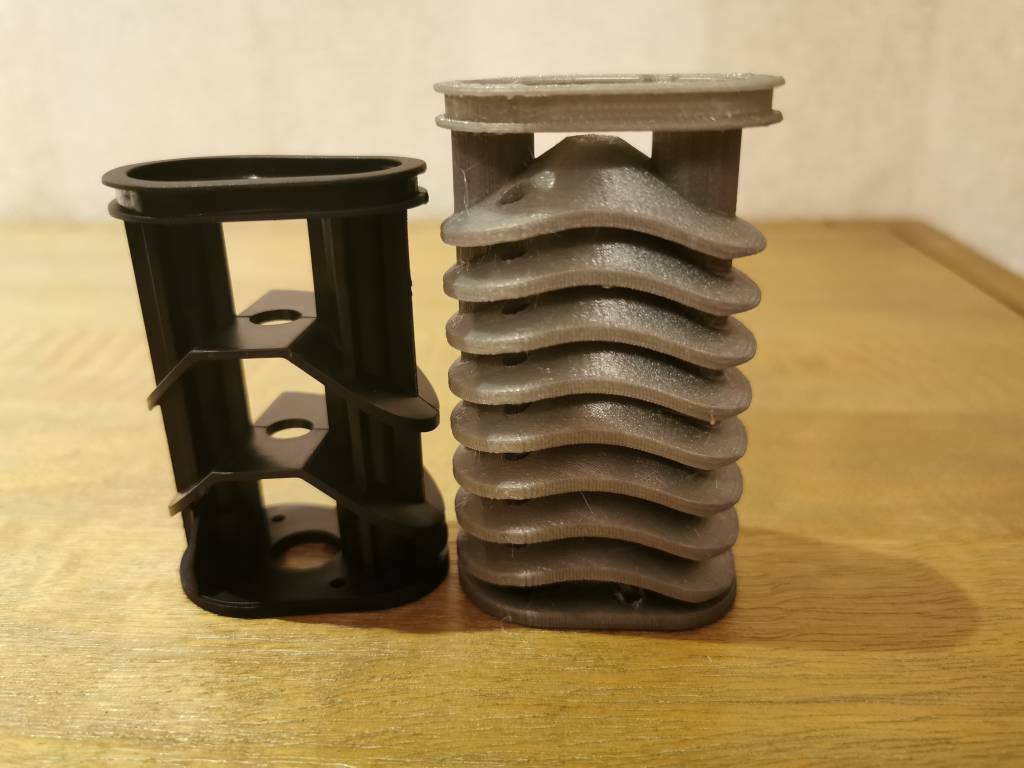

When i got my leshiy 2 .22 350mm it was way louder than any other airgun i have and i wanted to use it in my backyard without disturbing the neighbors so i modeled and 3d printed a baffle which reduce the sound from 95 db to 75 db. (long range accuracy not tested)
Up to 50m the accuracy is pretty much the same.
It significantly quites down the airgun and pretty much the air from cycling the magazine is the one i mainly hear when shooting.
Im currently working on different iterations in my spare time to maximize soud reduction and until now i managed to reach 71 db. I will do further testing then release an stl file for everyone to print if they are interested.

while I had the gun apart I did look at what I had for jets in the valve. This one being a .25 I have two .2 nozzles . I did find some carb jets that do thread into the valve but they are way too large at 1.5 and 1.8 . For now they are going to stay. I slugged my barrel and magazines and I think the new magazines are a tad smaller than the originals ( red ones ) the mags are at .252 and if I size my slugs to that they don’t fall out and require just a bit of a push to get seated. I the barrel itself measures in at .2535 grove and .248 land . I sized my cast 41 grain BBT and at 15 yards they are grouping very well. I’ll do more shooting at farther range to see if they perform. I’m really liking this Edgun. Wish all my rifles were this well built not to mention so easy to disassemble.

while I had the gun apart I did look at what I had for keys in the valve. This one being a .25 I have two .2 nozzles . I did find some carb jets that do thread into the valve but they are way too large at 1.5 and 1.8 . For now they are going to stay. I slugged my barrel and magazines and I think the new magazines are a tad smaller than the originals ( red ones ) the mags are at .252 and if I size my slugs to that they don’t fall out and require just a bit of a push to get seated. I the barrel itself measures in at .2535 grove and .248 land . I sized my cast 41 grain BBT and at 15 yards they are grouping very well. I’ll do more shooting at farther range to see if they perform. I’m really liking this Edgun. Wish all my rifles were this well built.

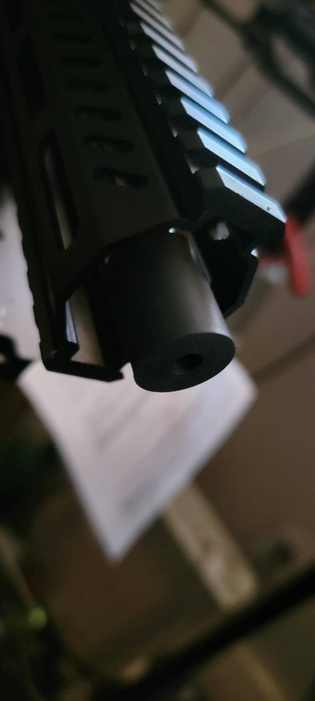

Did you fire it at 130 before firing it at 115? I'm taking it to the range for the first time this Sat, and have a hunt scheduled in a week -- it's still louder than I would like with a 350mm shroud on a 250mm barrel and an after market insert -- in fairness I am dry firing though.
Trying to figure out if I want to mess with adjusting the reg or not on Saturday while at the range.
I would be interested for sure, nice of you to want to share! - we do have a Leshiy 2 - 3D print tread going so fell free to post the file there when you have finished your design
