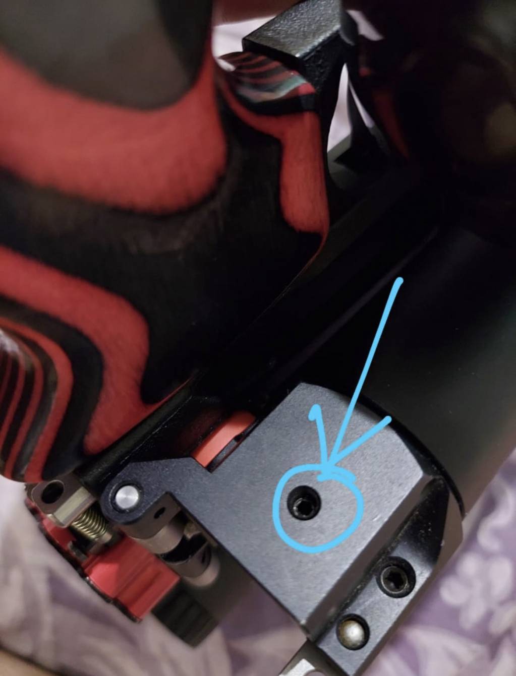

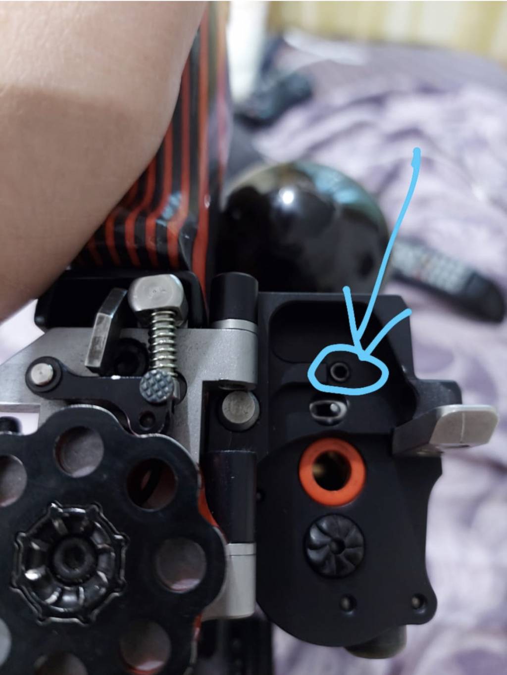

Also after following some instructions I received from @raxim777 to adjust the stopper screw on the breech face. I now have a noticeable difference in sound reduction using the moderator insert.

First loose in the bottom setscrew and Insert a empty magazine. Then you have to slowly unscrew this stopper screw a little until your L2 stops firing.
Now start to twist it back in very slowly, just a little bit, until the moment when L2 will shoot, you need to catch this line between just won’t shoot and already shoot, as soon as you get it the L2 moderator insert should be at it quietest, then tighten the lower set screw it holds it.
This is similar to how I have always adjusted the triggers on all my EDguns. Adjusting to a point of known reference adds value. This is a good repeatable procedure. Thanks for sharing.

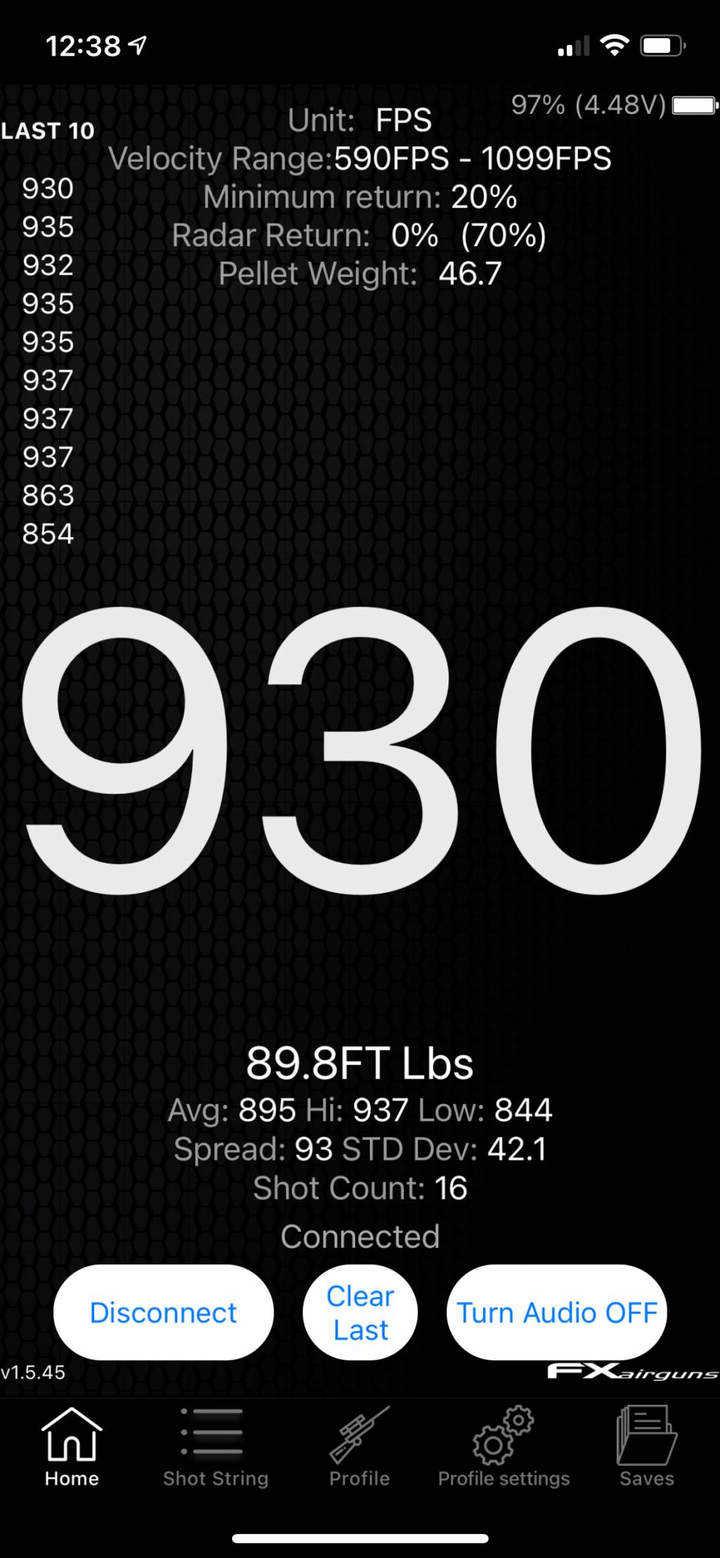

I've been messing around with some high power .30 tunes with my 450mm barrel. I've got a 480cc bottle with extended plenum and rear air tube.
Stock setup (top) vs. extended tank and butt setup (bottom).
Tune is 160 bar on the reg. The bottom shots (850 fps) were with 0.3mm/0.3mm nozzles from the .25 setup. I went down to blocked/0.2mm setup and HOLY CRAP 90 FPE with the H&N 46.7gr pellets.
Pretty nice! Would love to have two guns. So to clarify, the first two shots shown at around the 850 fps were still in the phone from before you changed to 160 bar/ 30 cal/ single .2mm jet? Also how many shots did you get with that set up before coming off the reg? I have the 600mm barrel on and went to it from 450mm because I wanted over 900fps and could not get it from the 450mm barrel.
Correct - shot a mag with my .25 settings and then changed the nozzles. It's a bit of a rough shot at that power level to be honest - hard to keep the gun still.
What I forgot to mention was that with the larger plenum I'm getting almost 8-10fpe more than the stock plenum in the higher power ranges.
I'm going to bring it back down to around 80fpe where I think it will be more efficient with the air. For reference when shooting the 850 fps I was using about 22-23 bar per 8 round magazine. When bumped to 90 fpe it took 50 bar out of the 480cc bottle just to shoot one mag - so definitely very air hungry setup.
I dropped back down and tested with a 0.2mm/0.3mm combo and also a blocked/0.3mm combo.
0.2/0.3 - JSB 50.15gr pellets - 875 fps - 85 fpe (~24 bar per mag)
Wait for the next one - blocked/0.3mm - JSB 50.15gr pellets - 920 fps for 95fpe! (~28 bar per mag) This is a nice tune. Shot cycle is still smooth. I believe with the larger plenum I was just blowing a lot of air with the blocked/0.2 nozzle setup.
