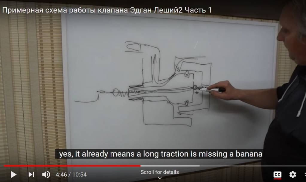

Ed’s video was made in July 2020, long before most of us received our L2’s. Does anyone know what the indexing fix Ed was referring to? It seems the indexing problem is still happening and plungers are still breaking.
raxim777 thanks for the translation and giving background on the person in the video

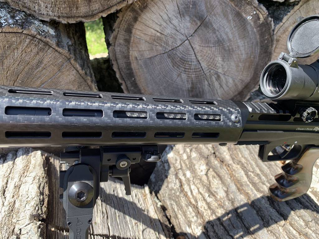

Mine came with larger diameter than the mags, very easy to peel of, never used any magnet
So maybe you got the newer back plates?
Yes could be - received mine 8 of january

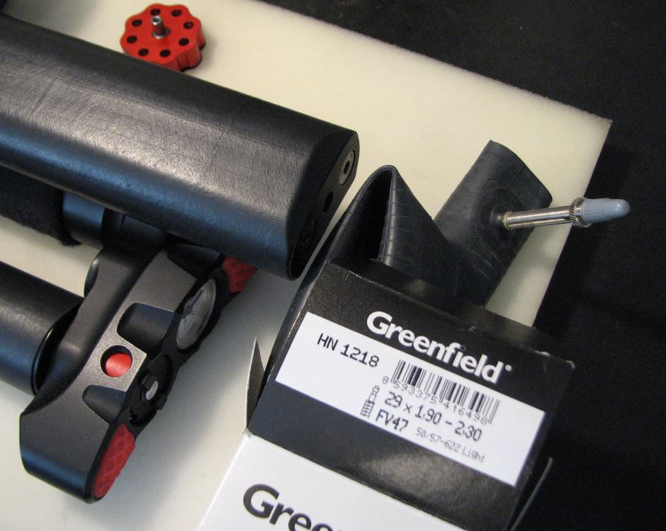

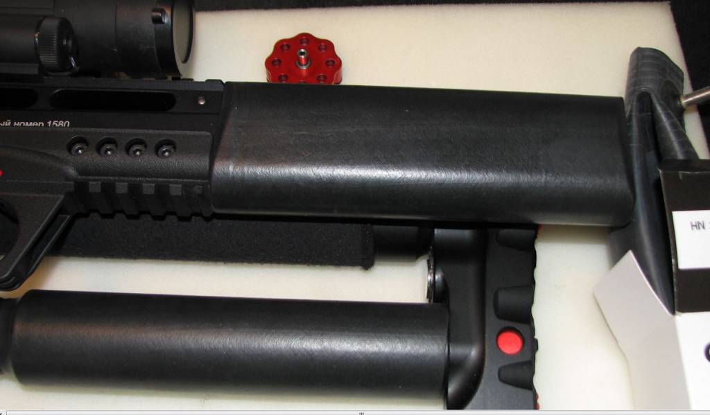

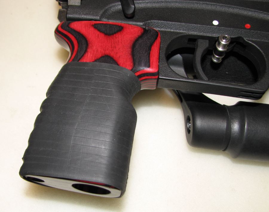

BTW, to protect the moderator and air tube from scratches and the cold aluminum sucking heat from hands I dressed it with bike tubing, also added to grip to give more volume and a non slip surface, not dressed the upper tube yet but may use the valve part of tube for the option of pumping up to correct cheek weld :)
