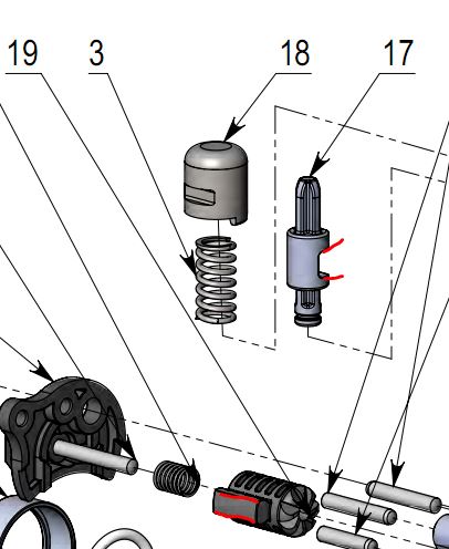

Well, my solution to add a washer behind the spring in the R2D2 may not be the final solution to the indexing problem for some, but it's fixed mine for over 3K rounds so far. And now I'm thinking that the extra spring pressure from my washer, may also prevent the R2D2 piston from breaking, by softening the blow.
I meant not a final production solution
Preventing plunger (piston) from headbanging the tower and break - agreed, I was thinking of shortening the plunger so the spring would take the blow but that would allow the plunger to move higher, possibly damage the contact points between plunger (17) and racket (19)
...so shimming the spring if shortening the piston might be the right thing to do
or just change the plunger every 3599 shots, its no biggie
Ok towle, true that the washer may not be a production solution, but changing broken parts every 3+4K shots is not really a good production solution either. At least not for a semi auto that goes through thousands of rounds in a very short period of time. Heck, I've shot well over 3K rounds in just six weeks of ownership without even trying. So could mine be getting ready to break too?
I think the solution is using the proper material to withstand the forces of the design. IMO, the piston and maybe the rotary gear...parts 17&19, should be made of something like titanium or some other material that is up to the task. Then provide an upgrade to existing models.
I'm not bashing Edgun here. I love there guns, and I currently own two now. The indexing design is truely genius in my opinion. Just needs some tweaking. JMHO.
My L2 has more than 6500 shots already, I haven't changed the details in the drum translator yet...
Good to hear! - could be yours is different, martin had the exact same failure with the plunger (part 17) as I had and it was made of same black material, rs72's plunger on the other hand was made of white material, its all down this tread at page 90

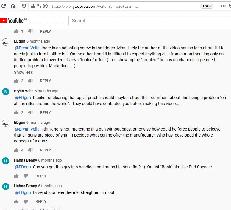

Complaining of anything Edgun seems to be he's thing - he seems to be complaining about how the barrel is not secured in the frame, that only 2 of the 4 screws is pinching the barrel - and then goes on pushing his own moderator version without the moon clip, brilliant! - the moon clip in the front of the barrel is there for a reason, to make sure the head spacing is always correct, if not, the mag may drag on the breech face, make it harder to turn and wear out the indexing system faster, but hey, he got a box full of spare parts for that!
Here's a screen shot from the comment section from one of his other videos where he rant about the trigger, had no idea how to adjust it

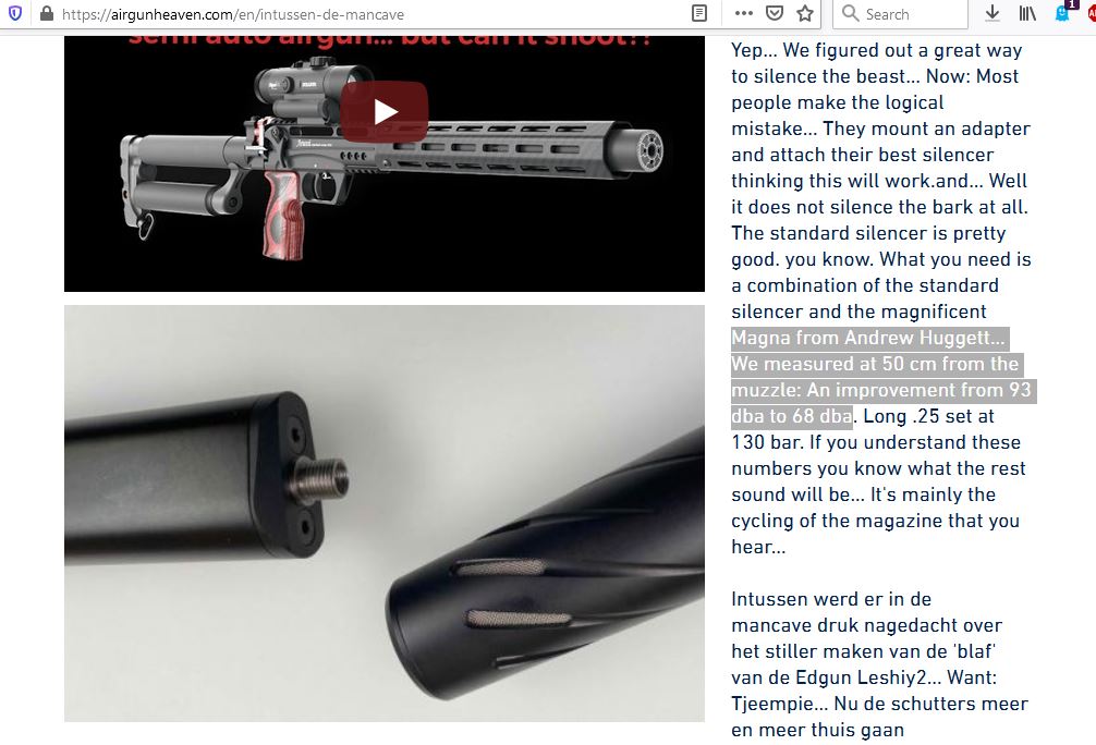

so you got a sound reduction of -28db by just redesigning the insert - airgunheaven on the other hand got less (-25db) by adding another moderator to the original one and make it unnecessarily long :)

https://airgunheaven.com/en/intussen-de-mancave

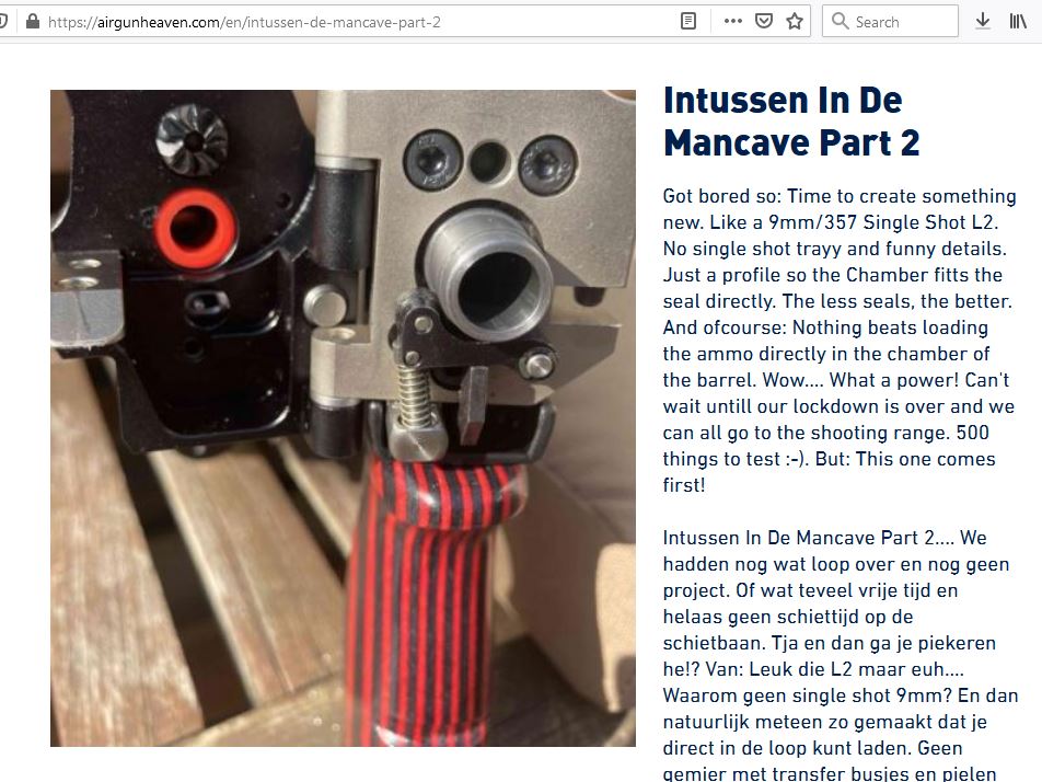

Another fun thing from airgunheaven:

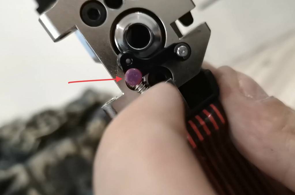

))) in the photo, a red plastic mask is glued on an elongated rod, we do it ourselves in order to make it easier to bend the drum roller with your finger, when you return the drum to its place, this is done simply, take a drill with a diameter of 2 mm, knock out the old rod it also has a size of 2 mm, and insert a longer rod made from this drill, but not too long, so that it would not interfere with laying out L2 and leave everything so ... PS If something is not clear, I apologize to communicate through the translator....
