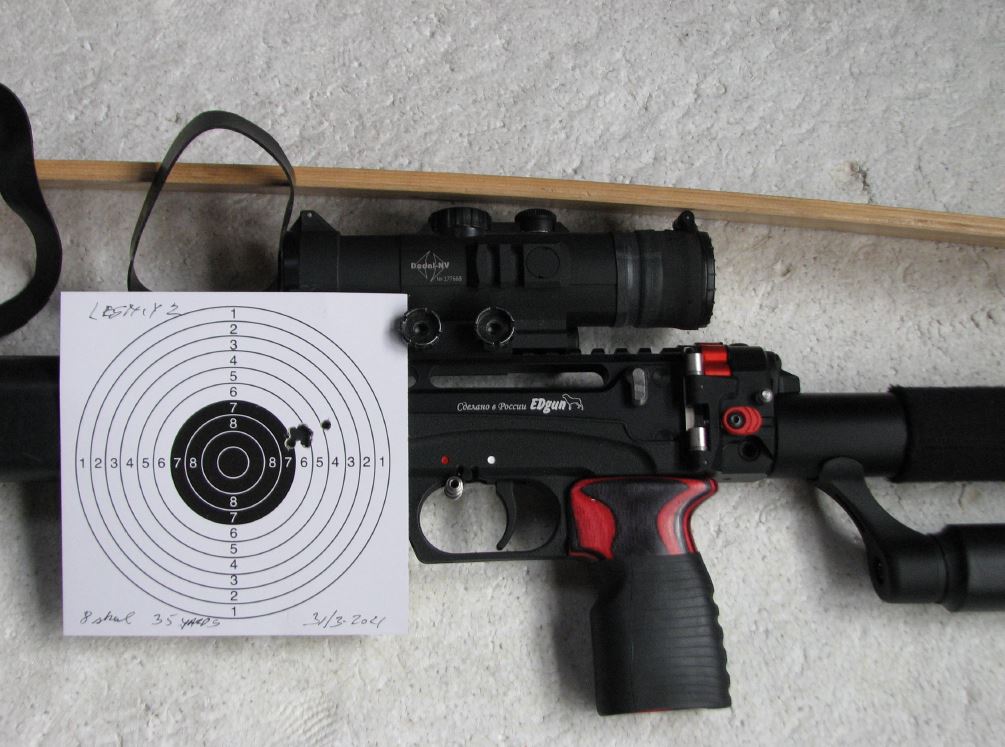

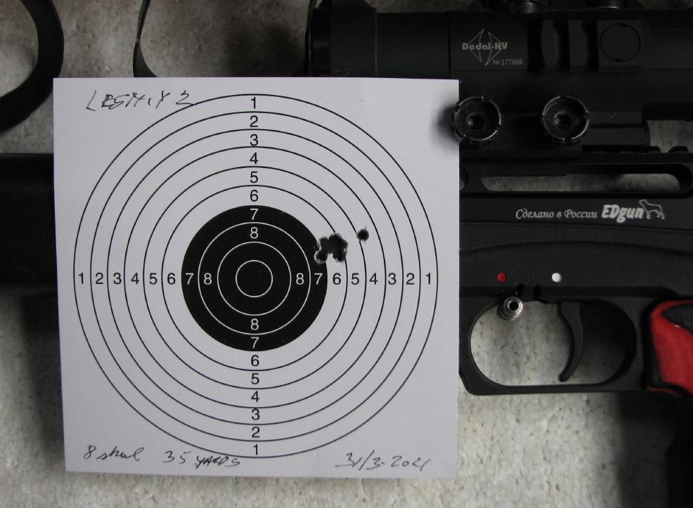

Thanks! - wish I could do this all the time but it was one of those rare direct eye and mind to trigger control moments without my ego interfering
This (the center bull) shot yesterday is kind of embarrassing, not the group size as such but the average center of the group, this shows my ego interfering, squeezing my hand and pulling the shots to the right - small groups is nice but shot placement is paramount

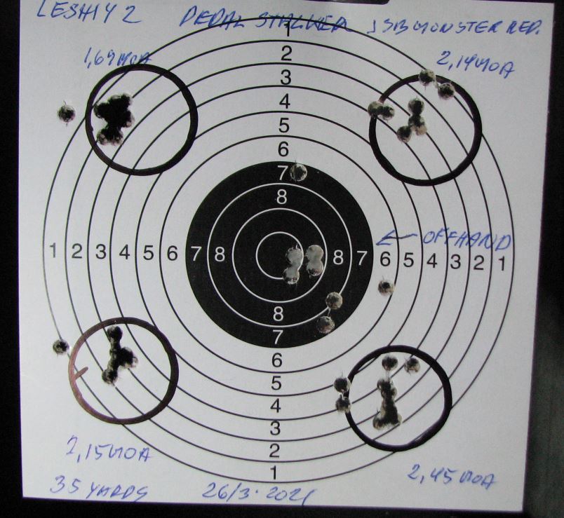

BTW about the bench accuracy at 35 Yards of my Leshiy 2 in .177 cal, 250 mm barrel shooting JSB Monster Redesigned now at 862 fps
The average of the last 400 shots is 2.17 MOA, smallest was 1.12 MOA, largest was 3.03 MOA
I consider that to be very fine accuracy for a light weight short barrel take down semi

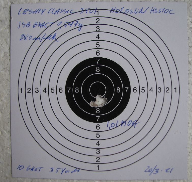

Nice shot string! - and yes those HS510C's are nice, this is a indoor 35 yard 10 shot group from Leshiy Classic with the Holosun
1,01 MOA center to center
