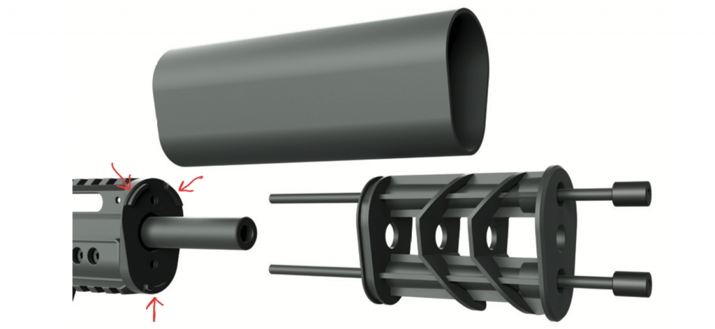

you are applying leshiy classic thought process though (i.e. only a barrel)... you have a moderator and longer barrel that you need to get with L2. The moderators on the L2's are not a an empty tube... it's a legit moderator (as you can tell from videos). More info I think soon on caliber kits... which would also need to include magazines.

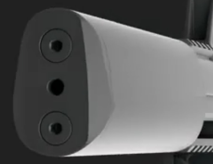

I wonder if the moderator can be flipped upside down like a M16/AR15 triangle handguard without clipping. I think it will be more comfortable having the wider portion of the moderator on your palm for offhand shooting.
Moderator flipped upside down...
Don’t think so based on this photo here.
