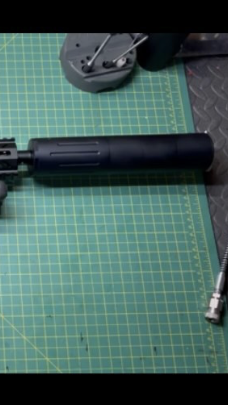

I have the Leshiy 2 in 250mm barrel in .22 cal, the nozzles came with .2mm on the inside and an untitled one on the outside. The reg is set at 130 bar. I don't have a chrony to test with but remember in the beginning there was so much air coming through that it was popping my locking mechanism open. Krale fixed it but the jets were not changed out. I just ordered the .25 cal 350mm barrel kit and was told to get a .6mm nozzle and a plug. Does anyone know what size the screw is to plug one of the holes?
https://www.amazon.com/gp/product/B07DVM7DHL/
M4x0.70

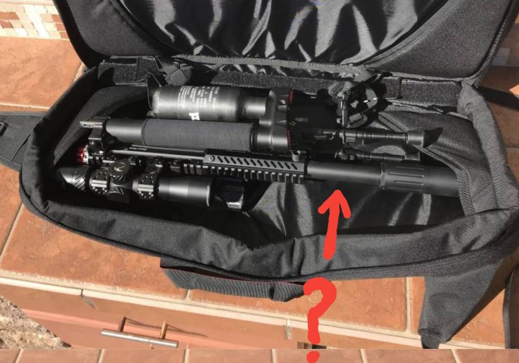

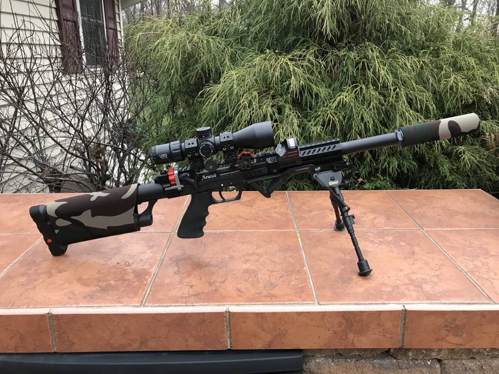

Nice setup, including the bag. What is this section on yours? Is it the rear shroud from the Valkyrie moderators?
it is the shroud off the Valkyrie ShoPot kit 450mm. I have both Valkyrie ShoPot kits for 350mm and 450mm barrels. I decided I would just run both length barrels with the 350mm forearm and save the time changing out the forearms. The Huma moderator bottoms out on the shroud and I have no problems with clipping. If you use an adapter like the Eagle Vision the shroud will be about 1/2” short but all you need is an o ring on the end of the barrel and slide the shroud forward over the o ring and it looks like it is attached to the moderator. I have the 11” carbon fiber forearm coming this week to try with both barrel lengths . The Huma 40 fits inside of it so again I can use one forearm with both barrel lengths and one moderator. Wish I had waited and seen how others had set there guns up like before I bought both my forearm kits with moderators. Hopefully I can move them off to someone who can use them.

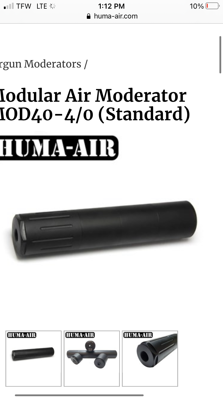

Thanks Leatherman. I have both the Huma MOD40 and DFL Shogun. Both are about the same length with 1 baffle section removed from the MOD40. So far, to my ears, the MOD40 is a little quieter than the Shogun but I think the Shogun provides better accuracy. Granted I'm only testing accuracy at 27 yards which is my zero range. I'll try to push out to 50 yards when I have a chance.
Other than EDgun West is there another source for the MOD40 stateside? Specifically if you want to get the an extra section or two? Or does one need to buy direct from Huma?
