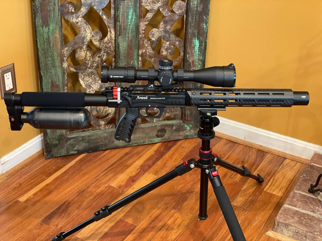

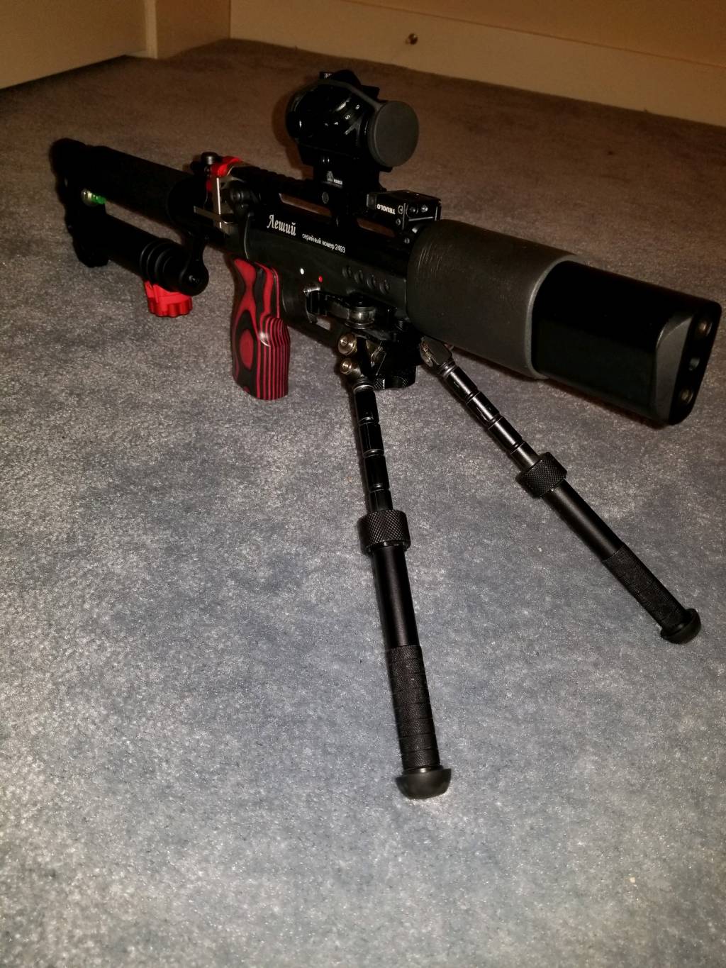

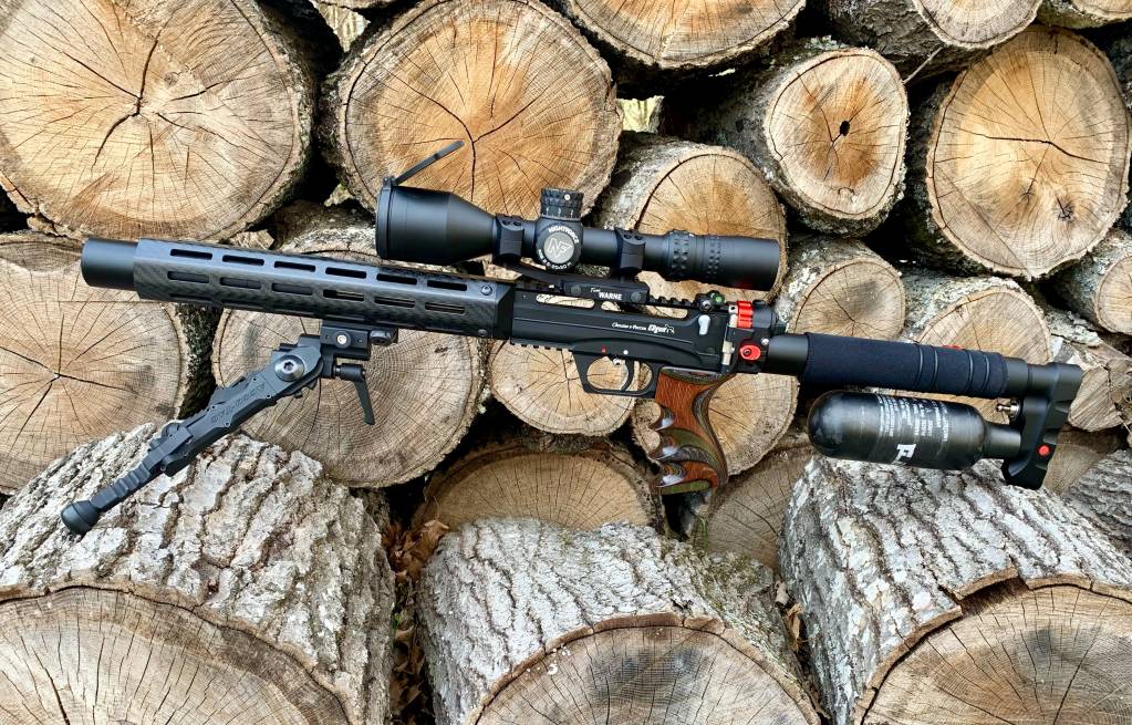

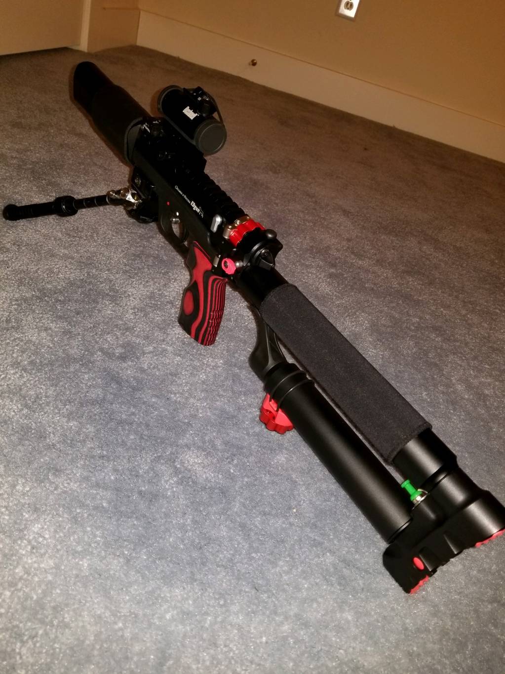

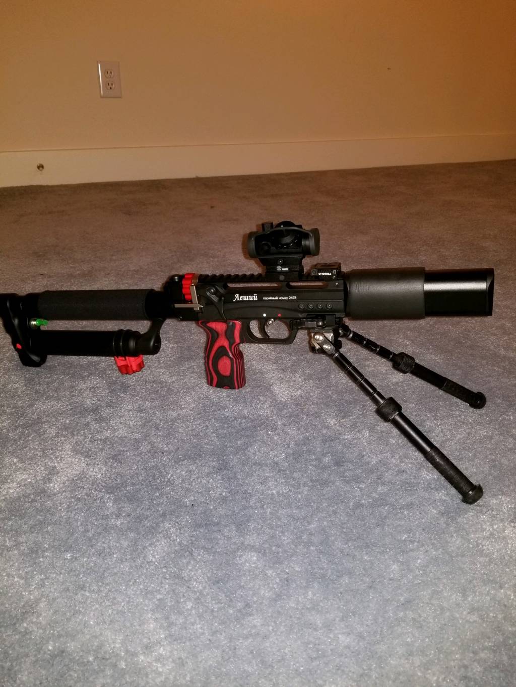

My Leshiy2 has become my go-to gun. I swapped the Stalker with the NX8 for a bit of long range plinking after seeing the posts above and have decided that the Leshiy2 can actually support a little bit bigger optic. I will shoot it in this configuration for a while. This is a .25 350mm shooting 34s at 810fps.
Joe, what jet/nozzle combination do you have on yours and what is your reg set to?
Yours looks almost like mine lol. Almost.
Seeing the NX8 on yours is why I decided to swap scopes on mine... that and the accuracy discussions😂 I wanted to see what it would do👌
Mine is set up with .4/.5@135BAR. I am waiting on a replacement chronograph as my current one was left in the rain and is now “under the weather”🤨 It is shooting right around 800-810 and the gun is very sweet shooting. I have not yet figured out the tuning of these guns. It does not seem to be as predictable as a math equation... YET. It is shooting really well so I have not been inspired to tinker.

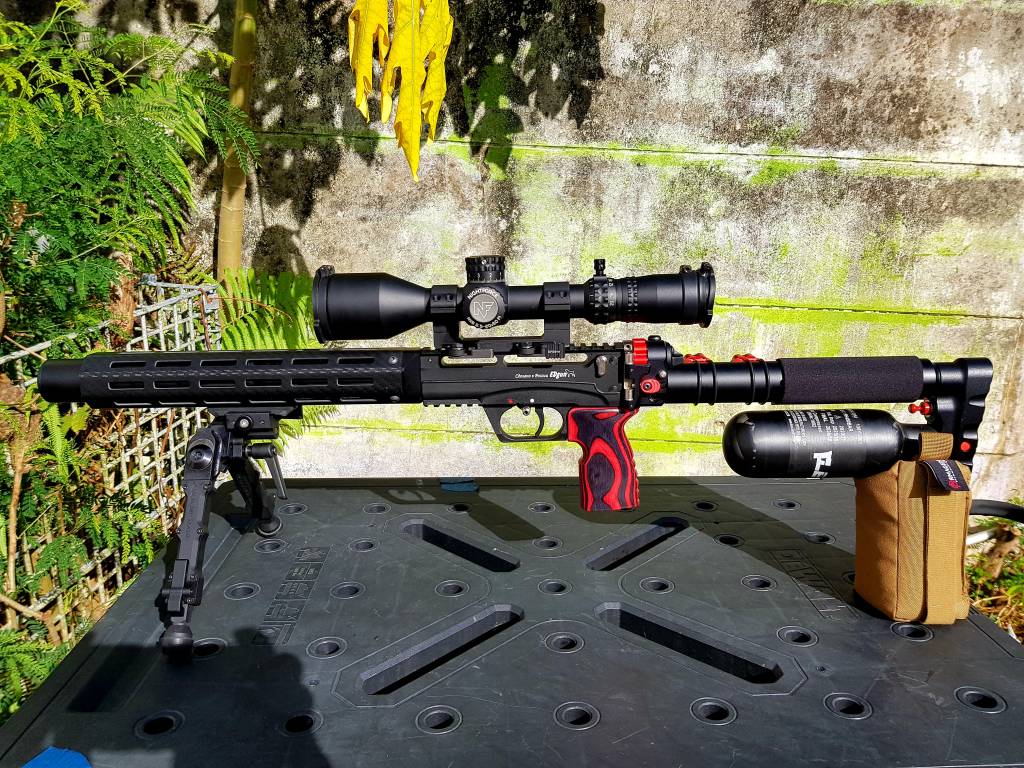

Interesting that everyone’s L2 has come with slightly different settings. My .25 350mm came with .5/.2@125BAR shooting 34g at 805fps

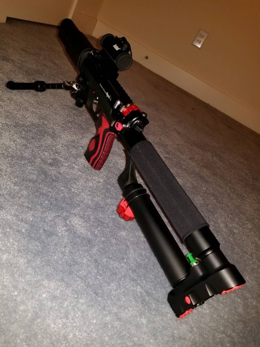

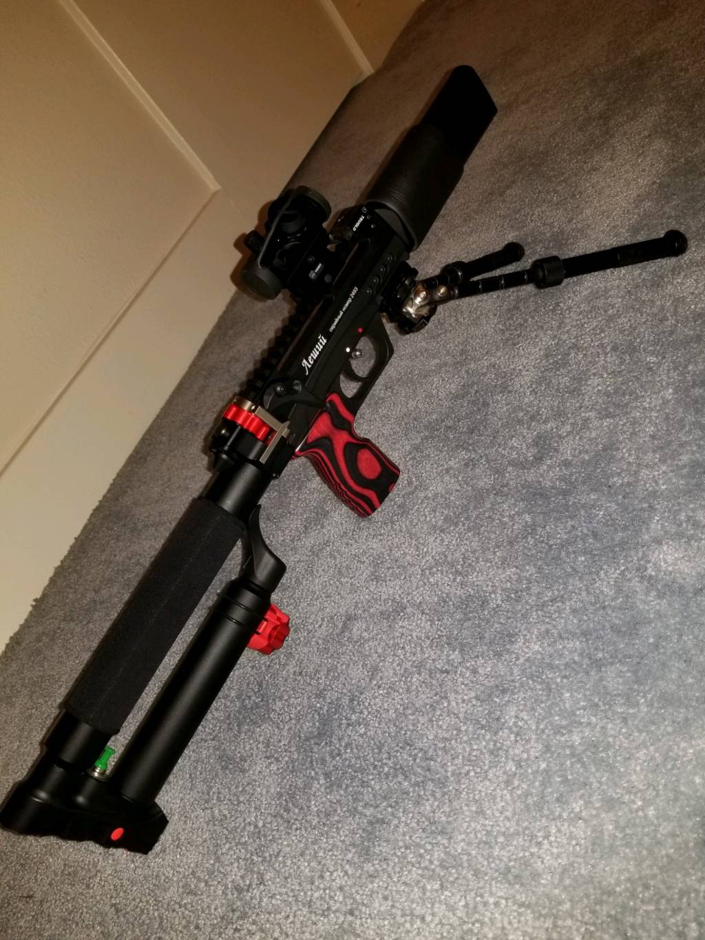

My preorder number is 1165. The grip I mentioned is the redesigned one Ed did a video on a few weeks back.
Now I see what you mean. Darn I really like the original grip, I wonder if Brian will give us the option of being able to choose, not really feeling the updated version
I also like the original vertical grip. I wish there was an option for one like the Ergo Suregrip in rubber overmold. It sure helps with sweaty hands.
Well there is one being sold on the bay at the moment
https://www.ebay.co.uk/itm/EDGUN-LESHIY-2-GENUINE-ORIGINAL-GRIP-RED-BLACK-LAMINATE-WOOD/265031215634?hash=item3db5176a12:g:mDwAAOSwdNpgHWta

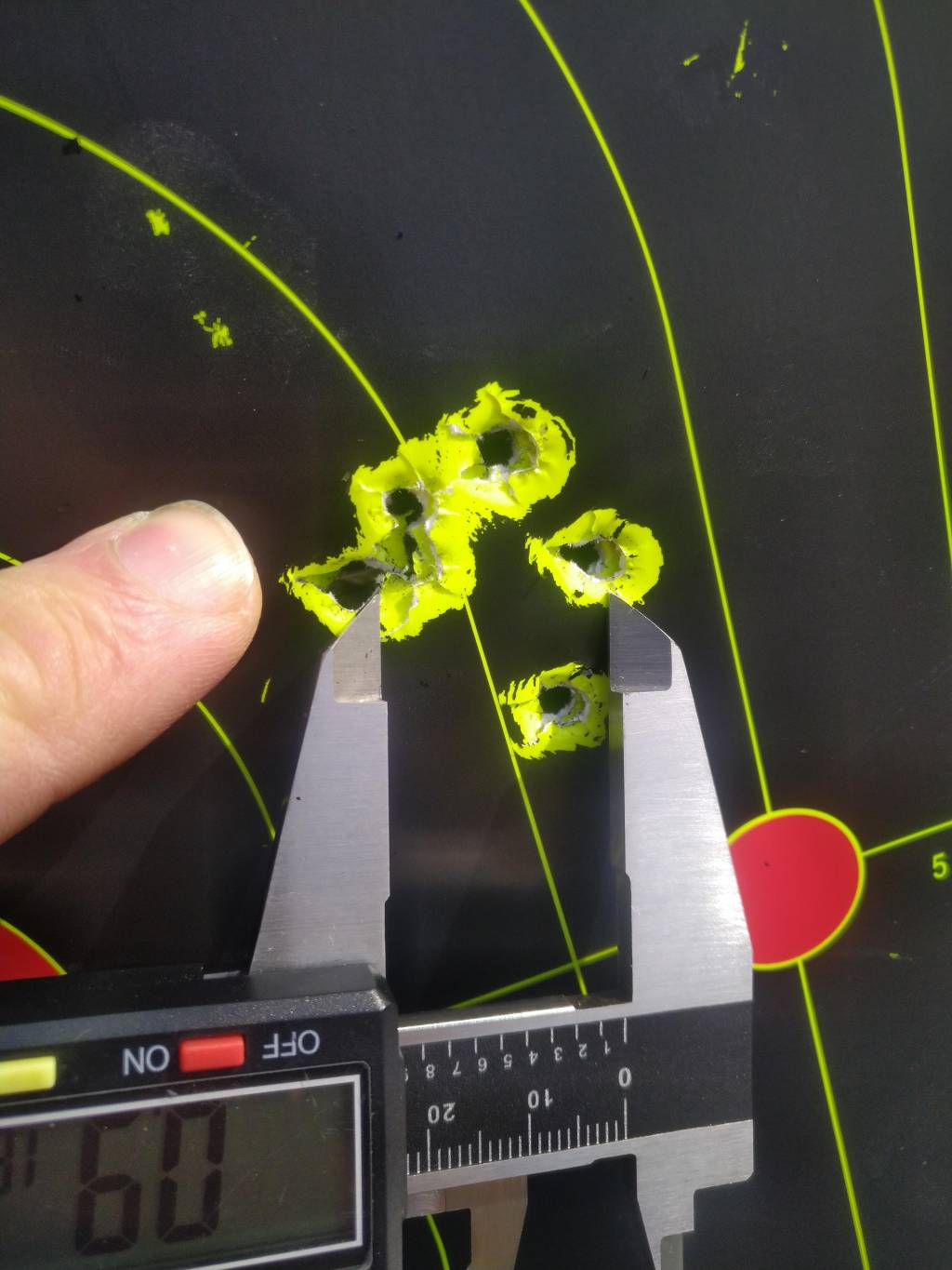

Not sure yet but using the 600mm barrel with .30 cal max power settings unsuppressed appears groups got alot tighter after removing fx chrono and silencer adaptor as CTShooter suggested. I need to do more groups to verify as I shot quickly and the first 7 were about .9 group (first 6 were all touching maybe 0.7ish" and if I took the best 5 of these 6 group would be sub MOA). Last one I hesitated cause it's so loud unsuppressed and it went down a bit to about an inch group at 50 yards. This group was with fx hybrid. Will do more once new adaptor arrives as it's really loud. Going to try some fx barrels though this weekend on the leshiy as I can suppress those. Hopefully adaptor was the issue
I am curious and fairly new to air gun. Noob question, but why use adapters? Why not directly attach the moderator to the barrel and eliminate the adapter if that is causing the problem? I see moderator that comes in M14x1.25 option.

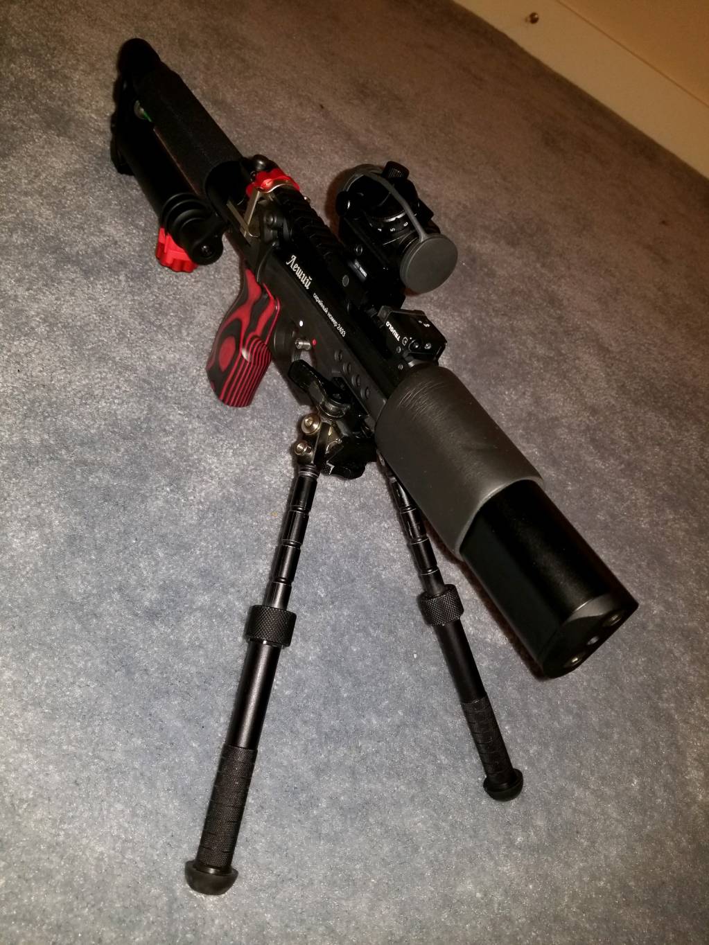

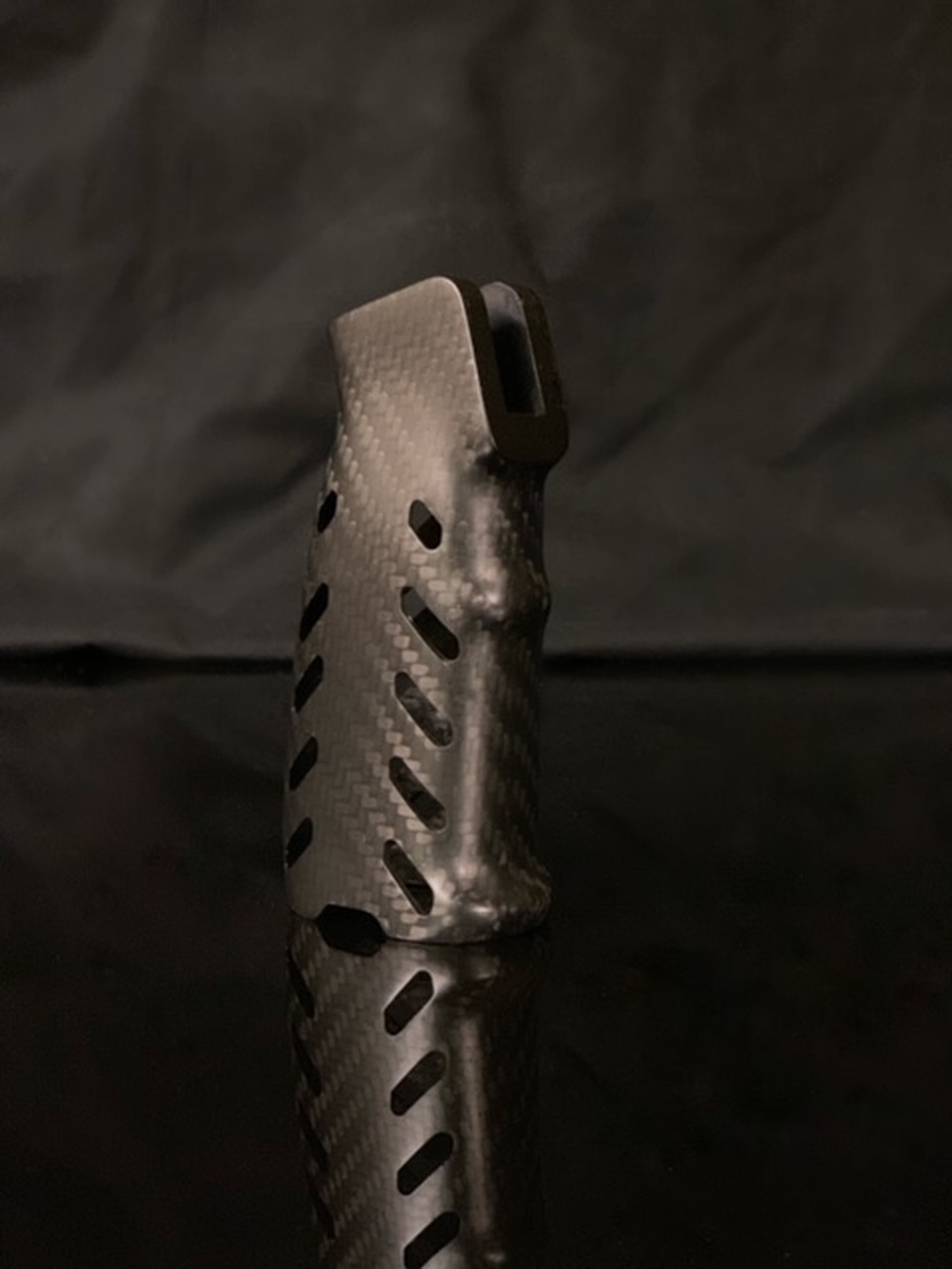

It is the
Smoke Composites Ultra Light Pistol Grip
  • WEIGHT: 32.5g / 1.14oz
  • ANGLE: 18 degree centerline angle
  • MATERIAL: 35-50 Carbon Fiber
I haven’t found the grip to be slippery so far, but it is still winter time so my hands have not been sweating. I believe the holes in it provides extra grip and prevents slipping.
