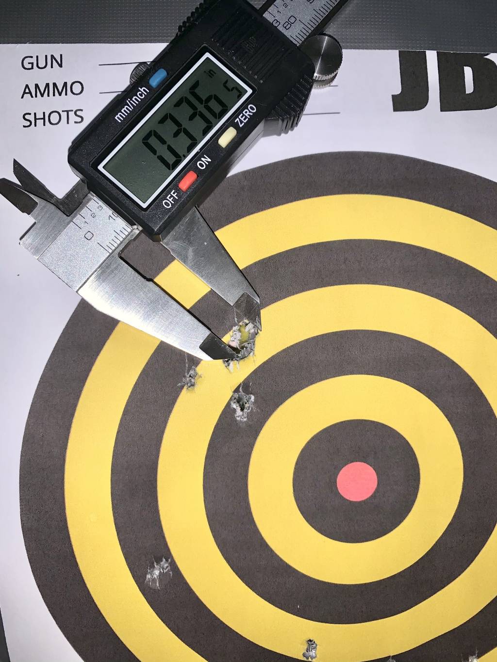

Okay, to continue initial impressions of the Leshiy 2, I got out to my permission to shoot some silhouette targets and try out to 45-50 yards. Sighted at 25 yards
Weather conditions: around upper 30s F / 4-5 C, overcast and eventually light rain. Starting pressure on the gun with the 300 cc bottle was 220-230 bar using 10.34 grain JSB Heavies and shooting at “120 bar” on the regulator. Estimated fps 935ish at 19ish ft/lbs. Shot 6 magazines so 48 shots and so I used about 100ish bar. The 300 cc / 350 cylinder is definitely worth getting!!! With a full charge on the cylinder, 270-285ish bar (300 bar not really achievable with my tank) I figure I could get up to 10 plus magazines. Also, due to the temperature change between the house and outside, I figured I lost a couple of shots.
At 25 yards was basically (almost) pellet on pellet, but one 2 fliers which are basically me. At 35 yards 1/2ish inch with 1 to 2 fliers, again I think me. At 45-50 yards I paced it off, again not exact but the parallax gave me an “accurate distance.” I go with what I got. These groups were made prone.
The silhouettes were set at the same distances and shot standing 25 yards no problem shooting them, 35 yards took some follow up shots, and 50 yards 1/3ish accuracy, but I figure that was me not doing my job.
Summary, after I learn to be a better standing shooter with the Leshiy 2 (and in general) I am have no doubt I can accurately hit a sub MOA target zone with the L2 in .177. Thus, in .177 cal / 4.5 mm the Leshiy 2 is definitely a 50 yard / 48 m gun, but beyond 50 yards would not stretch it (at least with my shooting ability at this time.)
