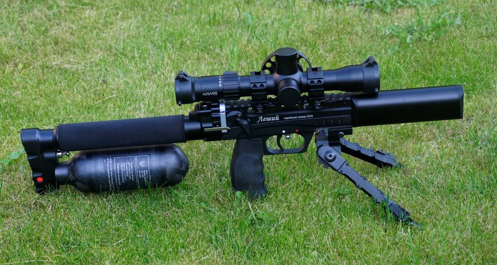

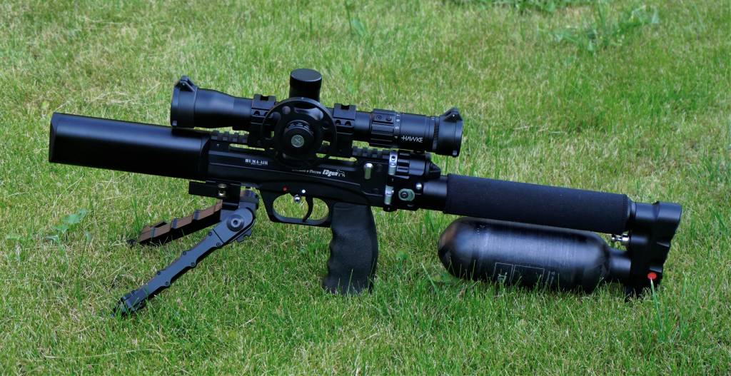

Don't get a 480cc bottle as it will restrict you wrist at the grip.
You could also use this 220cc bottle at a significant cost savings: https://www.ebay.com/itm/363466033910. I used this one for a few months before Brian and Francisco had theirs available.

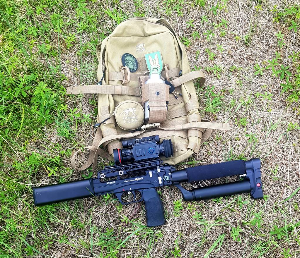

I have the 350 cc Edgun bottle my gun very compact no problem depends on what grip you have on to my gun the smallest it could go i love it Ground Hog :)
@Gelm.Chally - I like your L2 setup - very tacticool! :D You don't find the tank gets in the way of your hand? I've got large hands so it was an issue for me.
Not really the bottle touches my wrist but I don't find it uncomfortable. If I had big mitts I'd have to use something else.

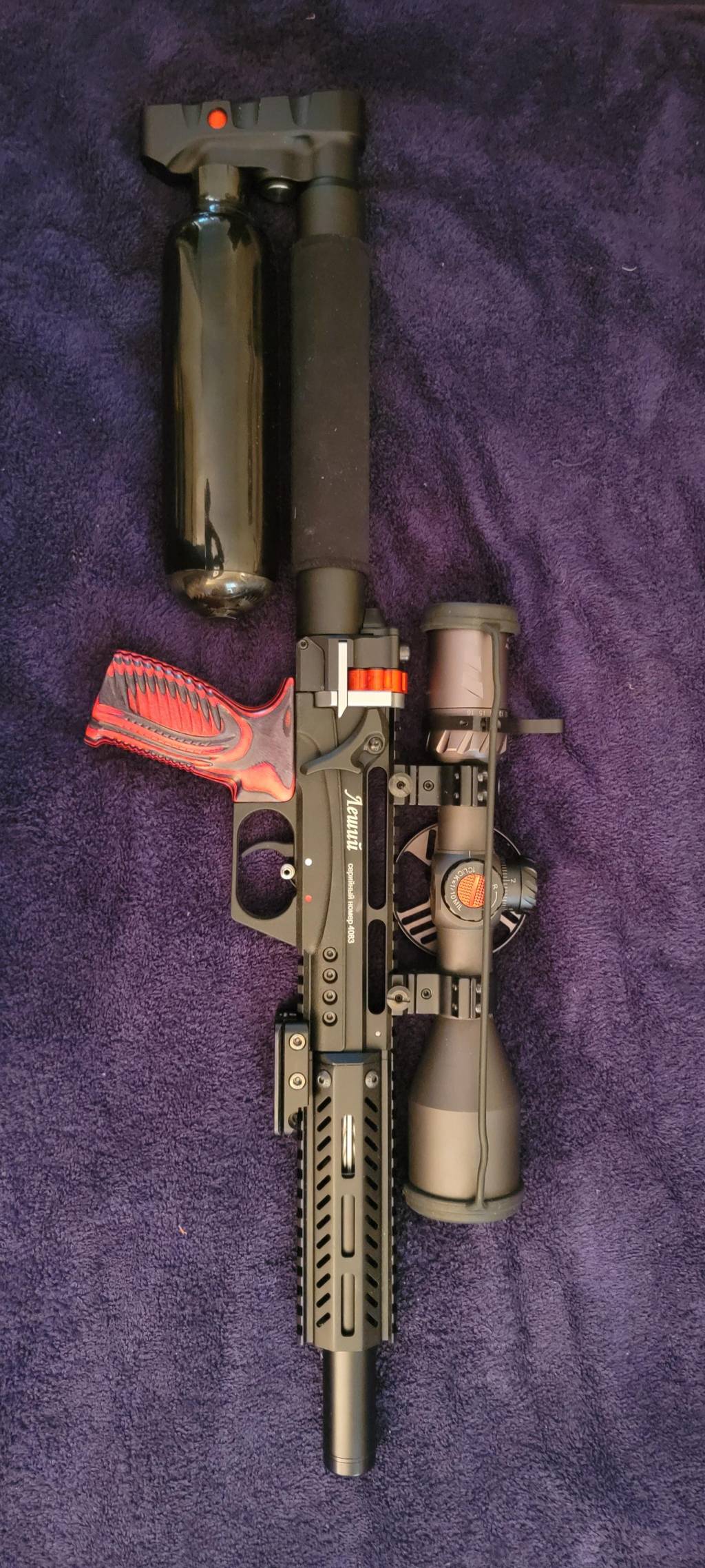

if you fit a grip like this or same angle it will give you a tad more grip room :)
