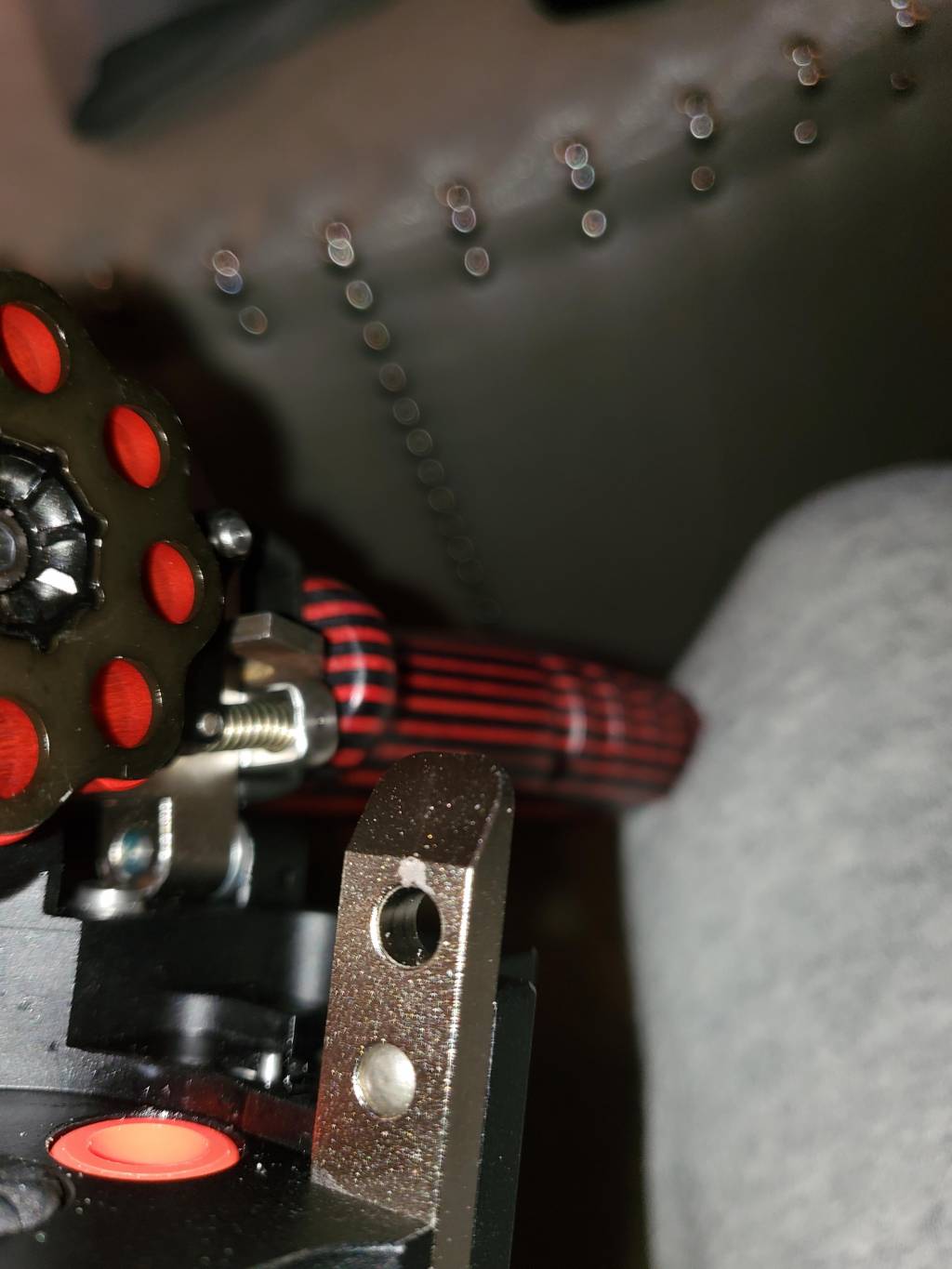

Kinda interesting that my pin is silver? Either way this is my second PCP. I know there will be general issues, but this looks to be one that may persist down the line. Kinda concerned about long term if this is not a diy fix.

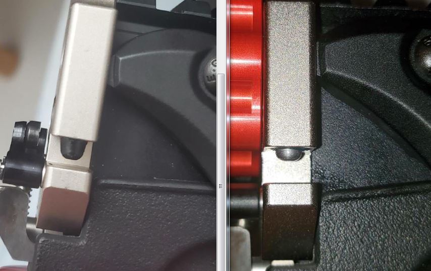

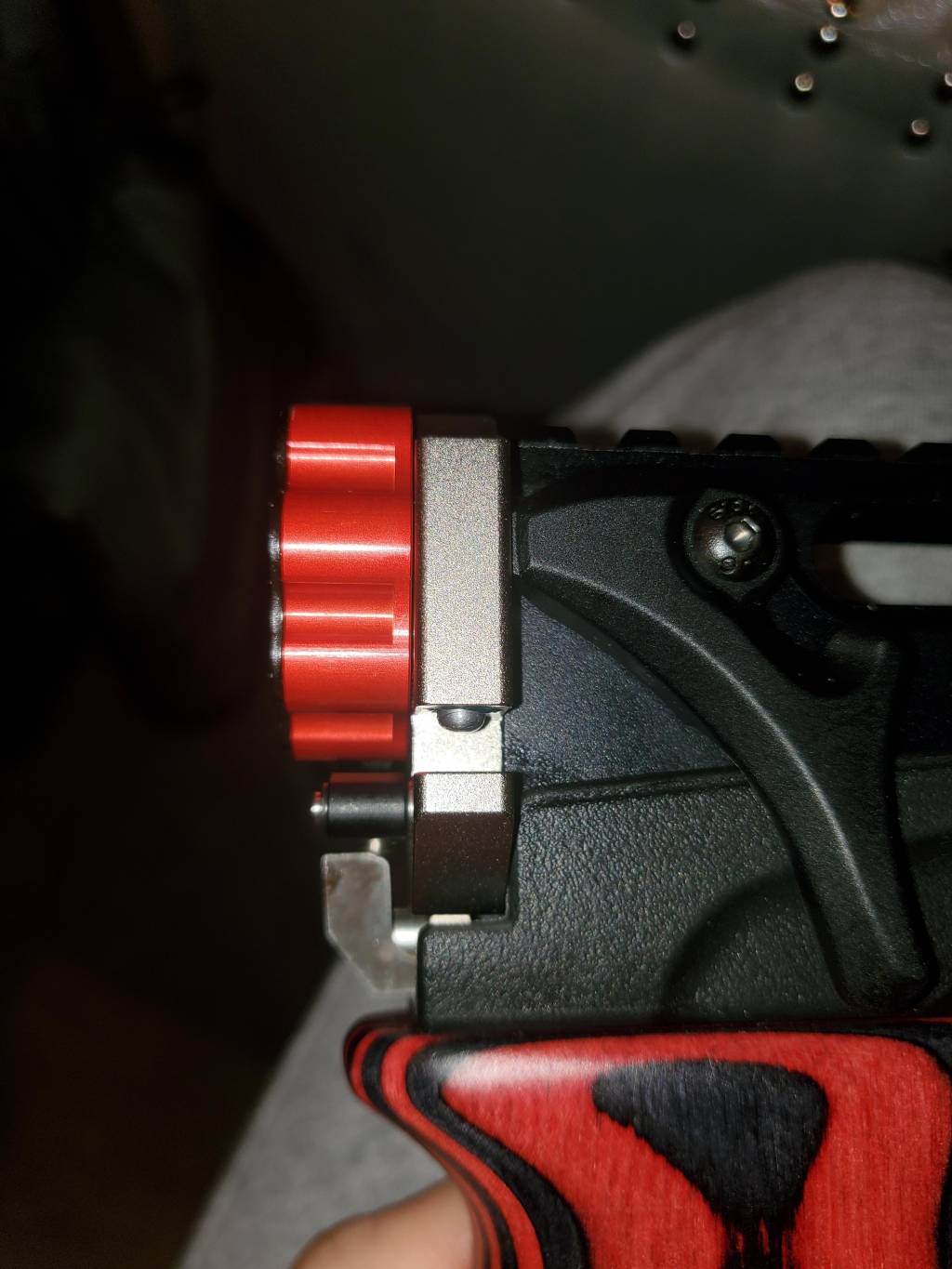

Notice that you pin seems to protrude less than on the picture posted by OP (3.42mm)

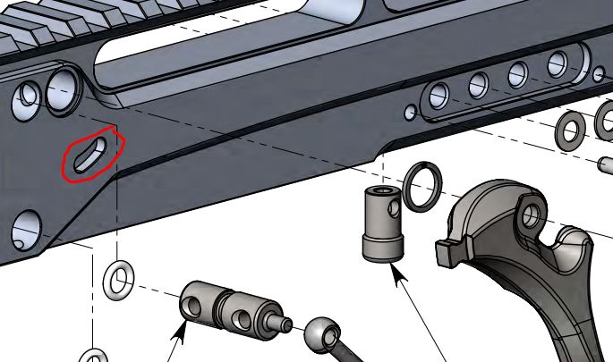

could be a design change, also note that the opening lever slides in a slot in the frame, this slot should be clean of any dirt or the lever may not move all the way and lock the breech

Towie, that was my fault and I did not realize it until now. The gun was in folded mode and the pin sits higher. I should not have uploaded that pic as it is an inaccurate example. Although the pin did return to the normal position when I extended the gun to half folded. The issue is small and Krale will have to fix it. No big deal 🙂🙃😉
Thank you for making that clear - yes, no big dial to fix

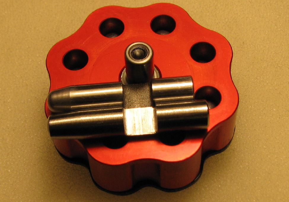

Make a new latch pin with a lesser angle, I'll bet it will solve your problem, as starting material you can use the shank of a high quality 5 mm drill bit or 5mm hand threading tool, 4.49 mm is the ideal size, any machine shop can make this or maybe you can make it yourself
