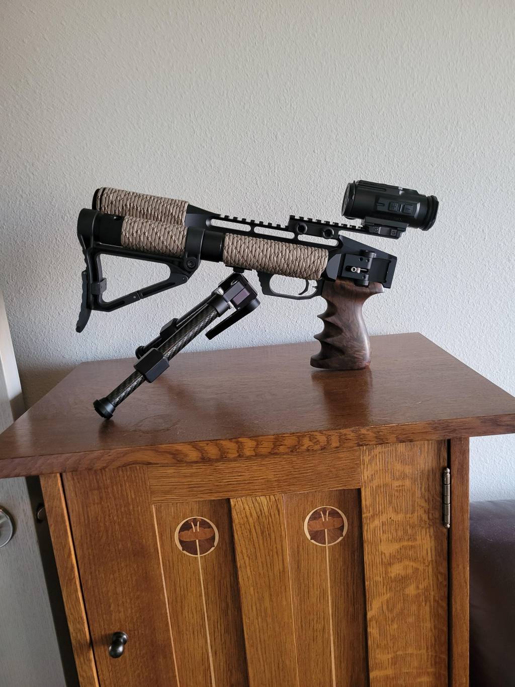

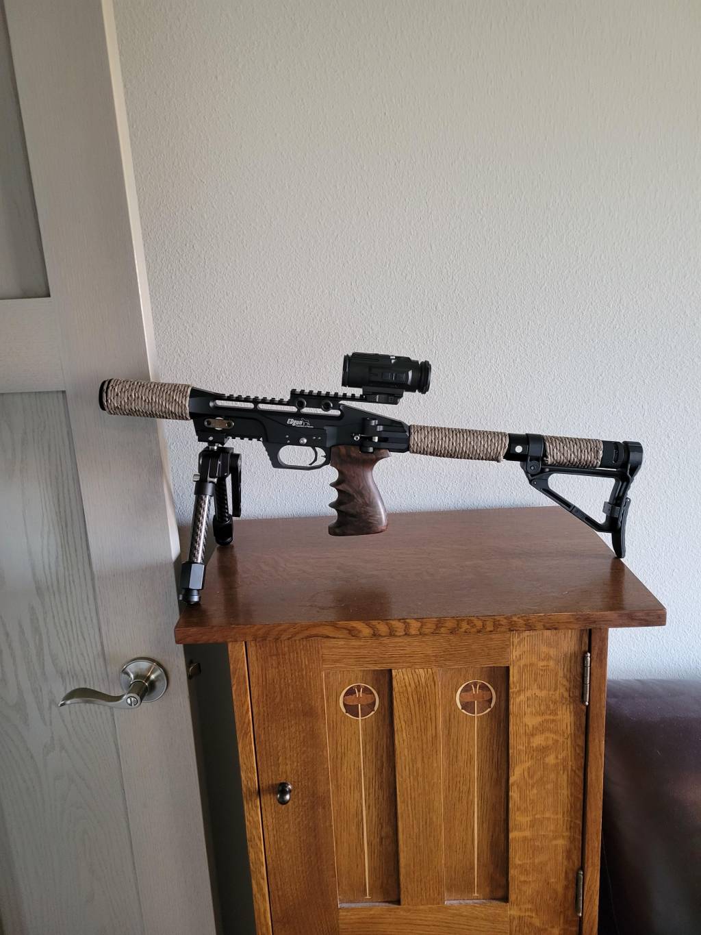

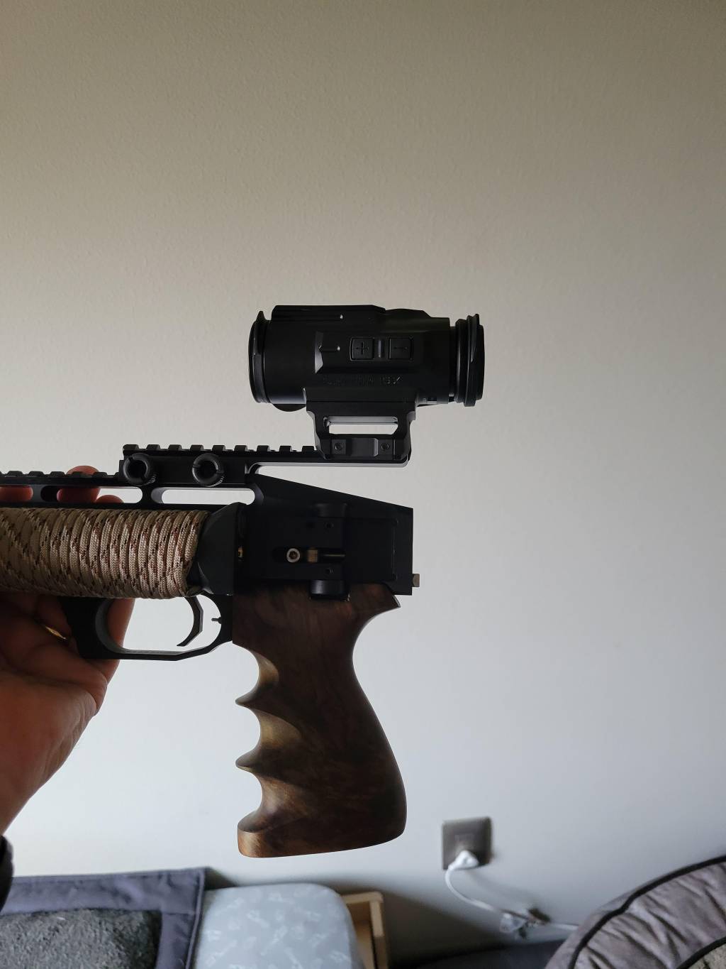

I bought a Spitfire Gen2 5x from a local store & tried to mount it on a Classic Leshiy.
This was as far back as I could get it & it still wasn't far enough. Returned it.
