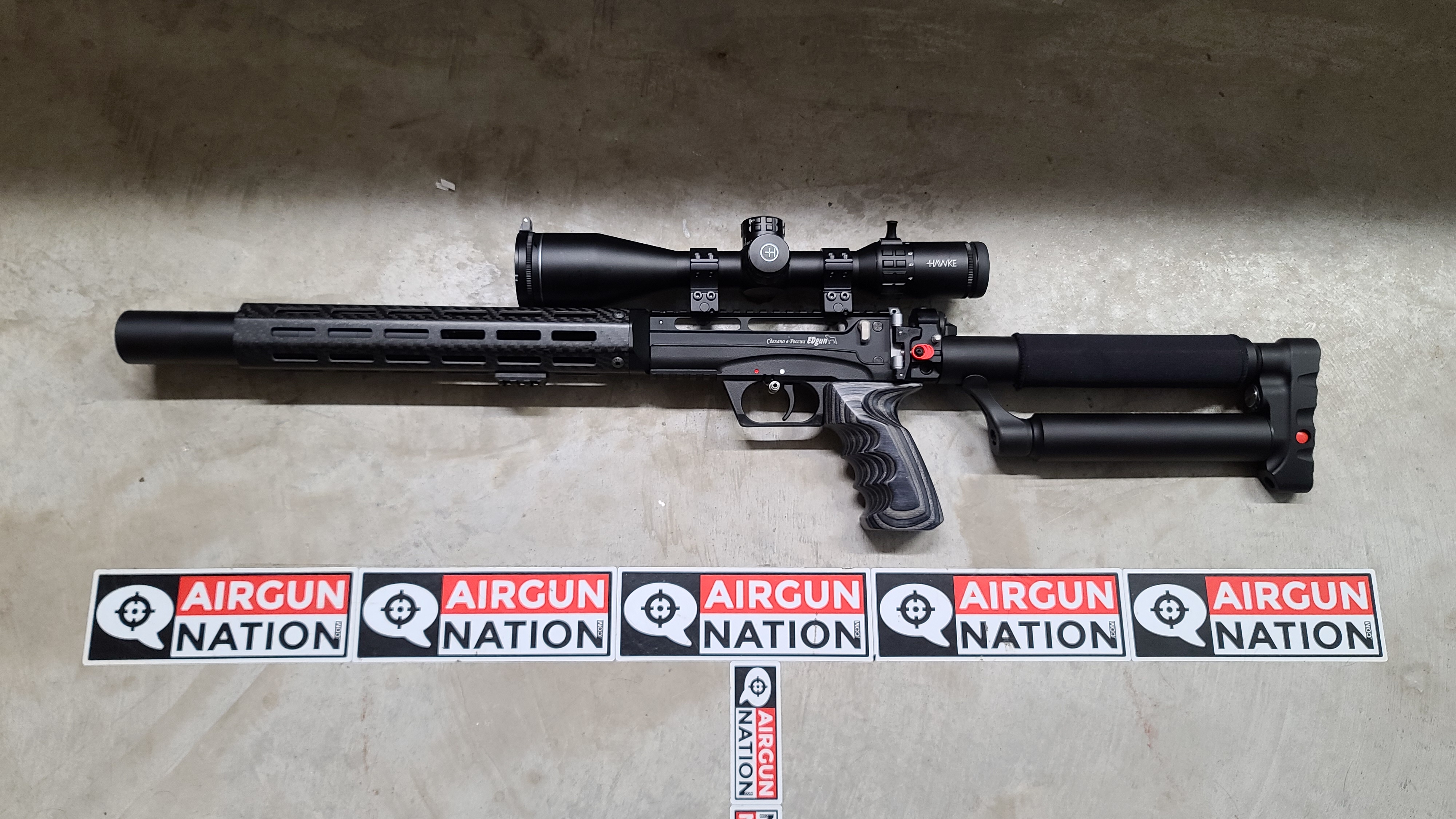

I've got an L2 with 350mm barrel. I was hoping to shoot the .22 25g Monster Redesigns at 975 fps.

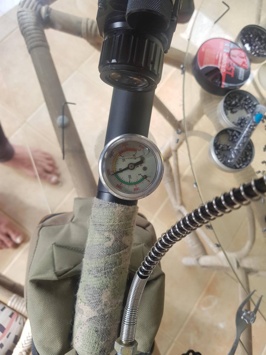

I can adjust the REPR regulator to squeeze out 900 fps but that requires the reg to be set much higher than I'd like (about 190b).

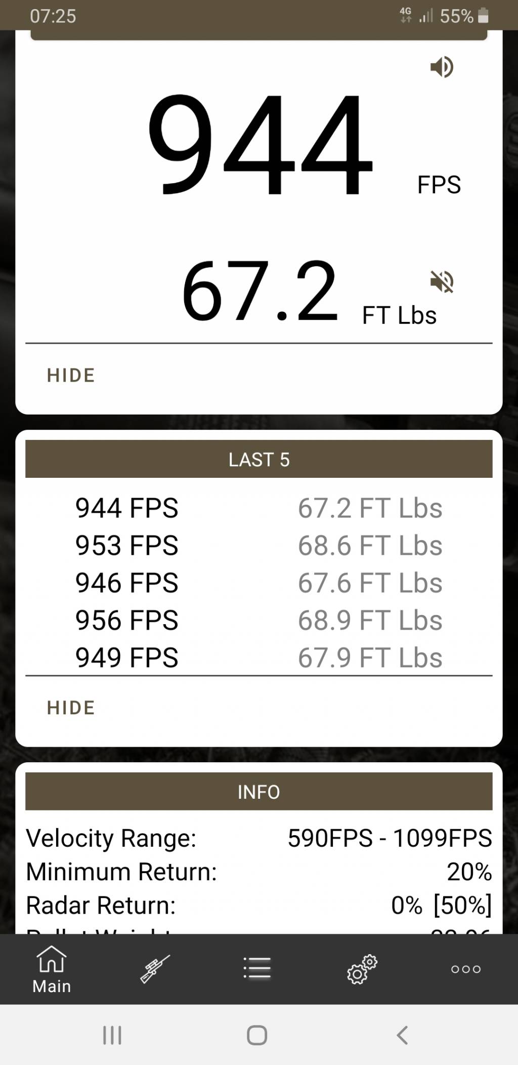

I'll swap the .22 barrel and jet quick for some chrony results.

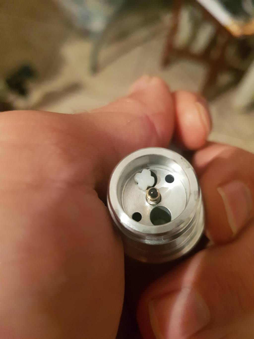

So I just opened it up and I already have 0.4 jets installed. That's how it came to me in .22. Is there a link/instructions to removing the dog bone? Mine does not appear to have a collar.

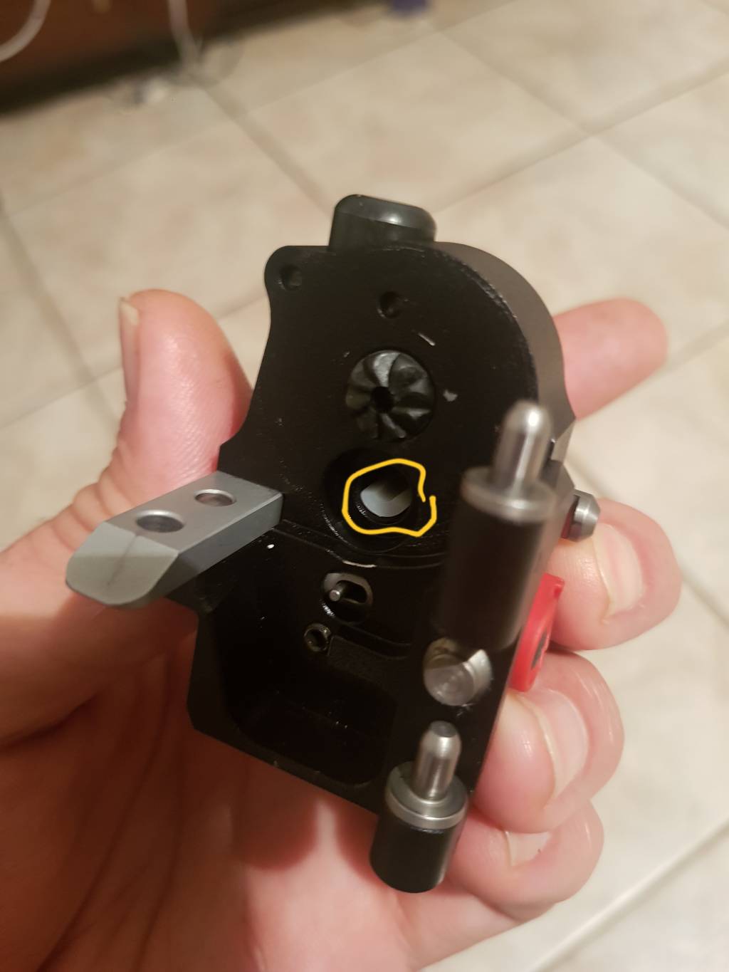

You'll see the collar from the transfer Puck side... Only compatible with the New Forward Plug.
Here's the dog bone when the valve housing is unscrewed
