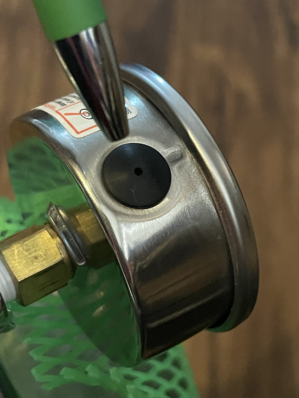

When I'm done using the eazy fill, I close the main tank valve and leave the line pressurized. However, yesterday I walked in to find that the rubber plug on my main tank gauge had popped off and it leaked out glycerin all over the place. Did leaving the line pressurized cause that plug to pop out?

Brand new AirMarksman 9L tank. This is the plug that pops out if the line is left under pressure:
