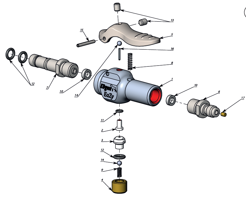

Here is the exploded view....

There's no normal circumstances where mine has leaked, but I have managed to make it leak when I've done some odd things with the unit. When I first got the unit, I threaded 6 in too tight, and it destroyed one of the teflon square rings (10), which made it so the unit couldn't pass any air. Then I backed 6 out somewhat and it started leaking under pressure. So I removed the destroyed square ring and sealed the unit with teflon tape, and it's been fine ever-since.
Those teflon square rings have really tiny holes in them, at least in the first generation of these units. If you overtightened them, they'd easily plug up.
There is one silly case I've managed to make the unit leak -- if you keep it attached to your bottle when you're filling your bottle (as opposed to the gun), it will leak. i.e. you just need to detach the easy fill unit when putting air into your bottle. This is a feature of the unit, not a bug.

I see roughly 4 holes: bottom (where 4 and 11 are), top (16), tank side (6, 17) and gun side (7).
edit: your video is ready now. Looks like gun side (7).
I would remove the quick-connect where the leak appears and re-insert with some teflon tape on the threads, if you don't already have teflon tape on the threads. When you have it out, check the condition of the teflon square ring (10). If it appears damaged, you can get rid of it, i.e. reassemble without it.
If the problem persists with the above changes (or with 7 removed from the unit) I'd imagine there's an issue with the bottom mechanism, maybe an o-ring is nicked or something of that sort.
Thanks!
Ok, it leaks from the front of the gun, at the discharge side. Using tape there is moot - it would only be useful whilst filling to prevent blow-by under pressure. Even the female Foster fitting removed, it bubbles out there, i.e. the leak is upstream of the fitting, inside the main housing. No teflon ring inserted there either - the Foster fitting has a tapered inlet which is not compatible with the seal. O-rings were replaced, no luck. I suspect the sealing flange on part 3 (the tapered area) where it seats in the Alu housing.

Mine developed a major leak from where the brass plug screw in on the bottom. Contacted Edgun and they sent me the orings from the inside to replace. Fixed that major leak, but......

I had an issue where mine was leaking from the front as OP describes. I did try replacing just the o-rings as #12 was pretty flattened out but this didn't fully resolve the issue. Ended up being part #3 had become deformed. I picked up one of the rebuild kits from Brian at EGW and replaced all the internals - this fixed the issue.
