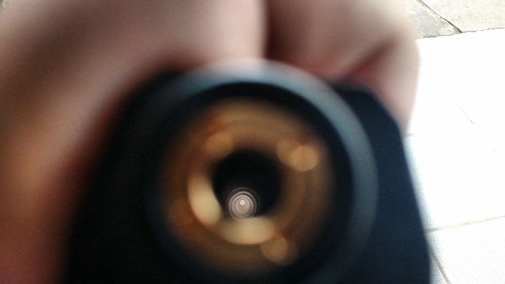

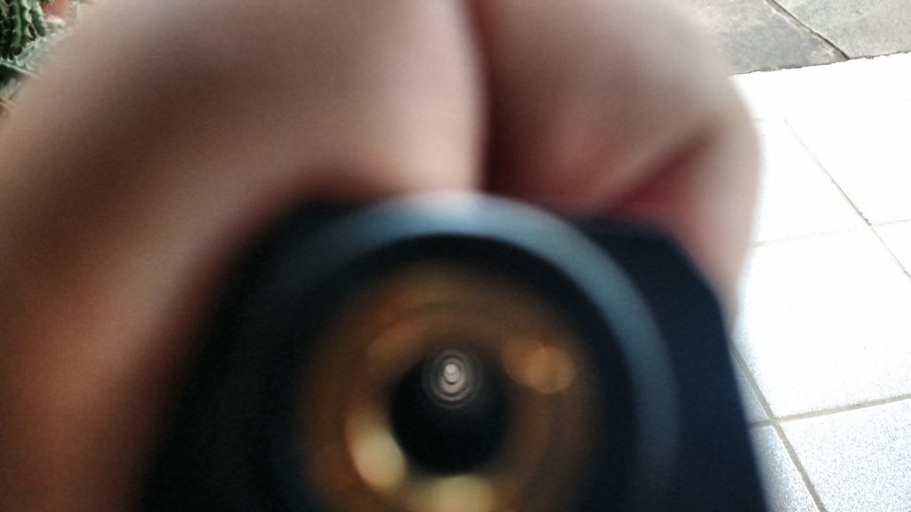

After saw this, I notice another thing, the barrel is pointed UP.
Look the gap from the barrel to the cylinder.
Now, looking through the barrel.
I'm thinking to loose the stress nut of the barrel to see if it made some changes.
What do you think guys?
Thank you!
I'm no Edgun expert, but the barrel certainly looks a bit bent upwards to me. It also looks like this is causing the plane of your scope to be pointed downward toward the barrel. That's likely what is causing you to have to max out the elevation turret on your scope and that can certainly lead to inconsistency. A scope will almost always be at it's most consistent when you can shoot the gun with the scope as close to optical center as possible. For an experiment, you may want to try shimming up the front of your scope to match the plane of your barrel, then rezero your scope and try shooting again. If you can get your scope closer to optical zero and eliminate the fliers you will have found the issue. I'd try that to rule out issues with the scope before trying to adjust the barrel on the gun.
