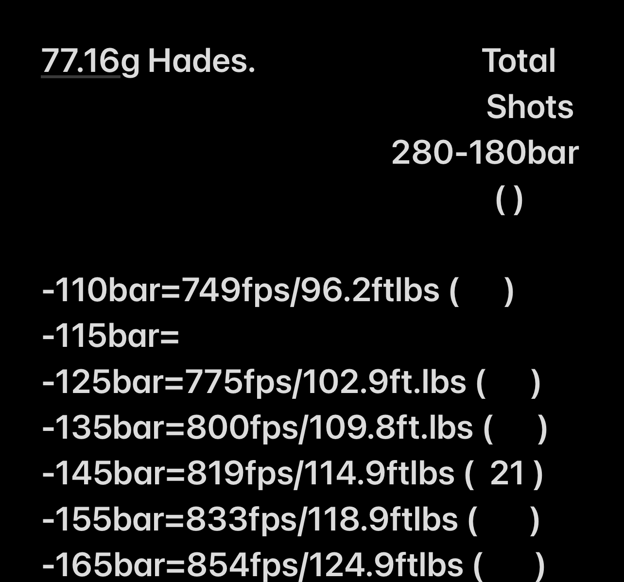

I own both provided you are talking the Leshiy 2 in 357.
Rattler-
-75-100+ FtLbs more then the Leshiy
-louder but not unbearable. More than quite enough for in the field.
-The longest slugs you want to shoot the magazine will handle.(.7875”)
-15 shot non removable magazine
-IMO the better way to go…
Leshiy 2(357) 450mm barrel
- for 357 light on power
-limited on slug length(.429” max)
-very quite with the behemoth(like inside the house quite)🤪
-compact being able to remove moderator and fold the stock for discreet transport.
-8 shot removable magazine
Pic is Leshiy info. Shows reg setting, fps, ftlbs
And at 145bar on reg I was getting 21 shots to a fill shooting the 350cc bottle from 280bar down to 180bar
If your looking to deer hunt I would not classify the Leshiy 2 as a deer rifle by any means. I settled on the hades and it does fine for say smaller game up to AZ coyotes at the 50-60 yard mark with confidence.
The Rattler is a whole different animal and is my go to coyote rifle these days. I would use the rattler 357 as a deer rifle at appropriate ranges and the correct slug and foot pounds of energy. I would have no problem taking coyotes 200-250 yards with the Rattler. Would only use the Leshiy 2 up close and personal in the brush 40-60 yards for coyotes and that’s what I bought it for. Compact/discrete and quiet is where the Leshiy shines
This is just my opinion. Take it for what you will. I have real world crono data on both if you want the info send me a PM
