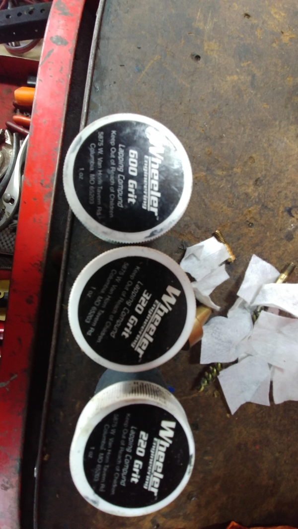

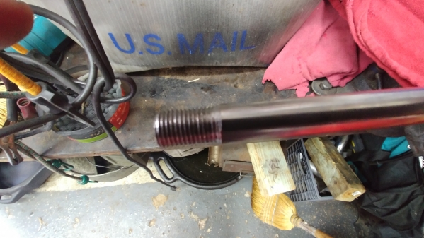

Just read this , This tool just came in today I am crowning barrel as we speak and will get some groups as a few been asking , i was delayed as getting my tooling to crown , I did get .257 pilot in brass I had to machine it down to just slide into barrel , and I did cut it . I will assemble as try it over weekend .

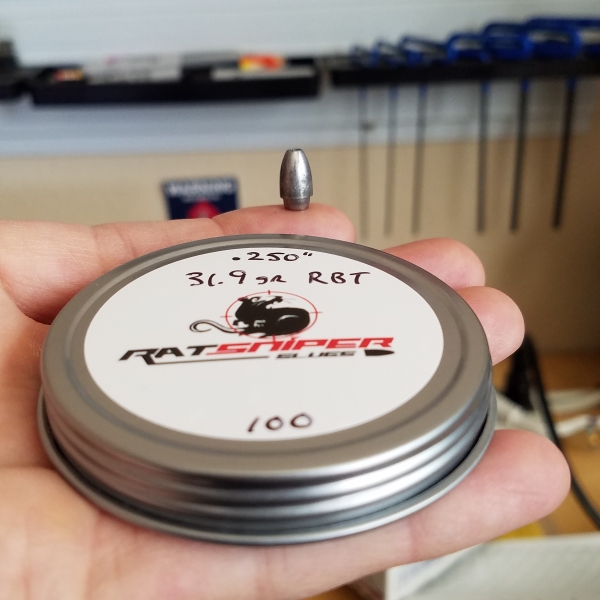

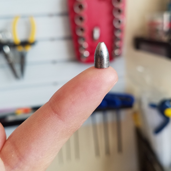

I got some great results with the 31g RatSniper RBT hollowpoints & the OEM barrel.
These are 10 shot groups at 50y in 12-19 mph winds (semi-protected range) at 900 fps & 950 fps.
I bumped it up to 980 fps but the hammer was overpowering the valve & it was out of harmony, groups opened up to 0.9". I'll have to turn up the reg to shoot them over 1000 fps or heavier slugs.
So far I'm pretty impressed with these hollow point RBT's. I imagine they would cause quite a bit of destruction at 950 fps!

That's really good for that distance and right off the hop, looking forward to seeing some gold once its tuned! I did something somewhat similar put an unchoked LW poly .22 in my Royale for slugs as well. I did the McGyver method for crown and leade (brass screw and lapping compound) seems to have worked out pretty good and both pellets and slugs are stable out to 200m. Awesome project and excellent platform to begin with!

Awesome. That’s the results we were hoping for. Hopefully you get a chance to stretch them out a bit and post similar results.
Nice groups more than enough accuracy for my "hunting" need with more power and a better BC than pellets. BTW anyone know the BC of these 31g Rat snipers?
