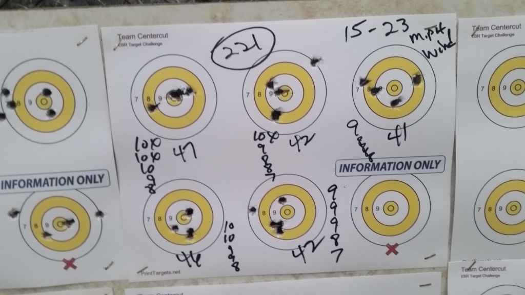

Well not pretty but ok for wind conditions, gusting and swirling New format rules .
The gun shoots better than me ! You can tell I take my time on the 1st target and hurry from there on out trying to beat the high gust . If I scored it right ?
