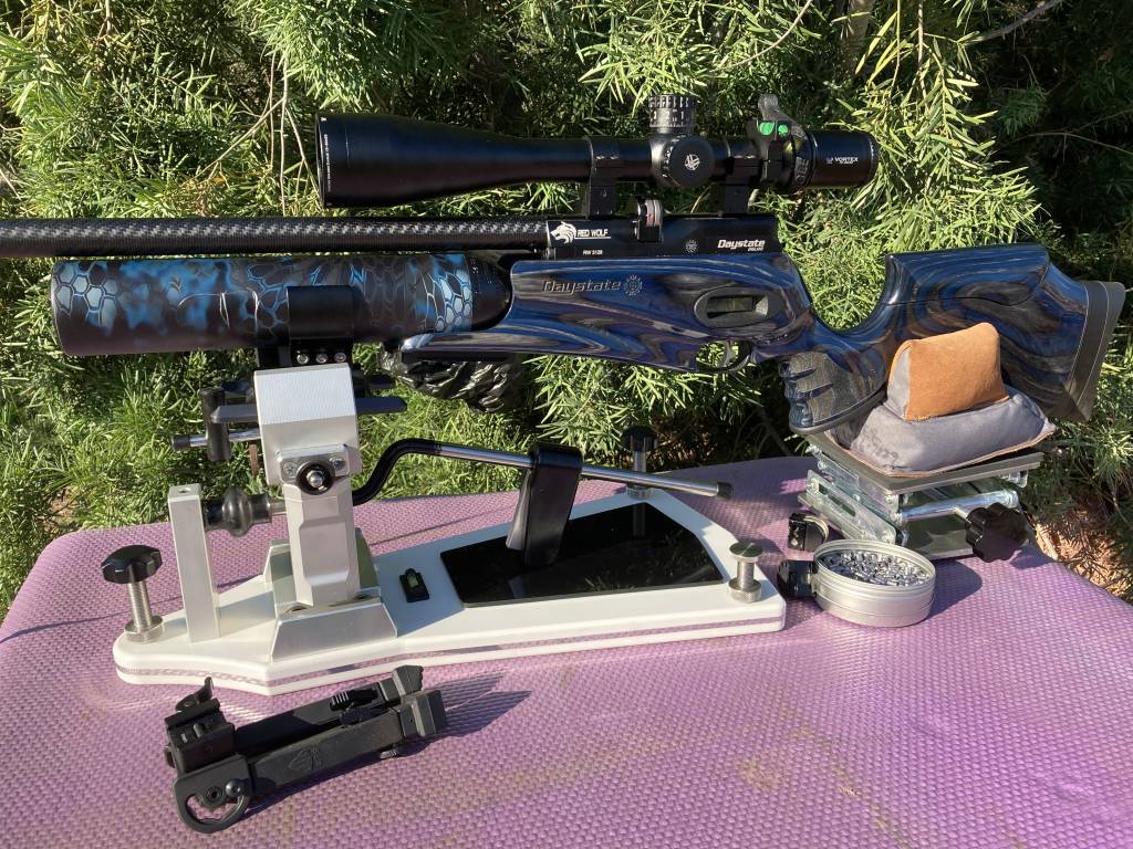

No problem Tommy. I was shooting last evening with this setup picture below. You all know I've been whining about getting a couple of "flyers" every card (25 shots). Well I never really considered that it could be the hold of the gun as @beginner discussed above. So I shot some with the normal light hold, cheek lightly on the stock, and was shooting pretty consistent elevation. Then for the heck of it, I held the gun firmly and pressed my cheek normal pressure as if I were shooting off hand, and Bleu shot low. Not just a little low, but 6 ring low. And then I did it for three more shots and they were all the same. So them I went back to my normal hold and they went back up the 10 ring elevation. I have read about "hold sensitive" but never considered it since none of my other guns are like that. The .30 Bobcat didn't care how you held it, it always shot the same. Ditto for my .22 Cricket mini and .22 Edgun R3 Long. Hmmmm. So now I'm trying to hold lightly if at all, cheek off the rest and finger on the trigger with thumb up on the rear of the grip. The rest is a used NOTA rest I recently bought, but the "Stable Table" isn't stable enough to use it free recoil like Mike N shoots. After dicking around for a while I shot the card below in light but swirling winds (got the month wrong, should be 7 not 6)... More to follow as I experiment further with this style of shooting.
