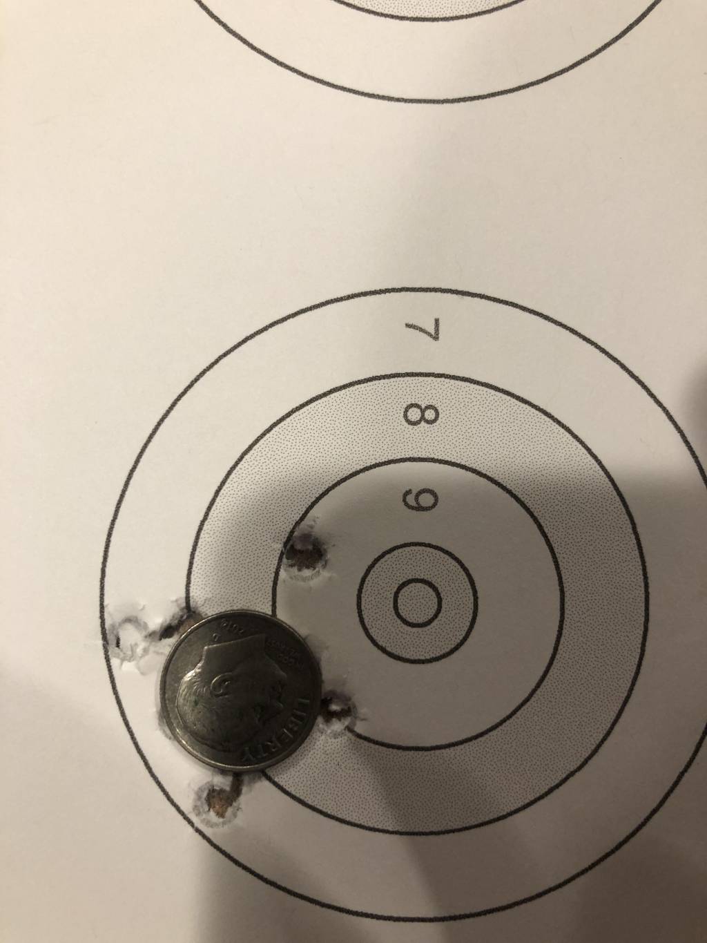

As I was bringing in my flags and stuff, the wind was calming down so I walked out and hung a card at 100. After 5 shots to find where I was, I shot a very nice 25 shot group at the same velocity. Looks like 20 of the 25 fit under a dime.

Wow, a dime is 0.705 inches. Looks to me like the ten ring on the EBR Target of 0.475, plus plugging to 0.35 giving an effective size of 0.825 just might be close to current state of the art. Only one of those 25 shots look to be outside 0.825 inches. Things that make you go hmmmm…
I’m thinking the more we shoot to prove it’s too small as it currently stands, the more we move towards actually proving its close to the correct size. Without a doubt one inch is certainly too large…

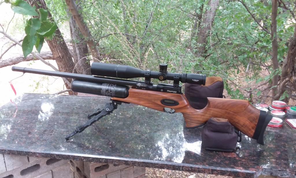

I love this rear bag (see below) to help me keep my butt/stock stabilized behind the trigger. I used to have a Caldwell rear bag, but this has made a solid difference in me trying to keep the rear stock and butt of the gun stable when shooting. I pinch the ears on the bag and adjust up/down or sideways in minute increments to move the reticle around to POA. Not sure if you considered a good quality rear bag, but it's worth a shot. I know you are used to using your hands and body to cradle the stock, but try this with a rear bag if you have not already.
If you do experiment with the RDs and can take your Bleu down to 930 FPS for a couple of groups with the RDs. I would greatly appreciate seeing your results. I'm curious to know 1/ your accuracy, 2) are they spiraling? As you know, my RAW .22 HP can only shoot at 930 FPS with the RDs, and perhaps a little bit higher but I can't get it to 970 FPS and beyond. This will be interesting to see your experiments.
Lastly, regardless if you do/don't try a good quality rear bag, I'm pretty sure you are heading in the right directions with your ideas to improve your scores. I only wish I could shoot a friggin' 220 score just once, until I get further addicted!
This is the rear bag I have and I do like it a bunch!

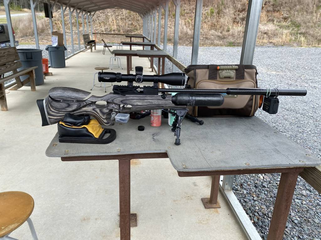

Tommyb... the rear rest looks good. Your bipod, however, is more of a hunting unit and FOR ME, not near as stable as others out there. The stability will come into play on the repeatability of the pressures applied to the rifle and the kind of bounce it generates. CC seems like he's used nice bipods from the beginning and gets good results. The first bipod I ever used was the Accutac BR-4 that I'm still using. I've tried ALL KINDS of supports but have the most pellets downrange AND the most success with this BR-4. I will be trying a more traditional benchrest front support soon to compare. Have to add a block on the bottom for proper front rest use, so that's the main holdup right now.
This is my current set up that BlueBaby used to shoot that 240 this weekend.
GET PROTECTOR TO MAKE YOU A BAG THAT RIDES AT A 75 DEGREE ANGLE ON THE STOCK,
tough to explain and it would take an hour to discuss breakaway friction, second shot high, cycling the gun in the bag before shooting, sand firmness
ear width, sticking, training your bag, bag wax , and so on
glad it seems to work but it is not close to ideal
the br stocks work for a reason

He’s surely not shooting free recoil with that setup. I assume the gun is being shouldered and the bag is just to help adjust elevation.
Mike
Bob, Mike
Yes, shooting with gun shouldered and Bob, that was an older pic with my Harris Bipod. I’m now shooting a high end Accu-Tac and it is much more solid in the front. Thanks for the input. Mike (CC) got me on the Accu-Tac. No regrets!
