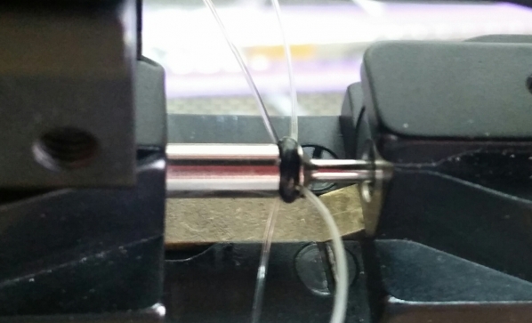

I know I didn't invent the sution. However, I searched the internet for the best solution. Then I added a slight twist make it super easy for repair newbies like me:
1. I used TWO fishing lines. (I had 25# test line on a reel)
2. I lubed the lines and probe to minimize any friction.
3. Thread the lines through the oring.
4. Push the oring onto the probe . Then align fishing lines on opposite sides of the probe/oring.
5. With a line wrapped around a finger on each hand, I use my thumb to hold the rear of the bolt while pulling both lines over the lip.
6. If it doesn't go completely over, slide the line around the oring to pull rest of the oring. Smoooooove as silk.
7. Then slide the lines out. !!!

I saw that one as well. However, it didn't work for me. Way too tight. I got a recommendation to use one line...two work much better.
