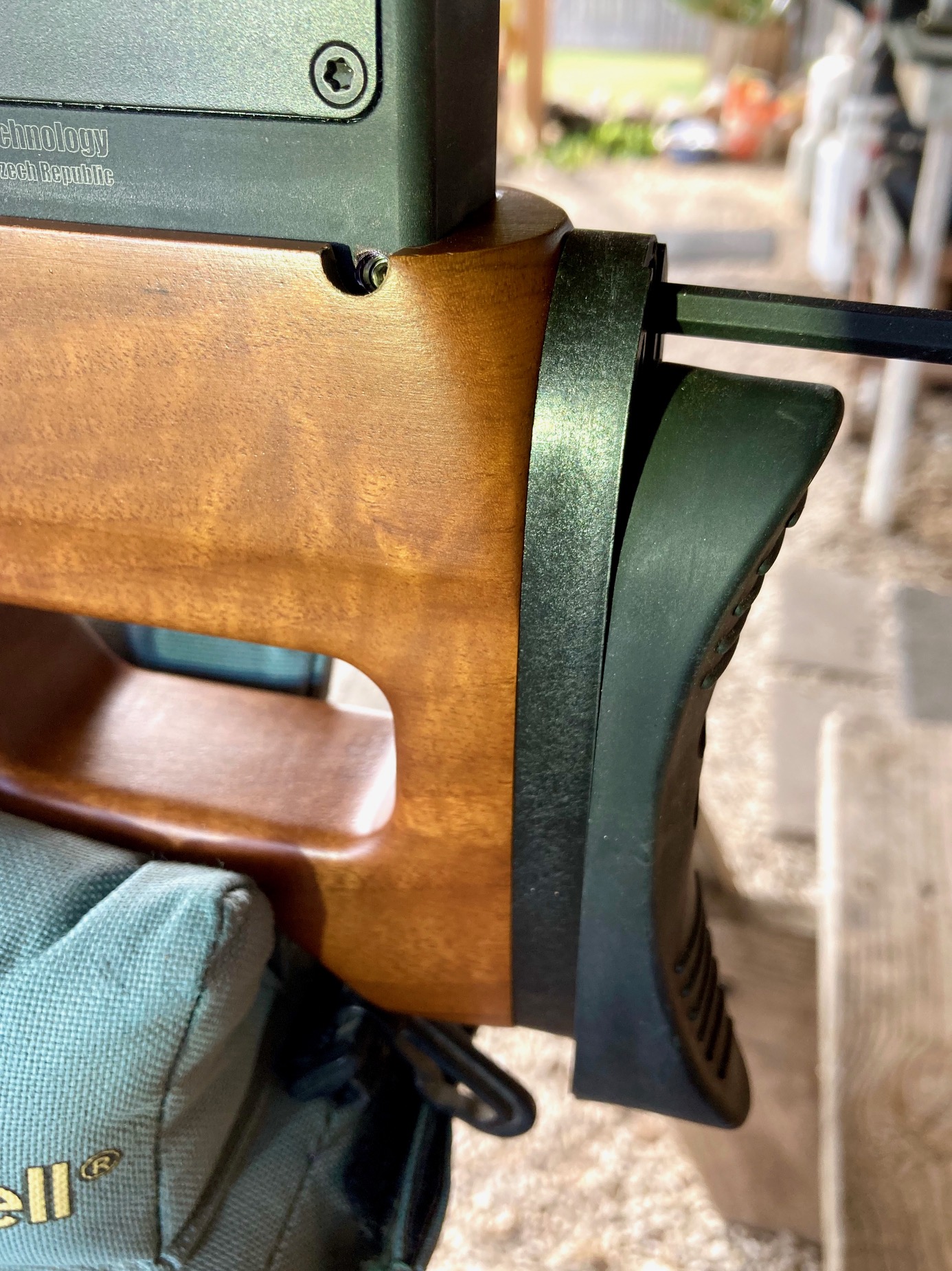

Exterior access to the 5mm hex fitting for the hammer spring adjuster is simple. With the stock removed, just lower the rubber butt pad and measure about ½” above the top Phillips head screw ( c to c). Drill a small pilot hole through the hard black plastic, into the wood and all the way through where it lines up with the spot where the hammer adjustment screw will be. Once you’re satisfied with the location of the hole, step up your drill bit size until you’re a tad larger than 5mm. The photo shows the butt pad lowered and a hex key sticking into the adjustment hole. That’s it.
The hammer spring locking screw is a little tougher to access so I gave up on the idea of leaving it on the underneath side of the HS adjuster. I drilled and tapped a new location for it on the left side of the receiver. The metal casting at that point is very thick and there’s enough meat to tap just about any size hole you want, I chose an 8-32 and used a nylon tipped Allen head screw just over ¼” long. You can see in the photo, I chose to locate it just below the stock line, that’s where I believed the metal was the thickest. To do it, I had to drill at a downward slant to hit the HS adjuster flush. It also meant I had to Dremel away part of the stock to access it. Not a big deal but some of you fellas may have a better idea.
That’s all there is to this modification. Now, to adjust my hammer spring I just loosen the locking screw on the left side, lower the butt pad and use a 5mm Allen to raise or lower the HS tension to my liking, tighten it all back up and I’m done. It’s not just for convenience though, It’s almost impossible to do a power adjustment for accuracy if the stock is off of the gun. When you do that, the rifle isn’t in the state of harmonic balance it normally would be in. The Vulcan 3 is an incredibly accurate gun and, for me, it made zeroing it in 5 to 10fps at a time a lot less time consuming. Hope you guys can get some use out of this mod!
