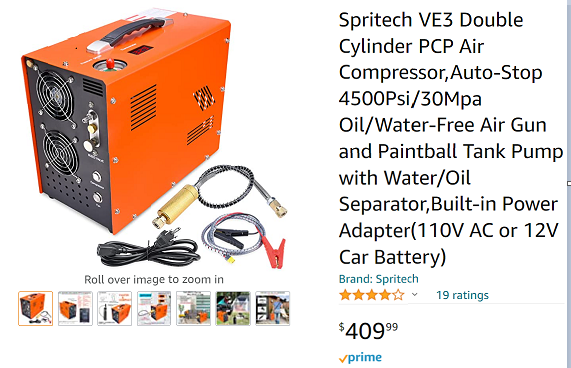

Thanks for sharing. Just saw on Amaz0n that SpriTech are now offering this VE3 Double Cylinder PCP Air Compressor for $40 more that what I paid for the back in Sep. Curios as to what this one would be like compared to the original version. Even tho longevity is questionable, I'm a huge fan of the portability and easy operation that these come with lol

...and a serious "oops" in the published description specs;
" The tested filling speed is as follows:1.5L cylinder, from 0BARS to 4500BARS takes 5 minutes "
4500 BAR!!! That could send me to the moon! Assuming they mean 4,500 PSI, that's DAMN fast compared to the one I have.
