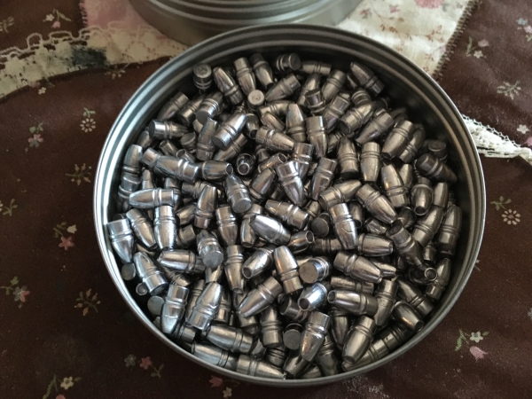

Have you had the chance to try Huben or H&N Piledriver slugs? (Just because they are a bit more affordable)
I know these liners are designed around the Nielsen slugs, but I'm hoping other slugs might work well also.

I took a quick look around, and I can't find anywhere to buy Huben or H&N slugs. Who sells them? Of course from that question, I'm sure you've figured out that I have not tried them :)
Just as we've had to be patient for slug liners, I think we're going to have to be patient for more competition in slug production as well. Hopefully demand and competition will drop the price on them. I'm also open to casting my own, but it's pretty slim pickins for molds and sizing dies for the odd .217 size we use for .22 cal.

There are people out there making swage ammo here is one that a friend
of mine has used and mentioned it did very well From the FX slug barrel .
https://www.ebay.com/itm/253282310399?ssPageName=STRK:MESELX:IT&_trksid=p3984.m1555.l2649
Sizing dies are are out there I use NOE and buy the .223 die and then
I polish them to the size I need for the Huben , there are several molds
out there that will cast a slug for the Huben I know of 3 that will do this .
Here is a look at one of them , an it's a hollow point too 36 grain .
Thanks for the info. As you mentioned, the shipping from Kral would be painful, and those ebay slugs are as expensive as Nielsen's, so I can't see any real benefit to ordering those.

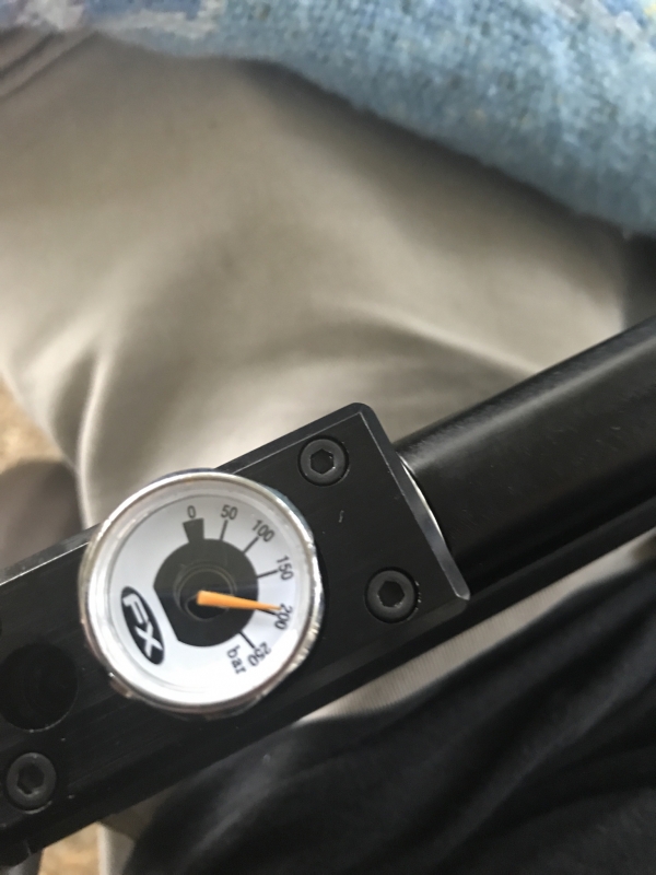

That's a fair statement. I wonder how hard we can run the new regulator in our X's. 150 bar was the understood limit for the older regulator. Matt has blown through that ceiling with the new one. Has anyone seen any statement from FX stating what the new limit is?
Thats the thing. I don't think there is much of a limit anymore. Here is my regulator setting at one point in time. The only thing that is preventing us from breaking the 100 FPE area is the hammer spring. It is not strong enough to smack the valve open to utilize the higher regulator pressure past 165 bar. And if you think about it the .25cal 44 grain slugs are the same weight as the .30 cal JSBs so you can get high energy with superior BC right? My highest FPS i've gotten is 920 with JSB 44 grains.
Anyone know where we can get stronger springs? I feel it might be necessary for some of us who want high velocity/energy high bc combo. Just becareful going past 165 bar. You can cause damage to your regulator. As far as I can tell though ES is the same for me even after hitting 195 bar in my picture.
