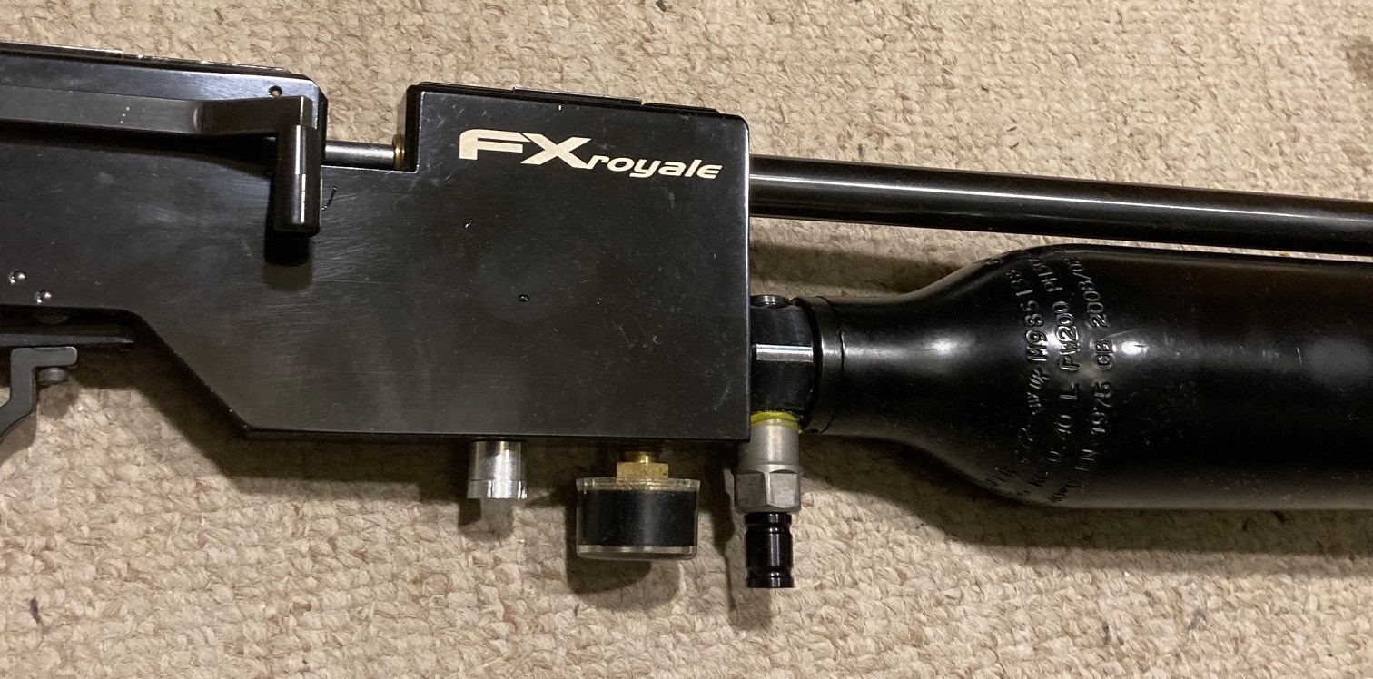

Want to see a super early Royal 400? This one has the original Lothar-Walther barrel and the “steel inserts” in top of the aluminum block (to install the optics):
