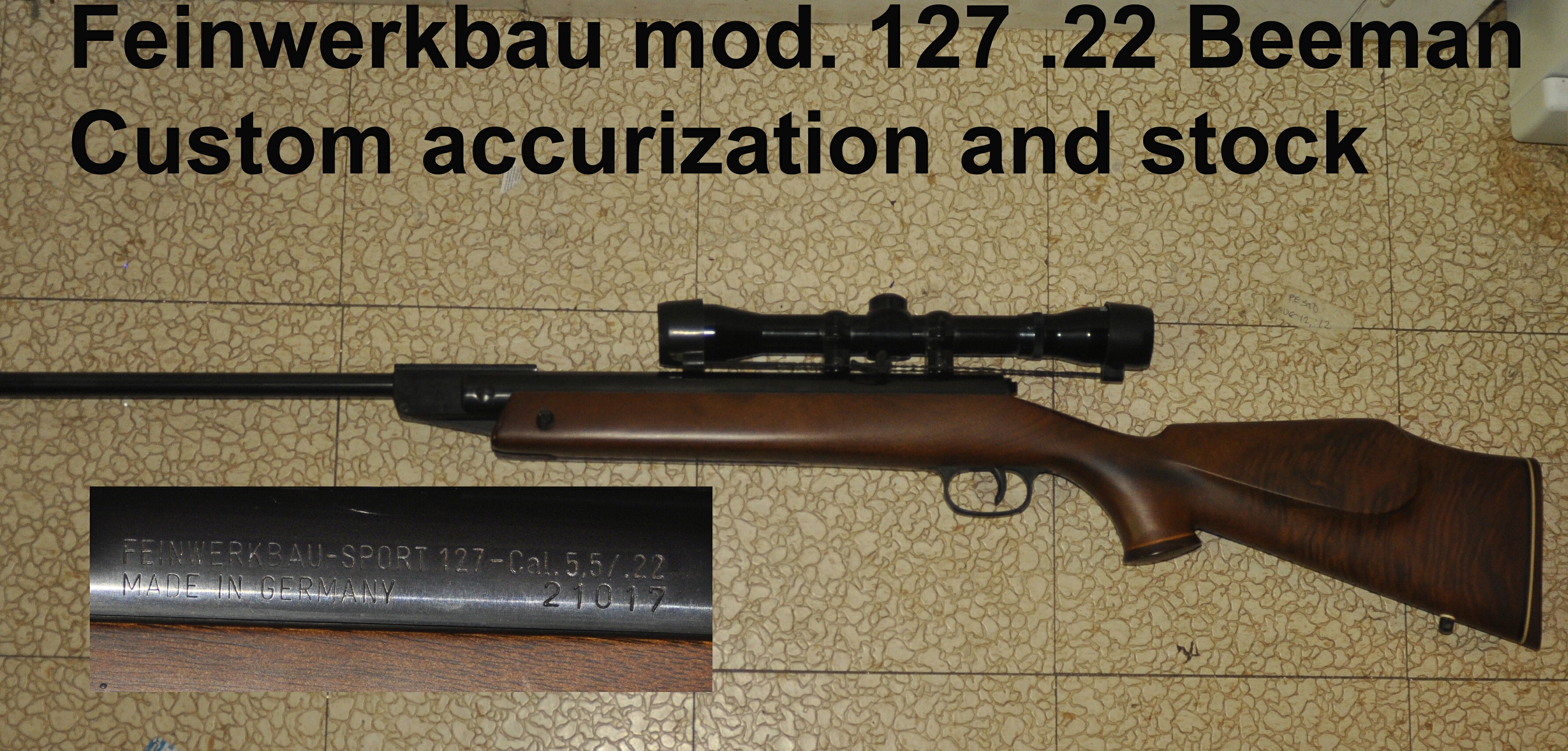

Early Fwb127 gold stamping
I don’t have this in my hands yet, it’s on its way.
It’s an early one and as you can see the lettering is done in gold. Also no “0” before the serial no.
Anyone have a clue on age and when fwb were doing the gold inlay? I’ll haven’t any photos of the other side but it looks to have the Beeman muzzle break.
It had been taken out of its stock and the trigger guard had been lost so I’m tracking to track one down.
Cheers.
Cool, the 127's are rare. I would guess that the trigger guards are interchangeable with the 124 (.177 version).
If you plan to shoot it, you will most certainly have to replace the piston and breech seals, if original.
Looks like a very low serial number, made perhaps in the mid to late 1970's? The gold lettering seems unusual. I have a 124 from the late 70's and the markings are just stamped with no ink.

Thanks you for the reply’s. I managed to find pictures of 2 other fwb sports with the gold lettering and both were early 127’s. Both were also custom jobs with walnut stocks and other modifications.
Just as you say probably custom done. As I mentioned it had no trigger guard and in fact the stock is currently zip tied to the rifle. It looks a standard deluxe stock. Maybe it once had a custom stock?
It does have an alloy trigger and a Beeman muzzle brake.
I won’t know more until I get hold of it in a couple of weeks.

I’m thinking this fwb127 may have been a personal import. Dates from 73/74. Will be interesting to see if it’s stamped Beeman on the other side.

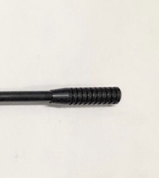

Looking at the FWB that you just purchased, l thought that the muzzle weight was on the FWB MK 3 versions. So is yours an early MK 1 with a MK3 muzzle weight?
The gold inlay is usually the work of the original seller. As previously mentioned, the Custom Shop models had them. Is yours Beeman marked? Robert Law may have done this one if not Beeman marked.
Definitely an early 70s product. I have a couple of trigger guards if you need one.
