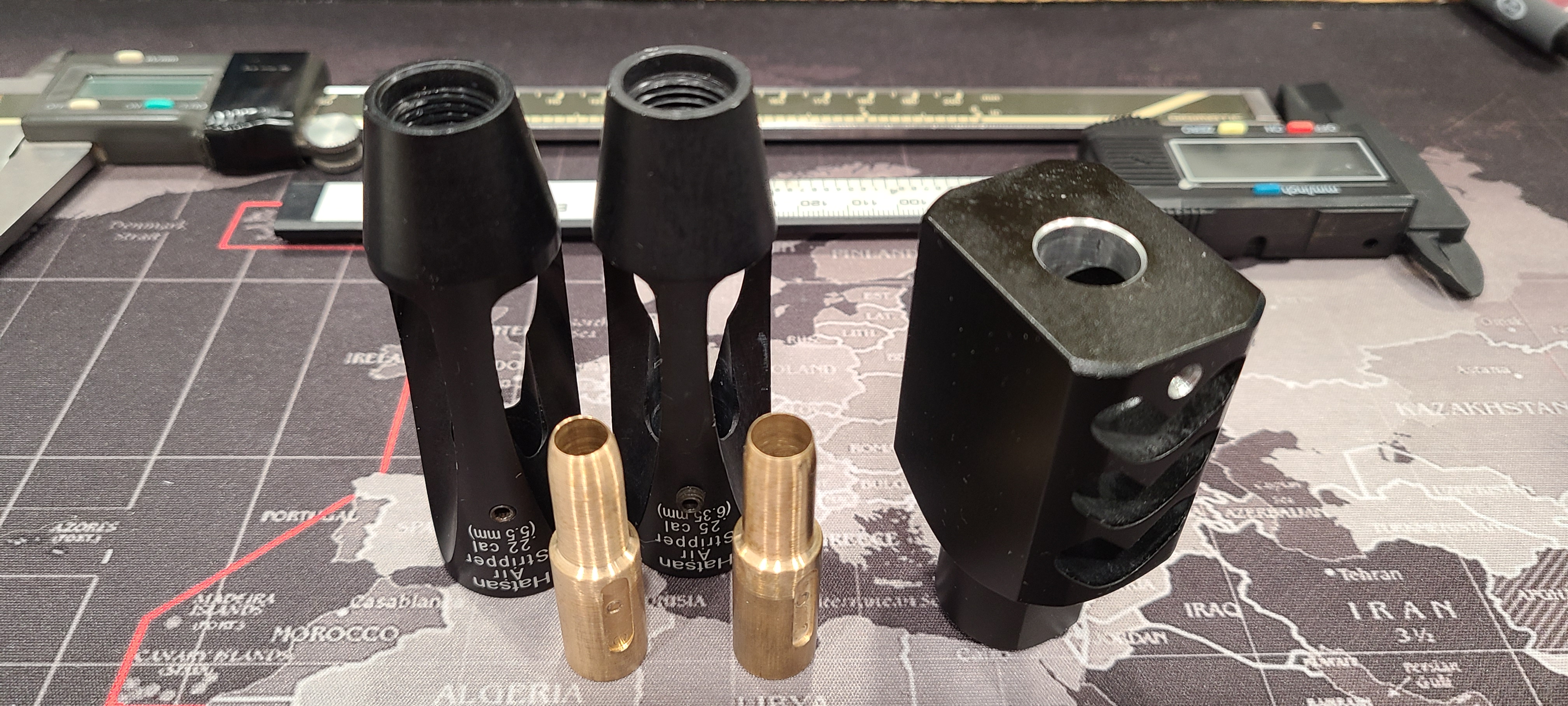

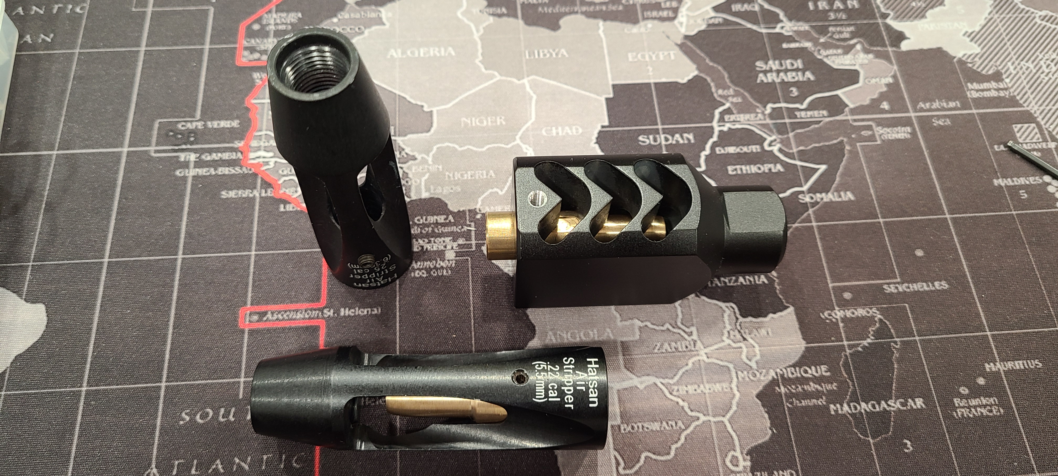

I have a muzzle break from Edgun, also a big fan of air strippers.
And here is one, a combination of both :)

You mean Hatsan stripper? :)
Yes, it is ugly and cheap - but works. I did not master it (the cone distance) because I was "searching" for a pellet on both my guns for entire year, and when I think I have found the right one the winter hit me.
I was shooting 50 Meters rings with the L2 and 100 Meters rings with MK2, I have a high x50 power scope and during tuning I could see the POI also how the pellets tear the paper.
I can confirm, definitely removes the muzzle blast. ON and OF changes the speed and changes the POI also changes the group size. I did not fix the cone distance from the muzzle because as I said I had an ongoing project, and ones mounted on MK2 and next day on Leshiy2 (with FX liner conversion) there and back, the entire summer.
I can say, yes, I like how these working, but oh man, so ugly.

I tried to find some online pictures that may shoow it from other angle but no luck. You better ask them, I suspect those doeznt have a cone, at least my edgun didn't had the cone it was just a simple muzzle break.
I modified the black piece (drill+ream+tap) to fit the brass cone. You can see from my pictures that I modified the brass cones (removed material) for airblast to have enough room to escape in the first also second opening as well.

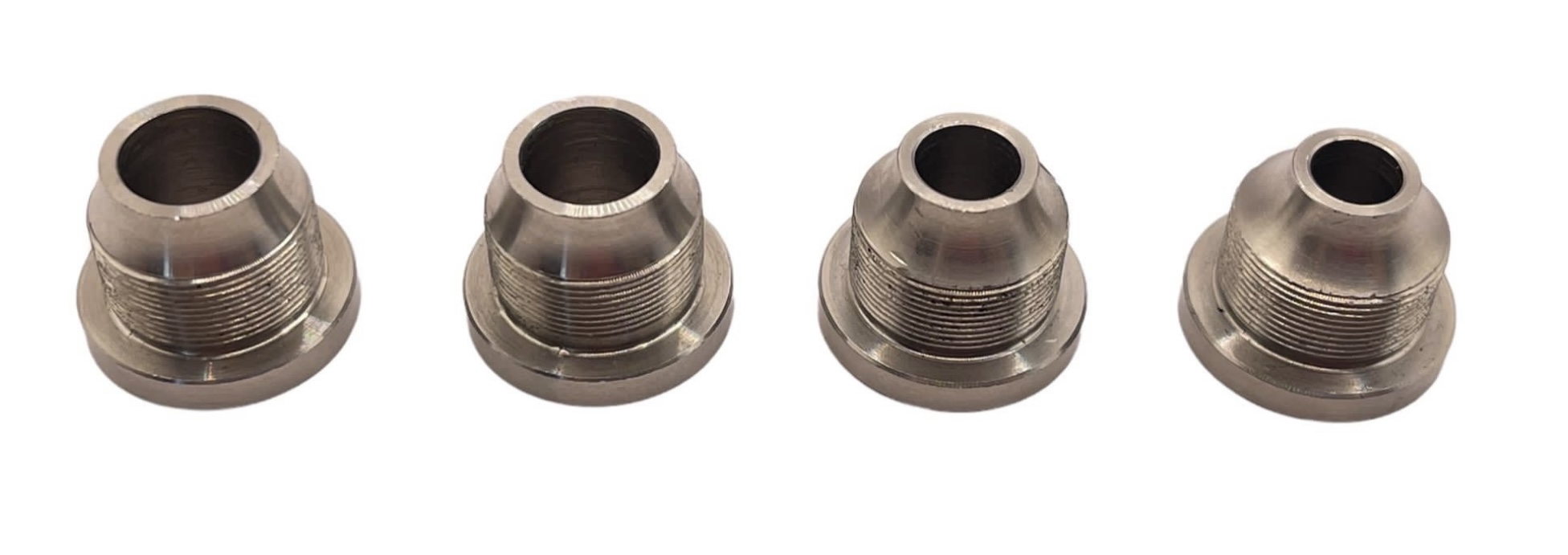

The front piece on the Eaglevision has a cone.

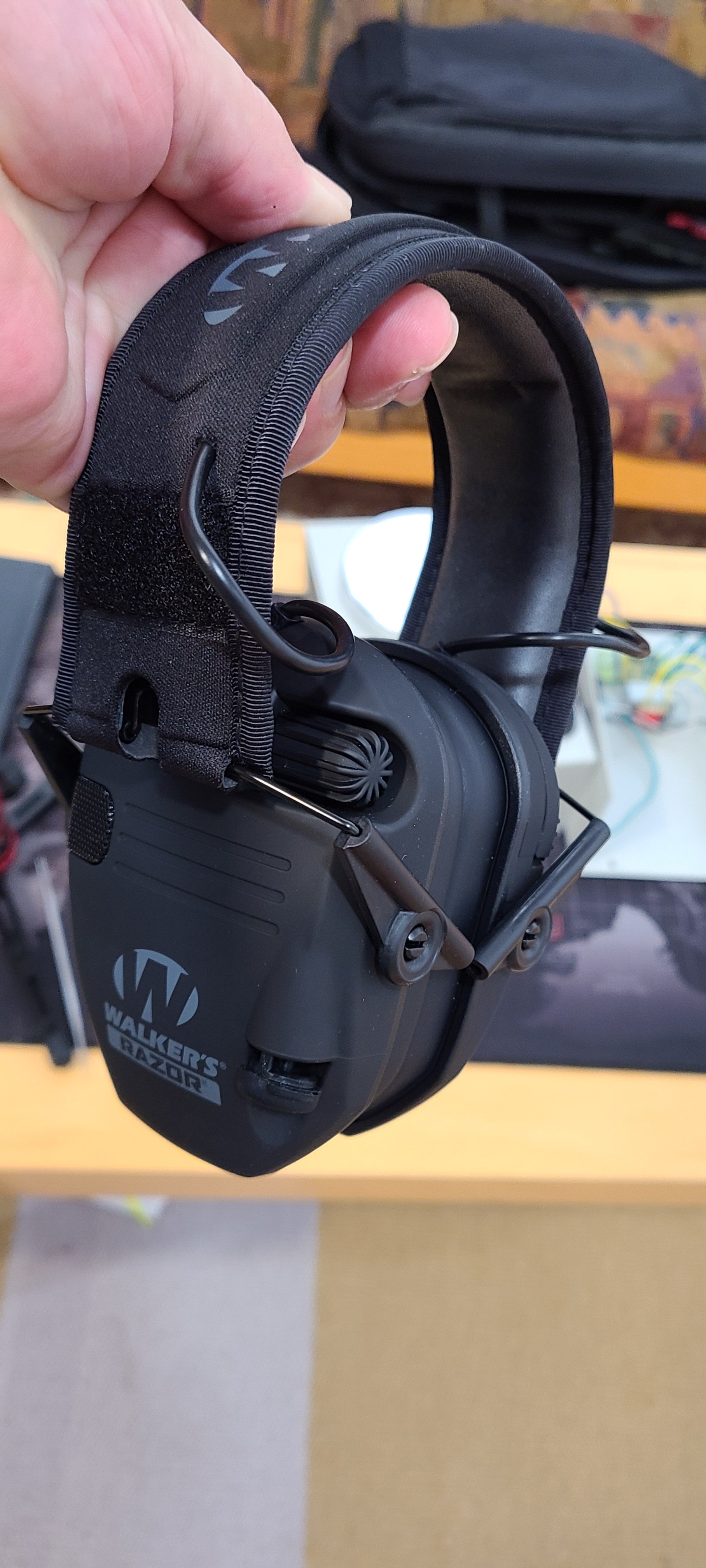

Every gun I shoot has a muzzle brake….I love ‘em, and for good reason. I was just joking about the noise. 😀
if you go to a competition where most people have no firearms experience….you will get all kinds of complaints and dirty looks. Many of todays new air gunners don’t think they should have be responsible for protecting their own hearing…they expect the other shooters to not make any noise so they don’t have to.
