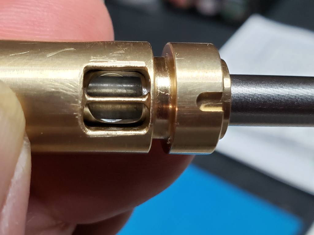

Can you post a picture of Mr. Rowe’s new transfer port?

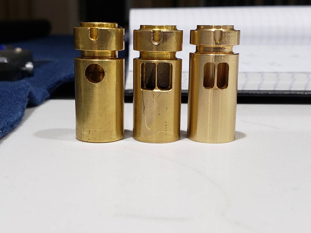

Please take into consideration the transfer hole in a rear block is 7.2 mm OD. That is a physical limit, no matter what you do with a Huma brass piece.
That one in a center is my Huma mod, and is maxed out (also enlarged the pin opening as well to the brass piece). Next thing is to take the rear block + valve housing apart and tinker there, but cannot source new parts to have spares if anything goes South.
Ok I wasn't aware of that but understand the 7.2mm limit. Not great pic hope you can see - ER looks to be maxed....
One more thing you can do to polish the center wall section into knife edge carefully or put some radius on top edges in between the pockets and that is the max we can do. Still not sure if that worth the extra maybe... 5fps?
If you need more power/speed be prepared for deeper internal surgery.

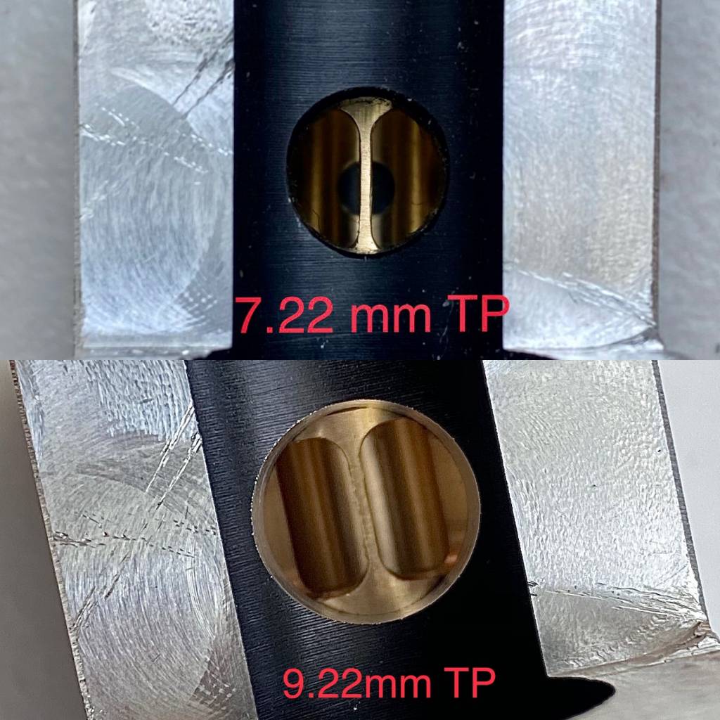

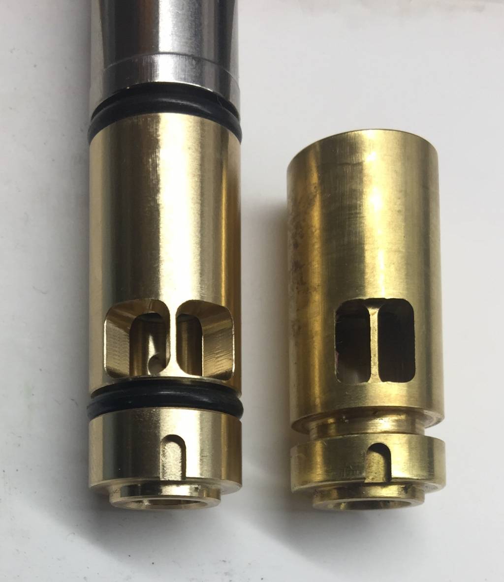

My port is mostly designed with a 10 to 9mm TP on the rear block to bore out from stock of 7.25mm TP to take vantage of nozzle opening of 11mm in my port. With 9mm TP in the rear block will gain another 25-40 fps. If not used on high power more you will loose 5-10fps due to pressure dope with the 11mm opening of my port.
if you mod my port bridge with knife edge entrance you won’t gain any FPS.
The main purpose of the dual port is the bridge that provide a smooth passage over the PT, if you look underneath the PT and push a ammo vary slowly you will see the ammo slightly dip in the TP without jamming on a stock TP size now i have seen guy elongate or enlarge the TP that results in more dipping without jamming but getting nicks and you know if you go to big the ammo will jam.
watch this video and see the ES, my Dual port was used.
https://youtu.be/jZxGVkGikHs
Cut away view rear block TP, see more flow on the side with 9.22mm port. I have a custom mill bit to enlarge the TP without enlarging the M8 set screw.
