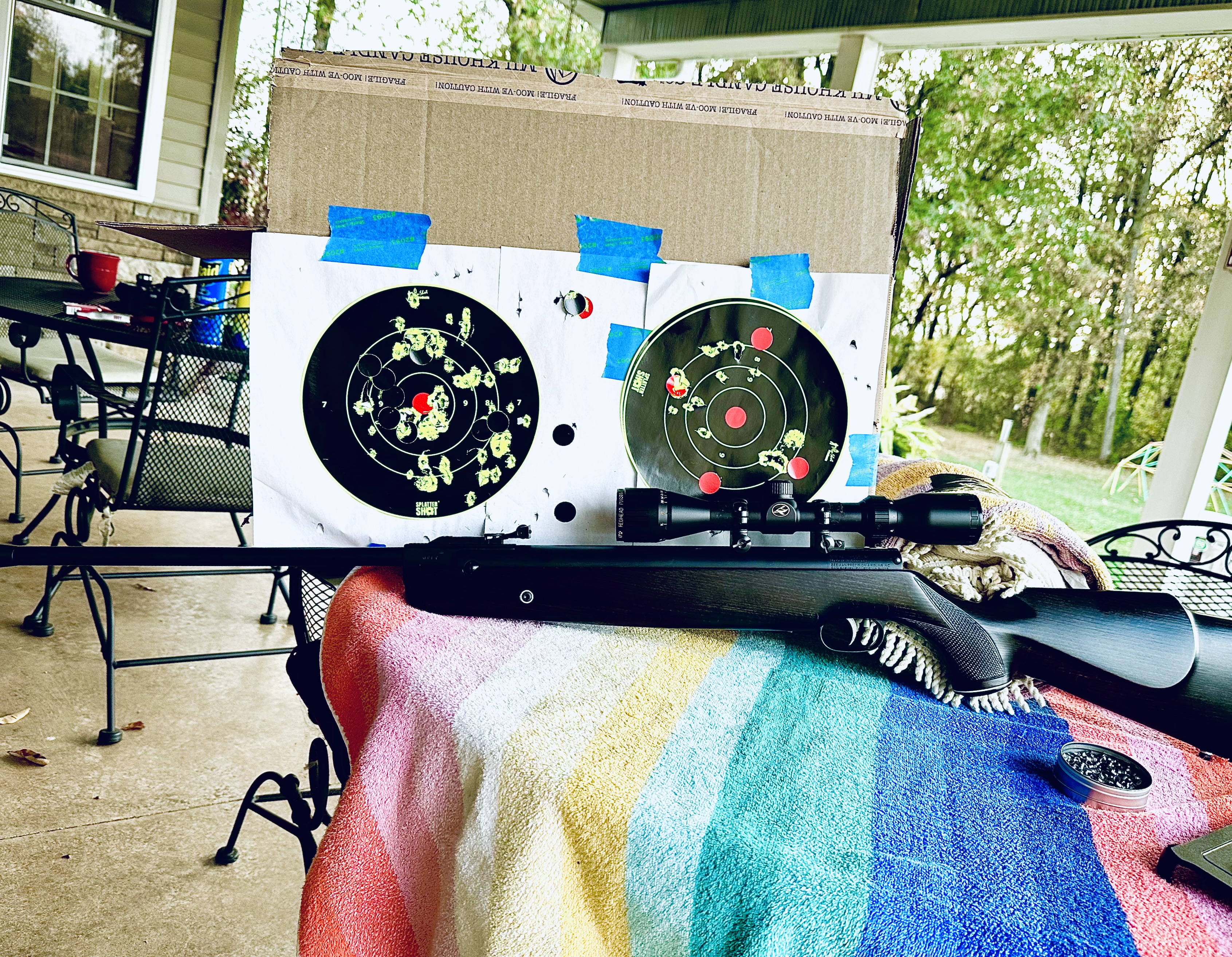

. Since you brought it up I’ll show my r1-177 that agr done for me. He went through it inside and out and it is a beautiful piece. Extremely accurate . Thanks again Chris
