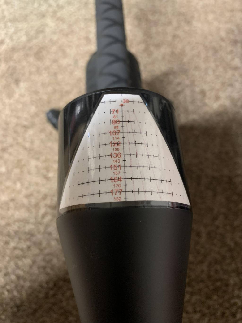

I jumped on the FFP bandwagon like it was in route to the Playboy mansion. But in my particular shooting/hunting situations, the most beneficial part of the whole FFP thing was not as helpful as I thought. With my Athlon Helos, when I’m at maximum magnification, I can only see 20mils for hold over. The other 20 are hidden until I turn the scope down. So with that particular FFP scope, 6-10x is almost useless for quick acquisition of my crosshairs and I can’t use my full tree until I come down from 24x to around 15x. Like Centercut, I realized if I have time to be looking at something on maximum magnification, I generally have time to click. I don’t worry about where there reticle is calibrated at with my SFP scopes. I can get my trajectories to jive with Strelok by playing with the magnification in the app if I have to. Then I print one of these and stick it on my scope for when I don’t feel like clicking. Eventually you kinda memorize it.
