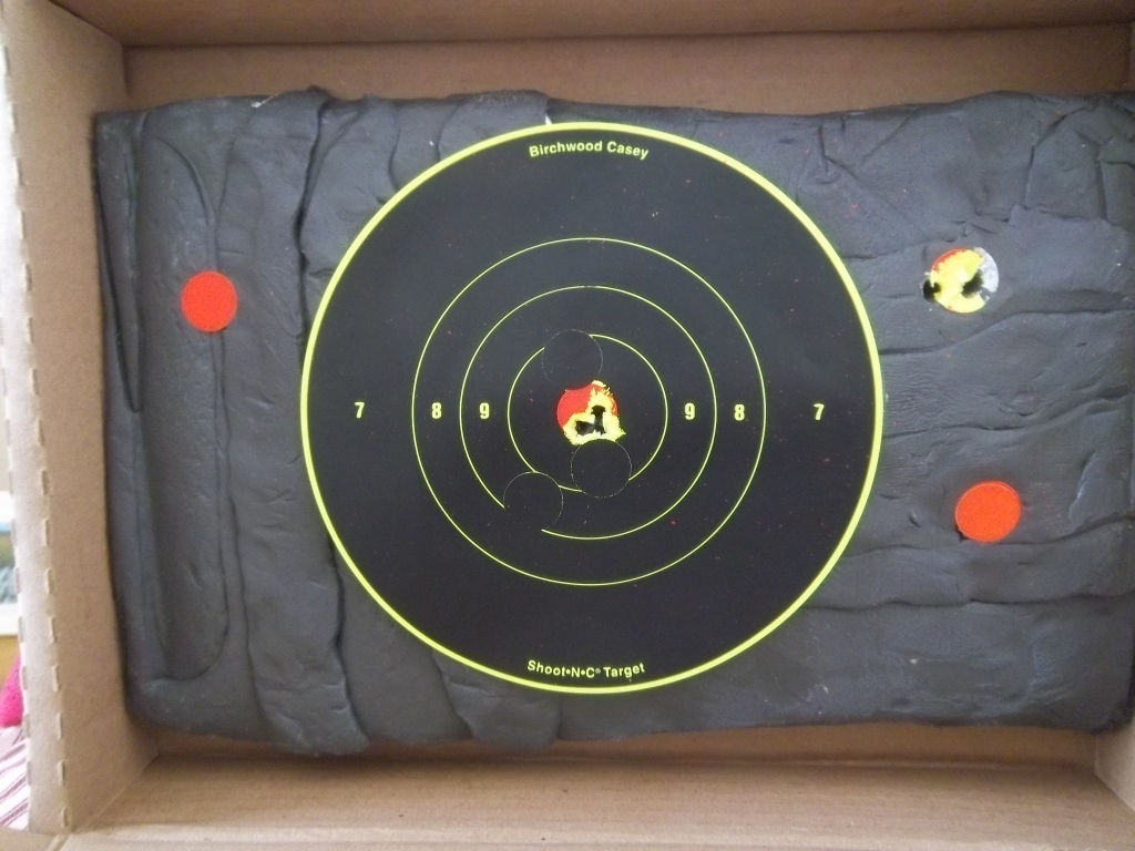

Duct seal pellet trap vs rubber mulch?

Better is kind of subjective here. Both Duct seal and rubber mulch targets are good for indoor or outdoor shooting. Both have their pluses an pitfalls as well. As you have noticed the duct seal can be difficult to clean but does not need cleaned all that often. Still it is the best as size per fpe it will absorb by far. Two inches of Duct seal will stop a hundred fpe 9mm so it is pretty stout stuff and the trap can be rather small. A few of those hundred fpe 9mm shots did split my oak trap at the rear though.
The rubber mulch will also stop powerful projectiles but it takes up allot more room. At a couple to several inches per ten fpe it's going to have to be a large trap. It also smells, well like rubber, if that does not put one off it's a great trap as well. It also needs topped off with new mulch now and then and is messy to clean when it needs it.
