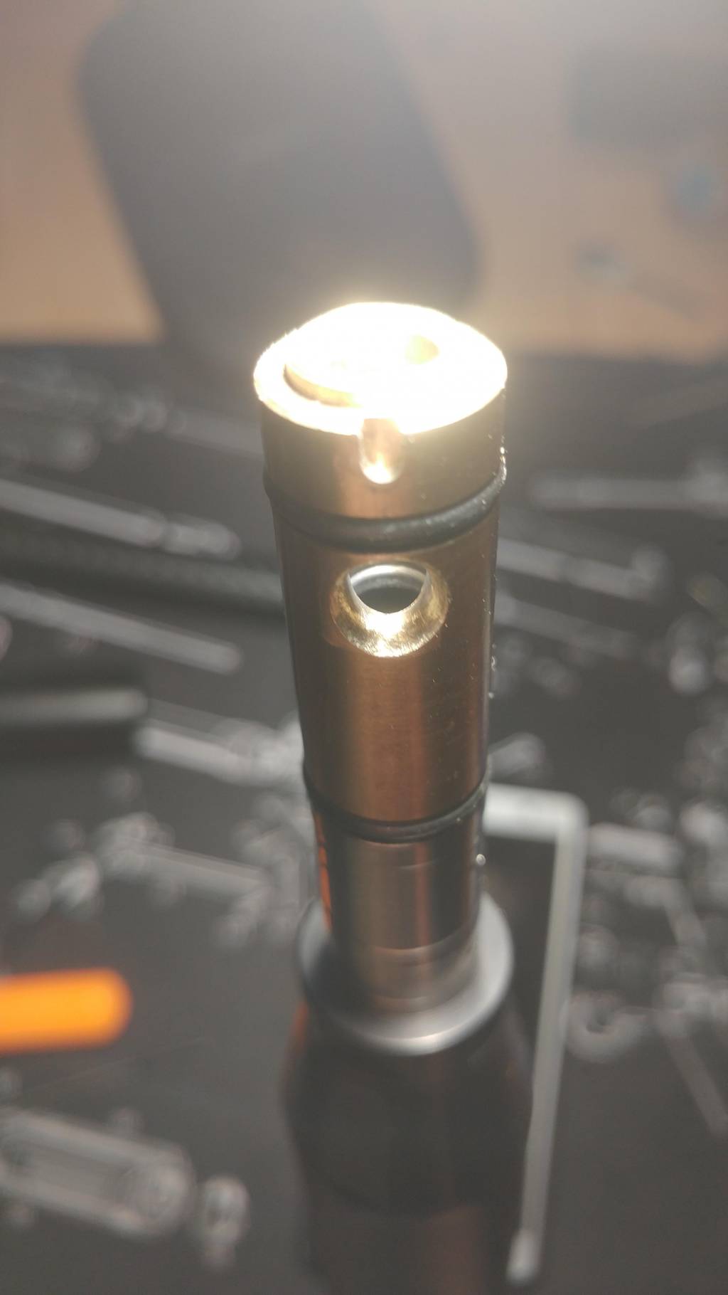

it seems, that the barrel is so short and the pellets im
using are jsb rd's...its doing all it can do at 850fps.
the oem tp produced 844fps, both tp's tested with all combinations
of external adjustments.
these were the velocities that were best consistant and accurate.
i bet i get much more that 6fps increase with my 700mm barrel
with nsa 24.8gr slugs.
with oem tp im getting 963fps
