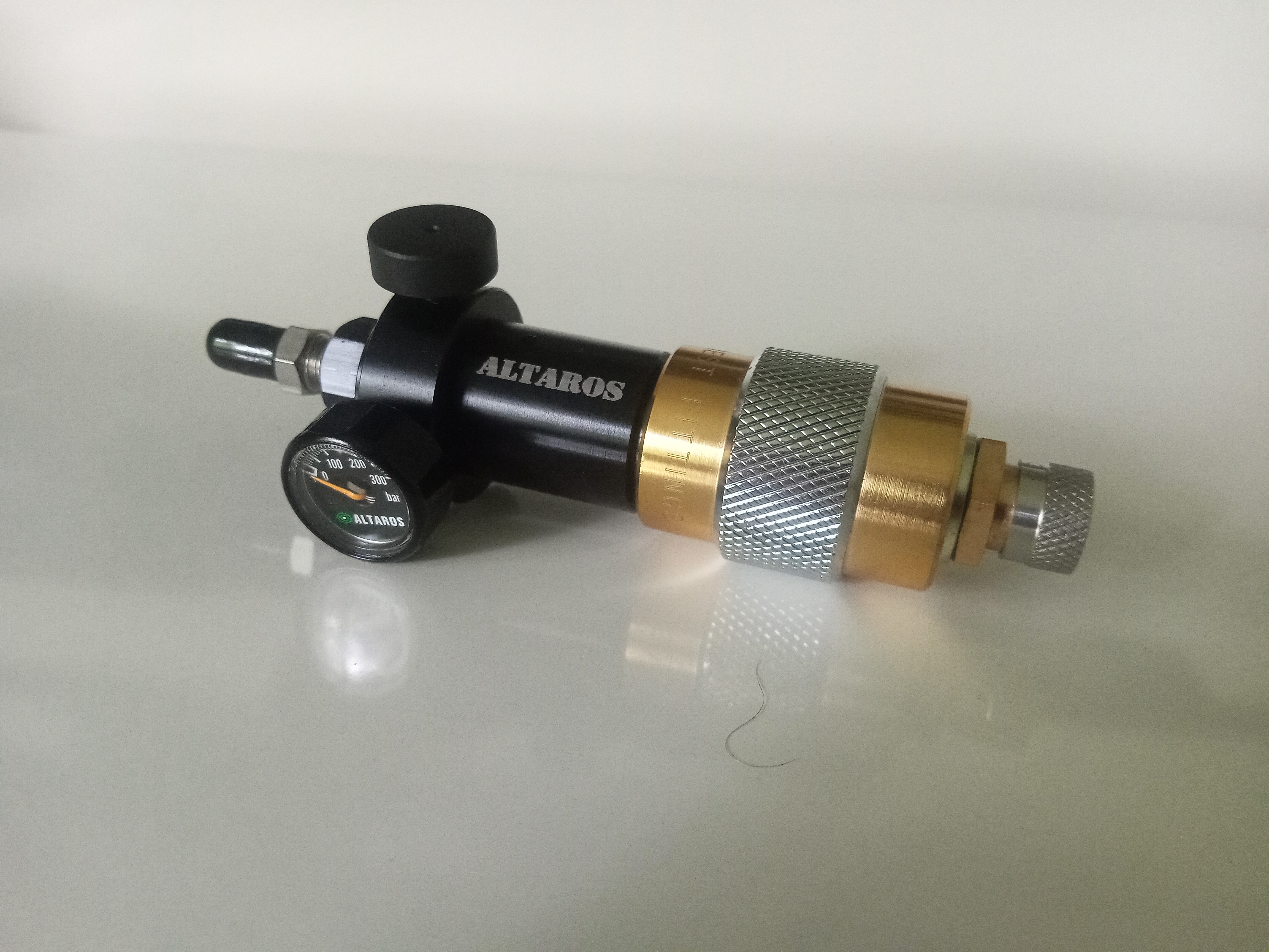

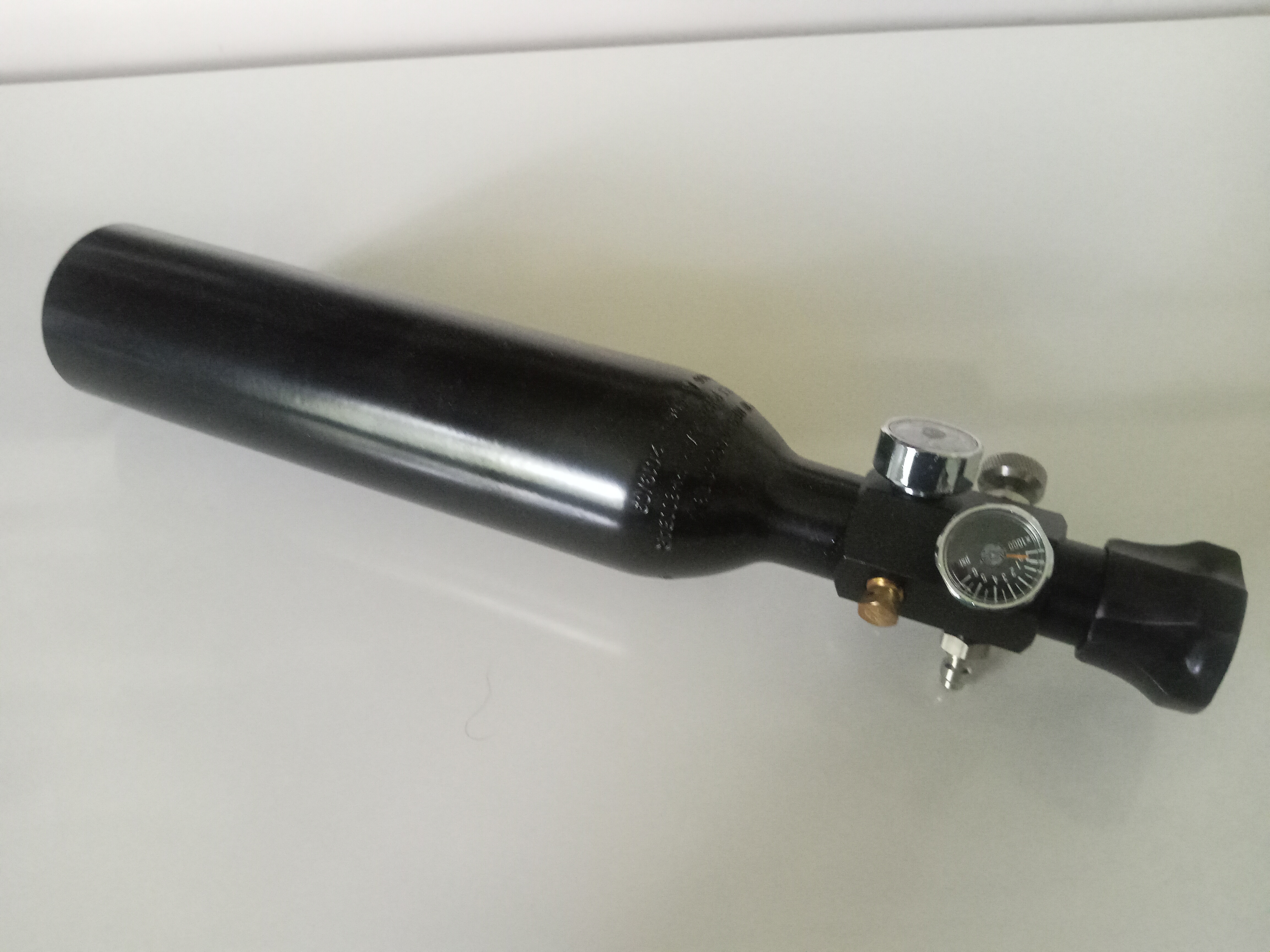

i guess depends on the design and your strategy ... my bottle has a conventional cutoff/bleed valve setup, the reg is plumbed with fosters on both ends so is removable and has its own bleeder .. i added the din adapter (the gold thingy) just to make it more durable, but it had a little flimsy end on it with a foster that it came with ..
