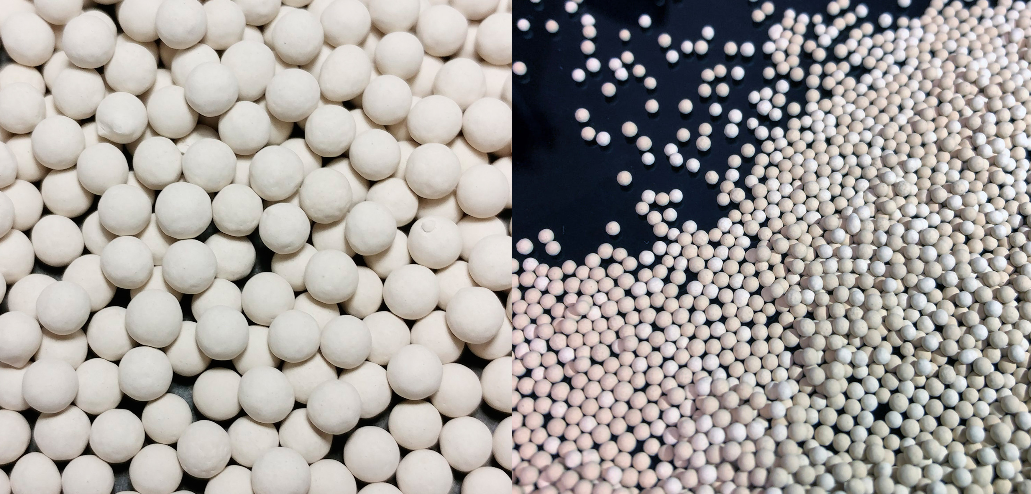

@JohanG, given the size of your drying filter, I agree with @rc4fun's recommendation of 13X molecular sieve. However I would suggest you specify that the 13X sieve in the smaller 8X12 bead size. The 4X8 bead size is twice as large so there are fewer larger beads and much more air space in your filter. The denser the beads are packed, the more effective the filtration will be in a smaller filter.

What units are these sizes? The linked Amazon item states they're 1.5-2.5mm diameter.
Edit:
Ah - a quick search seems to tell me these are mesh sizes?
https://www.sigmaaldrich.com/US/en/support/calculators-and-apps/particle-size-conversion-table shows that the Amazon item above is the more desirable smaller 8-12 mesh (1.41 - 2.38mm) size.
You got it. Smaller filters have more drying capacity using smaller 8x12 mesh size desiccant. I have an Alkin W31 and the beads are in an outer chamber while the charcoal for breathing quality air is in the inner chamber. If I substitute 4X8 beads it won't have nearly the same surface area for adsoption of moisture as it has with 8x12 mesh size beads. Most replacement clear plastic cartridges for dive compressors have a charcoal chamber with a divider and 4x8 desiccant beads. They work well in larger filters but less in a smaller one. The price is the same for both size beads so it makes sense to order the appropriate mesh size for repacking a filter. The photo below shows 13X desiccant in 4X8 mesh on the left and 8x12 mesh on the right.
